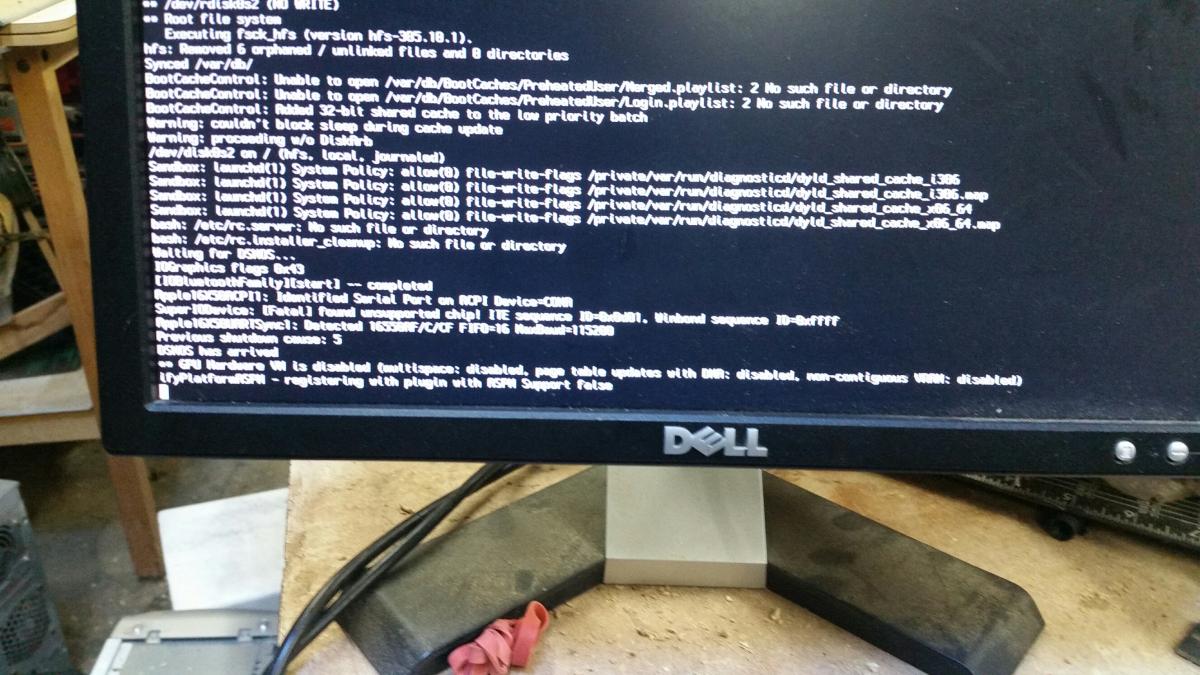

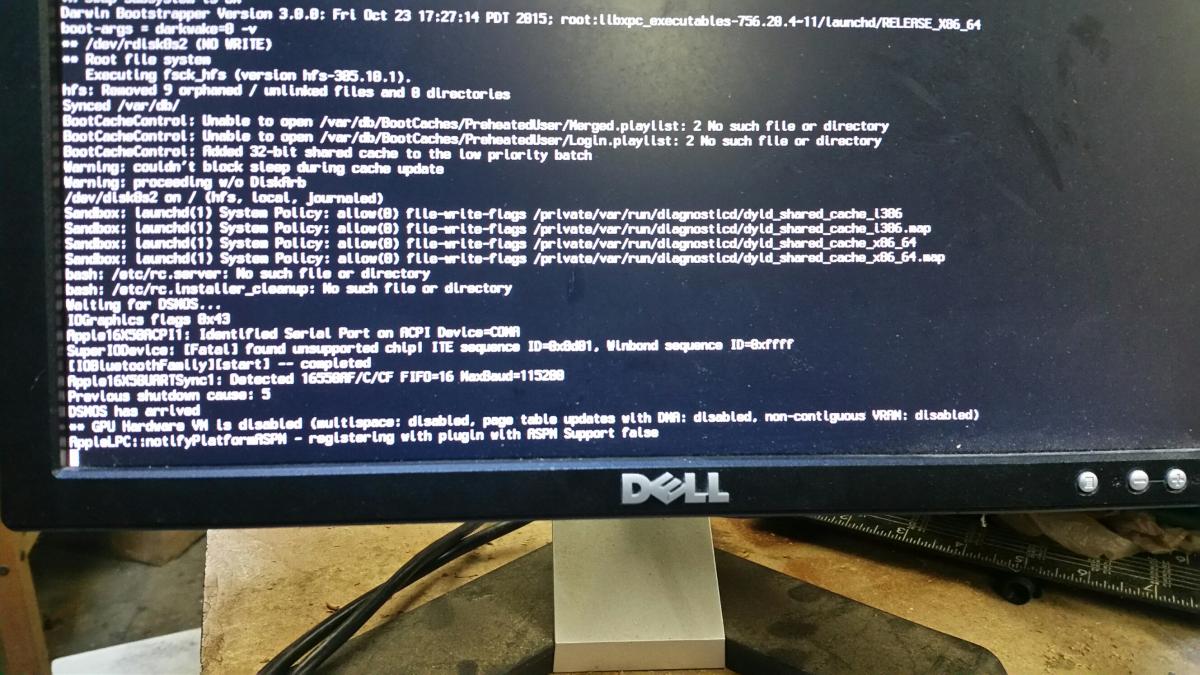

Blaggah Posted February 6, 2016 Share Posted February 6, 2016 Please boot in verbose mode (press space bar at the Clover boot menu and select Boot Mac OS X in verbose mode) so we can know where it hangs and hopefully why ! @Blaggah Do you have any third party hardware such as USB PCI extension card or whatever ? Also, could you run this in a terminal window : pmset -g assertions syslog | grep "wake reason" And post result here. [EDIT] @owbp You did it again… no, the only usb adapter I'm using is my wifi dongle. My room is all the way in the attic of the house so thats the only way i have internet which is through wifi. Last login: Fri Feb 5 18:55:48 on console Users-iMac:~ Optiplex780$ pmset -g assertions 2016-02-05 19:59:25 -0500 Assertion status system-wide: BackgroundTask 0 ApplePushServiceTask 0 UserIsActive 0 PreventUserIdleDisplaySleep 0 PreventSystemSleep 0 ExternalMedia 0 PreventUserIdleSystemSleep 0 NetworkClientActive 0 Kernel Assertions: 0x4=USB id=500 level=255 0x4=USB mod=12/31/69, 7:00 PM description=com.apple.usb.externaldevice.fa200000 owner=Wireless N USB Adapter Idle sleep preventers: IODisplayWrangler Users-iMac:~ Optiplex780$ Link to comment https://www.insanelymac.com/forum/topic/308097-guide-el-capitan-1011x-dell-optiplex-780-760-755-790-990/page/22/#findComment-2213620 Share on other sites More sharing options...
bclinton Posted February 6, 2016 Share Posted February 6, 2016 Which graphics card are you using on this optiplex? This one from Amazon http://www.amazon.com/gp/product/B007B5YUMQ?psc=1&redirect=true&ref_=oh_aui_detailpage_o09_s00 Link to comment https://www.insanelymac.com/forum/topic/308097-guide-el-capitan-1011x-dell-optiplex-780-760-755-790-990/page/22/#findComment-2213622 Share on other sites More sharing options...
Blaggah Posted February 6, 2016 Share Posted February 6, 2016 I'm using the exact same card. If you're using the same card, make sure that ATI is checked under Graphics Injection clover options. Link to comment https://www.insanelymac.com/forum/topic/308097-guide-el-capitan-1011x-dell-optiplex-780-760-755-790-990/page/22/#findComment-2213623 Share on other sites More sharing options...
bclinton Posted February 6, 2016 Share Posted February 6, 2016 I'm using the exact same card. If you're using the same card, make sure that ATI is checked under Graphics Injection clover options. Ok, I noticed that my BIOS is at A09. That looks to be well out of date. I am going to update it and try one more time. If it bombs I will post the verbose info. Thanks a million for helping me... Link to comment https://www.insanelymac.com/forum/topic/308097-guide-el-capitan-1011x-dell-optiplex-780-760-755-790-990/page/22/#findComment-2213627 Share on other sites More sharing options...

polyzargone Posted February 6, 2016 Share Posted February 6, 2016 Uncheck InjectATI. Link to comment https://www.insanelymac.com/forum/topic/308097-guide-el-capitan-1011x-dell-optiplex-780-760-755-790-990/page/22/#findComment-2213808 Share on other sites More sharing options...

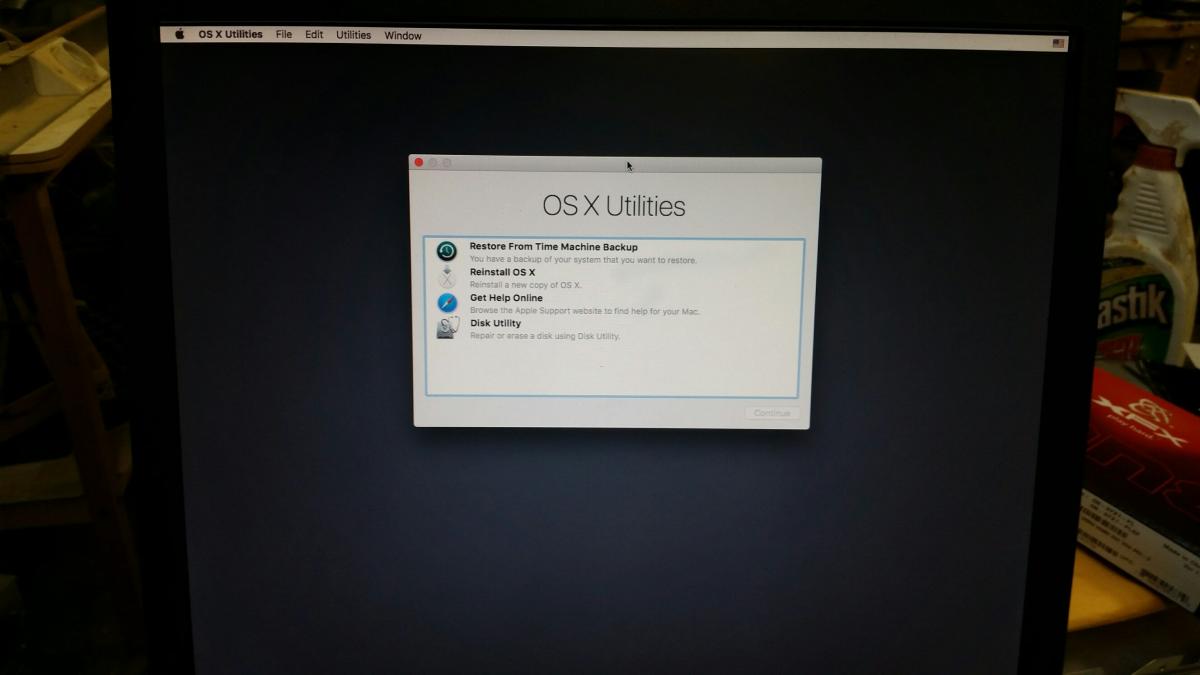

bclinton Posted February 6, 2016 Share Posted February 6, 2016 Uncheck InjectATI. That got me to this point. Not too sure what happened as I wasnt watching it. Link to comment https://www.insanelymac.com/forum/topic/308097-guide-el-capitan-1011x-dell-optiplex-780-760-755-790-990/page/22/#findComment-2213854 Share on other sites More sharing options...
polyzargone Posted February 6, 2016 Share Posted February 6, 2016 At least you reached that screen ! Well, seems like it's the Recovery HD partition. Obviously, you've chosen the wrong partition to boot or you messed up at some point. Be sure to boot the correct OS X partition or re-partitioned the whole target disk and try again. Link to comment https://www.insanelymac.com/forum/topic/308097-guide-el-capitan-1011x-dell-optiplex-780-760-755-790-990/page/22/#findComment-2213861 Share on other sites More sharing options...

bclinton Posted February 7, 2016 Share Posted February 7, 2016 At least you reached that screen ! Well, seems like it's the Recovery HD partition. Obviously, you've chosen the wrong partition to boot or you messed up at some point. Be sure to boot the correct OS X partition or re-partitioned the whole target disk and try again. I went ahead and wiped everything and started over. It continues to hang. This is with the ATI injector disabled...sorry for all the trouble. Looks like I am destined to not have a hackintosh Link to comment https://www.insanelymac.com/forum/topic/308097-guide-el-capitan-1011x-dell-optiplex-780-760-755-790-990/page/22/#findComment-2213975 Share on other sites More sharing options...
polyzargone Posted February 7, 2016 Share Posted February 7, 2016 Try the attached config.plist and make sure you have DSDT.aml from AMD Radeon HD 5450 folder inside EFI/CLOVER/ACPI/patched config.plist.zip Link to comment https://www.insanelymac.com/forum/topic/308097-guide-el-capitan-1011x-dell-optiplex-780-760-755-790-990/page/22/#findComment-2214113 Share on other sites More sharing options...

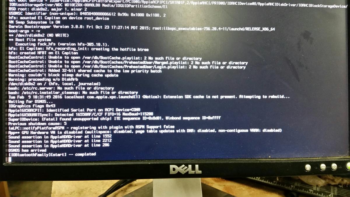

bclinton Posted February 10, 2016 Share Posted February 10, 2016 Try the attached config.plist and make sure you have DSDT.aml from AMD Radeon HD 5450 folder inside EFI/CLOVER/ACPI/patched Here is the screen shot of where it stopped. I replaced the config.plist file and confirmed that my setup settings matched. Link to comment https://www.insanelymac.com/forum/topic/308097-guide-el-capitan-1011x-dell-optiplex-780-760-755-790-990/page/22/#findComment-2214567 Share on other sites More sharing options...
polyzargone Posted February 10, 2016 Share Posted February 10, 2016 Do you have a Windows install or a Linux LiveCD/USB to check you Radeon HD 5450 vendor/device ID ? Meanwhile, you may try the Generic DSDT which doesn't have any injection for this model. There's one or two example here with people having a HD 5450 where the vendor/device ID doesn't match the expected ones and are actually those from another serie that works OOB. Link to comment https://www.insanelymac.com/forum/topic/308097-guide-el-capitan-1011x-dell-optiplex-780-760-755-790-990/page/22/#findComment-2214568 Share on other sites More sharing options...
