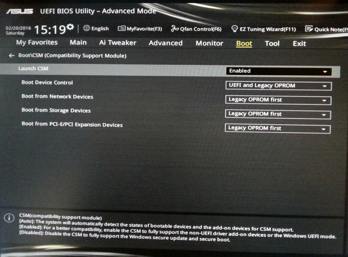

Monq Posted February 20, 2016 Share Posted February 20, 2016 Those values leave me without video output. Very unfortunate, as I was getting excited. In my case, I can choose the iGPU to be my primary output and there's no difference regarding wake. If I enable the CSM, I never get any video output at all. This is what my CSM options look like by the way, there's no reference to "video" whatsoever. Link to comment https://www.insanelymac.com/forum/topic/308025-no-graphics-usb-audio-after-wake/page/19/#findComment-2216820 Share on other sites More sharing options...

Monq Posted February 20, 2016 Share Posted February 20, 2016 I edited the post, but I mean the screen never turns on at all, not even for POST. Link to comment https://www.insanelymac.com/forum/topic/308025-no-graphics-usb-audio-after-wake/page/19/#findComment-2216832 Share on other sites More sharing options...
Mieze Posted February 20, 2016 Share Posted February 20, 2016 I edited the post, but I mean the screen never turns on at all, not even for POST. This is normal because you have to perform a blind boot in this configuration. The screen connected to the Radeon card won't show a picture until it's driver has been initialized which is something that doesn't happen in the early stages of the boot sequence. Mieze Link to comment https://www.insanelymac.com/forum/topic/308025-no-graphics-usb-audio-after-wake/page/19/#findComment-2216839 Share on other sites More sharing options...
