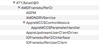

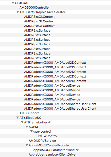

Cyberdevs Posted February 11, 2016 Share Posted February 11, 2016 I have been cross examining the ioreg data from different apple computers and my own build and this is what I have found so far, AGPM (AppleGraphicsPowerManagement) seems to be not working properly and gpu-control is not working either which I assume is the cause for the graphic adapter not to wake up from sleep or send the wake signal from gnu to the displays. As you can see AGPM is not loading anything. It should have load the gpu-control and IOHWControl but it doesn't. Link to comment https://www.insanelymac.com/forum/topic/308025-no-graphics-usb-audio-after-wake/page/18/#findComment-2214958 Share on other sites More sharing options...
Joni_78 Posted February 11, 2016 Share Posted February 11, 2016 I have been cross examining the ioreg data from different apple computers and my own build and this is what I have found so far, AGPM (AppleGraphicsPowerManagement) seems to be not working properly and gpu-control is not working either which I assume is the cause for the graphic adapter not to wake up from sleep or send the wake signal from gnu to the displays. As you can see AGPM is not loading anything. It should have load the gnu-control and IOHWControl but it doesn't. Could I have that ioreg from the original iMac 12,2? Here's from my laptop incase you are interested, Radeon 7570M, IGPU is disabled by manufacturer. MacBook Pro.zip Link to comment https://www.insanelymac.com/forum/topic/308025-no-graphics-usb-audio-after-wake/page/18/#findComment-2214974 Share on other sites More sharing options...
