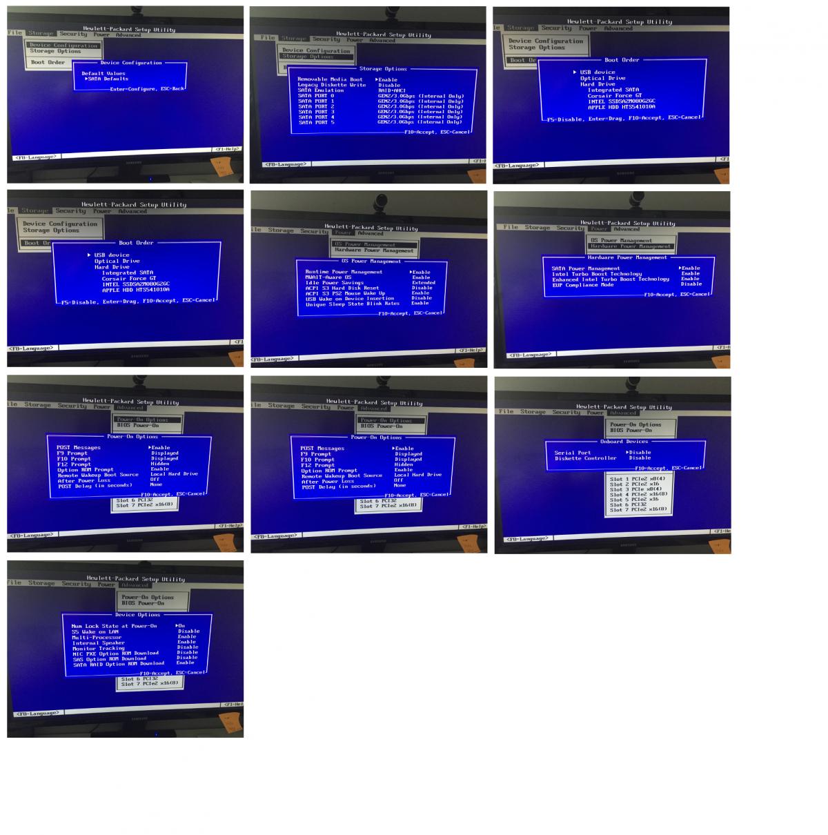

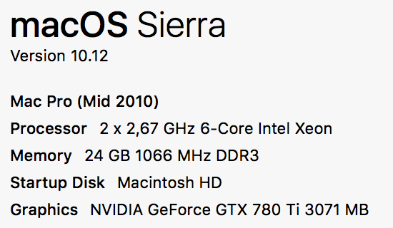

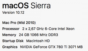

HW Specification :
HP Z800  with BIOS version : 3.60
CPU: x2 6-core X5650 @ 2.67 GHz
RAM: 24 GB
GFX:  EVGA GeForce GTX 780 Ti, 3GB, 3072MB,GDDR5 384bit
Sonnos Tempo SSD ACHI Controller
SSD: Samsung SSD 840 EVO 500GB & 256 GB  Corsair Force GT
Monitor: Samsung 4K, 3840 x 2160 Resolution (UHD)

-        Reboot without the USB and all should be working except for the wrong amount of RAM
-        Start Clover configurator and first go to "BOOT"  and uncheck “nv_disable=1” and “-v” next go to "SMBIOS" and manually add the memory setup of your RAM by adding each slot and memory HW spec.
-        Reboot and now all should be working…
