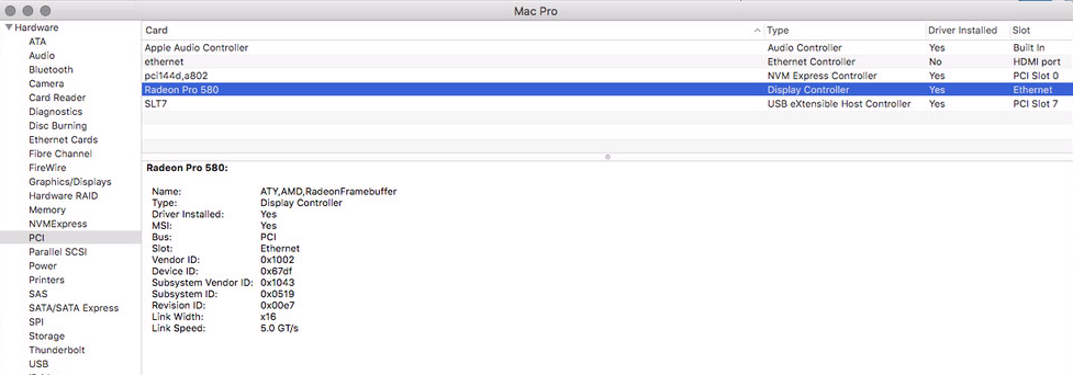

robertr Posted February 1, 2018 Share Posted February 1, 2018 I have a Z800 motherboard (BIOS 3.60) with a single Xeon X5690 and 48 GB RAM (another X5690 + 48 GB RAM will be installed as soon as I get the mounting kit. I crammed it into a Fractal Design Define XL 2 case.ACPI seems like a mess? I would GREATLY appreciate some help in fixing this, I have very little knowledge as my last hack was basically install-and-go. PCIe2 slot0: x4, Samsung 950 PRO nvme boot drive. (EFI/Clover is on a USB stick since the Z800 won't load the ahci option rom from the nvme drive) -working fine. PCIe2 slot1: x16, ASUS ROG STRIX RX 580 TOP https://www.asus.com...AMING/overview/ -booting to black screen, bios and verbose boot is OK.PCIe1 slot2: x4, emptyPCIe2 slot3: x8, emptyPCIe2 slot4: x16, Intel 520 DA1 10Gb card (I need to change Subsystem ID for drivers to load) -seems to be working, showing as Ethernet controller at HDMI-port (??)PCI32 slot5: emptyPCIe2 slot6: x8, USB 3 card based on FL1100 -working fine Link to comment https://www.insanelymac.com/forum/topic/307064-hp-z400z600z800-workstations-os-x-1010x1011x-installation/page/36/#findComment-2581898 Share on other sites More sharing options...
