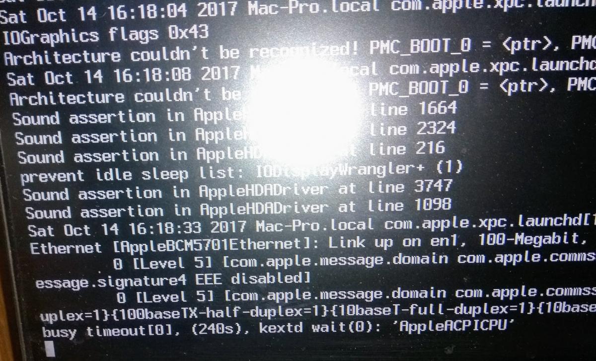

After so many time spent, Sierra does not install on my machine.
I have a Z800, latest bios, dual Xenon X5680 (24 cores total), 96gb ram, Nvidia GTX 1060 6GB G1, Dual display, RAID 5 for windows 10 and an separated 500GB HD for Sierra.
I use corei3cpu instructions, and various others variations, but the far I got was this screen on Clover boot.
At this point, any help will be surely appreciated.
For Sierra or even HighSierra.
Sorry if I am missing some basic fact, but I was off the Hackintosh community for a -very- long time.

Doesn`t work.
Same error, and same slow speed to boot.

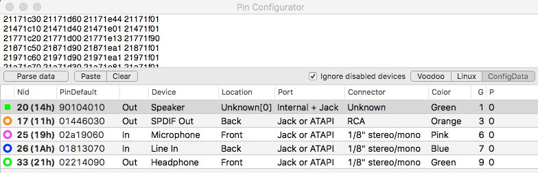

Need some help to the get sound
Audio codec .    Realtek ALC663   Desktop Version
try this:
I have configured:
Speaker (LineOut back) and HP (front) in switch mode
Mic front
Line in back
SPDIF orange
LayoutID 11 (0B)
with DSDT: 0B in DSDT / HDEF
without DSDT: inject 11 in config and FixHDA
