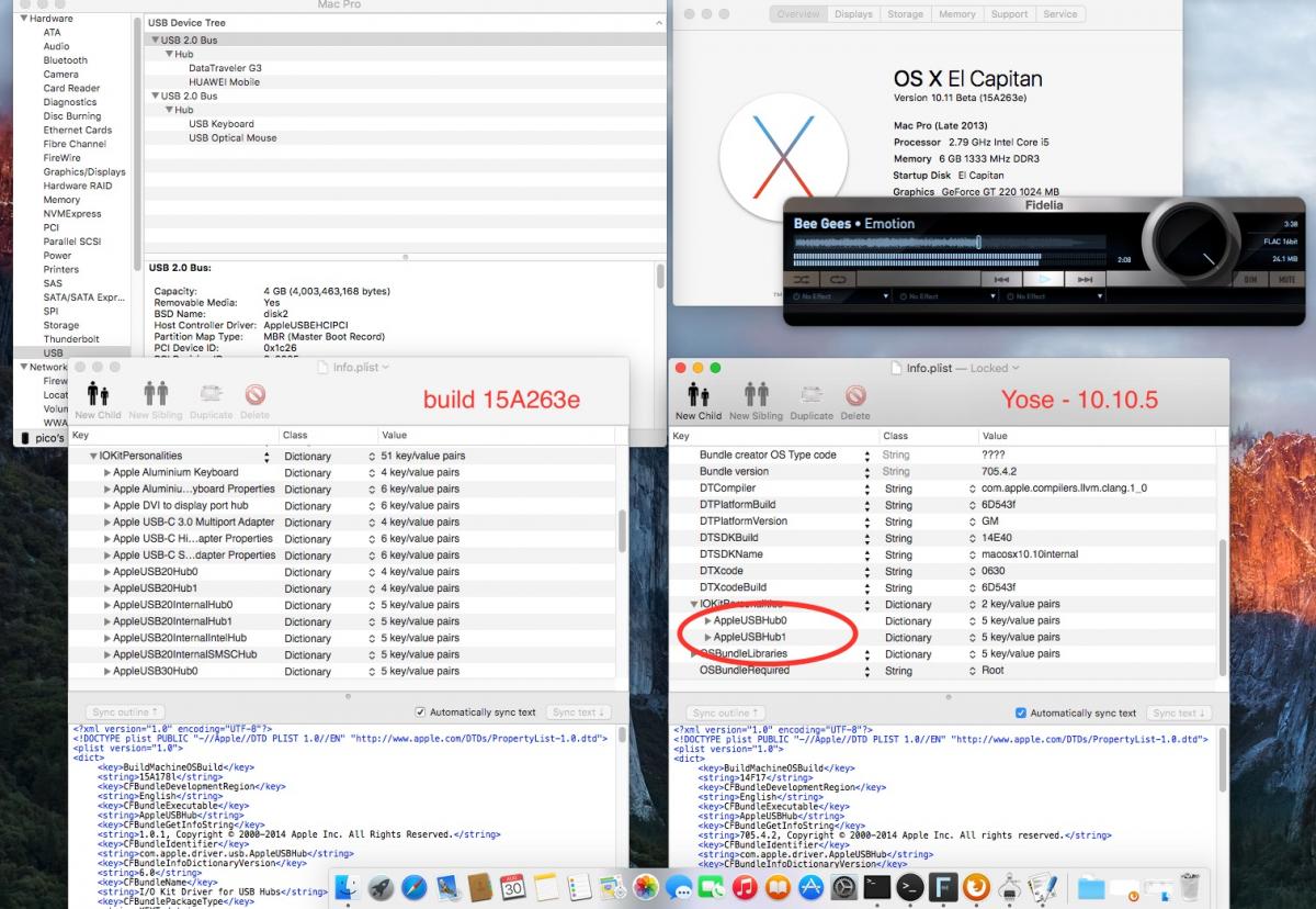

pico joe Posted September 1, 2015 Share Posted September 1, 2015 Guys .. I found different method to fix usb in el capitan at my mobo, after compare AppleUSBHub.kext between 10.10.5 and 10.11 build 15A263e (now 15A279b) .. delete another key in AppleUSBHub.kext and leave AppleUSB20Hub0 & AppleUSB20Hub1, dont know the effect but my usb port work again (MacPro 6.1). hopefully can be supplement for pokenguyen research 1 Link to comment https://www.insanelymac.com/forum/topic/306777-guide-usb-fix-el-capitan-1011/page/11/#findComment-2164904 Share on other sites More sharing options...
RehabMan Posted September 1, 2015 Share Posted September 1, 2015 .. delete another key in AppleUSBHub.kext and leave AppleUSB20Hub0 & AppleUSB20Hub1, dont know the effect but my usb port work again (MacPro 6.1). No need to edit the kext. I wrote about building a port injector for hubs earlier in this thread. 2 Link to comment https://www.insanelymac.com/forum/topic/306777-guide-usb-fix-el-capitan-1011/page/11/#findComment-2164924 Share on other sites More sharing options...
pico joe Posted September 2, 2015 Share Posted September 2, 2015 @RehabMan is this what you mean http://www.insanelymac.com/forum/topic/306777-guide-usb-fix-el-capitan-1011/page-3?do=findComment&comment=2148322, how about if I dual boot with Yosemite, thanks Link to comment https://www.insanelymac.com/forum/topic/306777-guide-usb-fix-el-capitan-1011/page/11/#findComment-2165039 Share on other sites More sharing options...
RehabMan Posted September 2, 2015 Share Posted September 2, 2015 @RehabMan is this what you mean http://www.insanelymac.com/forum/topic/306777-guide-usb-fix-el-capitan-1011/page-3?do=findComment&comment=2148322, how about if I dual boot with Yosemite, thanks Kexts installed to 10.11 volume have no effect on 10.10 volume. EHCx->EH0x rename seems to have no effect on Yosemite USB drivers. Link to comment https://www.insanelymac.com/forum/topic/306777-guide-usb-fix-el-capitan-1011/page/11/#findComment-2165062 Share on other sites More sharing options...

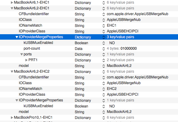

D-an-W Posted September 6, 2015 Share Posted September 6, 2015 As I don't use a DSDT at the moment, is there any way to achieve full functionality of USB 2/3 either another way or with a DSDT that contains just the required alterations? EDIT: I renamed XHC1 to XHC in the Info.plist of AppleUSBXHCIPCI.kext (Macmini6,2-XHC1) as thats what it seemed like my USB 3.0 was named as and it seems to have worked! Before: After: Link to comment https://www.insanelymac.com/forum/topic/306777-guide-usb-fix-el-capitan-1011/page/11/#findComment-2165871 Share on other sites More sharing options...
Mrengles Posted September 6, 2015 Share Posted September 6, 2015 @D-an-W Post your stock DSDT and I'll talke a look and patch if it's not over my head. Link to comment https://www.insanelymac.com/forum/topic/306777-guide-usb-fix-el-capitan-1011/page/11/#findComment-2165923 Share on other sites More sharing options...
TheRacerMaster Posted September 6, 2015 Share Posted September 6, 2015 @D-an-W, see here: https://github.com/theracermaster/Gigabyte-GA-Z77X-DSDT-Patch I renamed EHC1/EHC2 to EH01/EH02 and XHC to XH01 (not really needed, just cosmetic) and the port restrictions don't apply. Link to comment https://www.insanelymac.com/forum/topic/306777-guide-usb-fix-el-capitan-1011/page/11/#findComment-2165952 Share on other sites More sharing options...

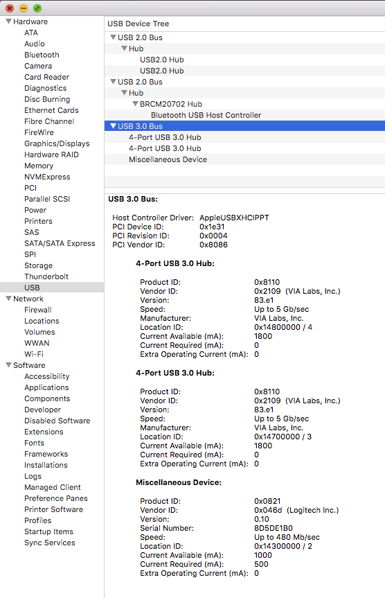

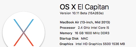

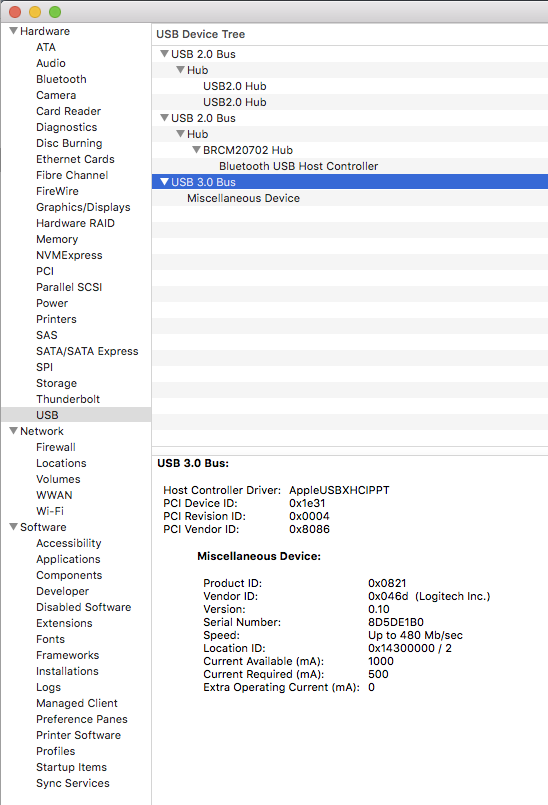

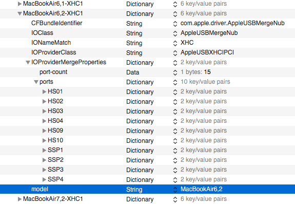

Rytz Posted September 7, 2015 Share Posted September 7, 2015 Hi:I'm working on my Acer Aspire E5-771-74E7 (MacBookAir6,2) under Beta 8. Currently, all ports are working and responding to devices correctly but USB3 connections are showing up on the USB2 hub. The USB3 bus is showing in System Info but doesn't have a hub like USB2. My solution to getting the ports working under USB2 seems different from what I've seen from previous posts. My IORegEx doesn't seem to reflect my DSDT very accurately. There are 2xUSB2 and 2xUSB3. > To get all 4 ports working (all under/as USB2), all I have to do is add a PRT1 entry with LocationID = 0x01 under EHC1(see screenshot). > EHC1 doesn't even show up with any PRT# listings in IORegEx. Just PR12 (not sure what that is). > EHC2 exists in my DSDT but doesn't show up in IORegEx. I tried adding to the AppleUSBEHCIPCI kext plist but no change. > I tried adding all non-restricted ports for XHC (as shown in IORegEx) to the AppleUSBXHCIPCI plist. USB3 port connections still showing on USB2 hub. > I have tried actual USB3 devices in the USB3 ports but they still show under the USB2 hub and at USB2 transfer speeds. I've attached some screens, plists, and ioregs without entries (no restrictions) and with (working USB2). Any help appreciated. Thanks. rytz_usb_ioreg_dsdt_kext.zip Link to comment https://www.insanelymac.com/forum/topic/306777-guide-usb-fix-el-capitan-1011/page/11/#findComment-2166035 Share on other sites More sharing options...

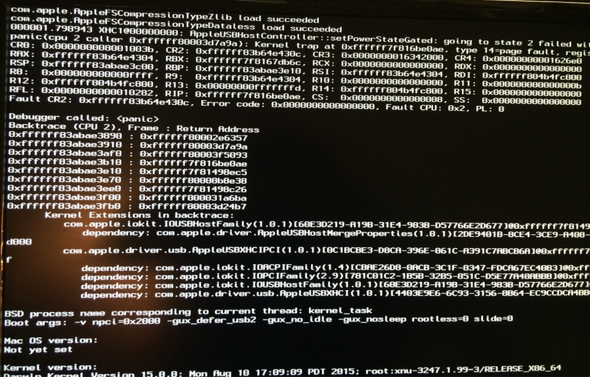

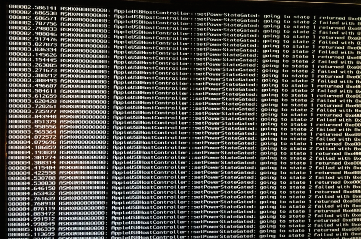

oSxFr33k Posted September 7, 2015 Share Posted September 7, 2015 I am getting a kernel panic when I try to install El Capitan from USB flash drive. I finally managed to install it but had to install off another Sata drive and tried many times, maybe 25 to 30 attempts, to get past the kernel panic. The USB flash drive was flooded with messages and could never get to the installer screen so I had to install El Captian from a Sata drive partitioned with the installer on it. I still am getting kernel panics during boot and it takes many tries to finally get to Desktop but when I do, I still get the same flooded messages during the boot and after the boot. I have disabled the ASMedia USB 3 in Bios but that does not seem to help much. Tried the Dummy kext and Rehab's Port Injector and I still get the kernel panic. I also tried to boot after removing AppleUSBEHCI, AppleUSBEHCIPCI, AppleUSBXHCI and AppleUSBXHCIPCI from the IOUSBHostFamily kext but still get the kernel panic or the flooded power-state messages if I get past the kernel panic. I have the Asus X79-Deluxe with Intel E2-2697 v2 running 10.10.5 flawlessly with the GenericUsbXHCI.kext. I do not have a DSDT not needed, only SSDT. Clover config, SSDTs and DSDT and IOReg from 10.10.5 attached. Keep in mind I don't use the DSDT only SSDT but generated one for informational purposes. See Screenshots Clover_Config_SSDTs_Ioreg_DSDT.zip Link to comment https://www.insanelymac.com/forum/topic/306777-guide-usb-fix-el-capitan-1011/page/11/#findComment-2166176 Share on other sites More sharing options...
polyzargone Posted September 7, 2015 Share Posted September 7, 2015 If you're still using GenericUsbXHCI.kext when booting El Capitan, it will panic. Remove it and replace back AppleUSBEHCI, AppleUSBEHCIPCI, AppleUSBXHCI and AppleUSBXHCIPCI in the IOUSBHostFamily kext. And also, don't forget to set correctly CrsActiveConfig flag in Clover if you're using latest PB's or DP's so you can play around with System folder (e.g. install and remove kexts and set or fix permissions) ! You should be able to boot El Capitan with no KP but it's likely that your USB 3.0 ports won't work at full speed or won't work at all. I'm not sure about the ASMedia chipset so I suggest you read previous posts. I believe someone had success with it. Finally and based on IOReg, DSDT, etc. you should be able to determine your correct ports addresses. That's all I can see for now since I'm definitely not an expert when it comes to DSDT and all that stuff . 1 Link to comment https://www.insanelymac.com/forum/topic/306777-guide-usb-fix-el-capitan-1011/page/11/#findComment-2166179 Share on other sites More sharing options...
Rytz Posted September 7, 2015 Share Posted September 7, 2015 You should be able to boot El Capitan with no KP but it's likely that your USB 3.0 ports won't work at full speed or won't work at all. Is this the general consensus? I get the feeling that I should feel lucky to have all 4 of my USB ports working, even though USB3 ports respond under the USB2 hub. See: http://www.insanelymac.com/forum/topic/306777-guide-usb-fix-el-capitan-1011/page-14?do=findComment&comment=2166035 Link to comment https://www.insanelymac.com/forum/topic/306777-guide-usb-fix-el-capitan-1011/page/11/#findComment-2166180 Share on other sites More sharing options...
