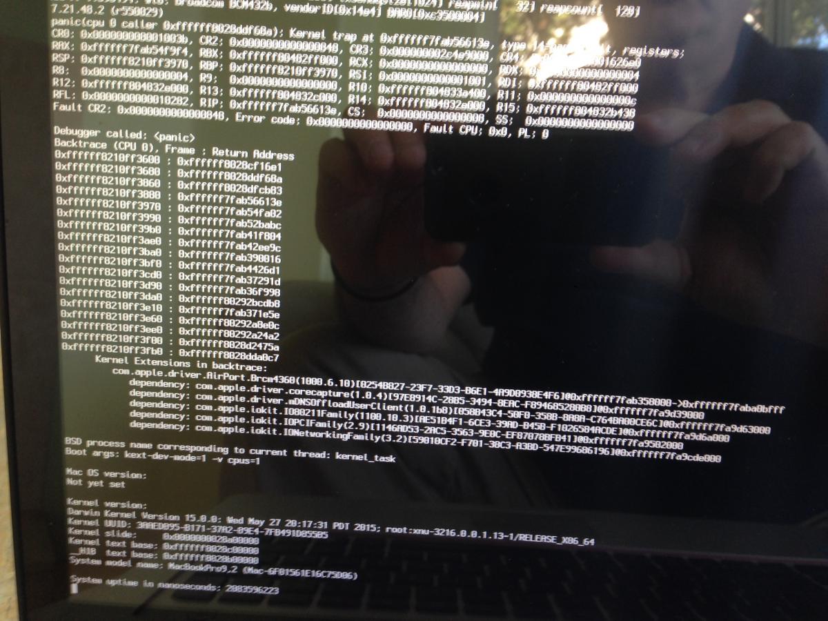

mnfesq Posted June 11, 2015 Share Posted June 11, 2015 Can't get past this KP. Any ideas? Link to comment https://www.insanelymac.com/forum/topic/306527-apple-unveils-os-x-1011-el-capitan/page/3/#findComment-2143719 Share on other sites More sharing options...
Allan Posted June 11, 2015 Share Posted June 11, 2015 Try remove AirPortBrcm4360 inside IO80211Family.kext. Use this boot-arg rootless=0 Link to comment https://www.insanelymac.com/forum/topic/306527-apple-unveils-os-x-1011-el-capitan/page/3/#findComment-2143723 Share on other sites More sharing options...
chris1111 Posted June 11, 2015 Share Posted June 11, 2015 Can't get past this KP. Any ideas? IMG_2343.jpg Try this plist Link to comment https://www.insanelymac.com/forum/topic/306527-apple-unveils-os-x-1011-el-capitan/page/3/#findComment-2143724 Share on other sites More sharing options...
JahStories Posted June 11, 2015 Share Posted June 11, 2015 I agree about Disk Utility... it's really messed up! Btw even if it not as faster as they claimed, these quick test confirms that's it is a little snappier. from my main rig: Link to comment https://www.insanelymac.com/forum/topic/306527-apple-unveils-os-x-1011-el-capitan/page/3/#findComment-2143727 Share on other sites More sharing options...
mnfesq Posted June 11, 2015 Share Posted June 11, 2015 Try remove AirPortBrcm4360 inside IO80211Family.kext. Use this boot-arg rootless=0 I deleted the entire IO80211Family.kext and repaired permissions. It still KP's at the exact same place with the AirPortBrcm4360.kext in backtrace. Link to comment https://www.insanelymac.com/forum/topic/306527-apple-unveils-os-x-1011-el-capitan/page/3/#findComment-2143732 Share on other sites More sharing options...
Allan Posted June 11, 2015 Share Posted June 11, 2015 Without IO80211Family.kext you don't have WiFi or Ethernet. Just open the kext and remove this plugin. Follow the @chris1111's tip: http://www.insanelymac.com/forum/topic/306527-apple-unveils-os-x-1011-el-capitan/?p=2143724 Link to comment https://www.insanelymac.com/forum/topic/306527-apple-unveils-os-x-1011-el-capitan/page/3/#findComment-2143734 Share on other sites More sharing options...
