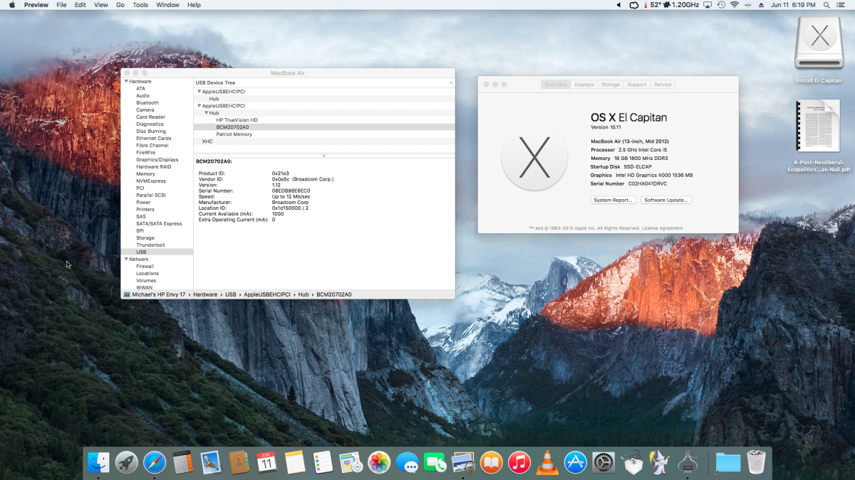

mnfesq Posted June 12, 2015 Share Posted June 12, 2015 OK, so I am writing this on my El Cap partition. That's a good thing. I got past the KP's due to the AirPortBrcm4360.kext by removing the DSM method for my wifi in my DSDT. I determined that I no longer have to make my wifi card compatible because the chipset is now. I wish the same were true with my Bluetooth. My Firmware injector is not working. Also, my VoodooHDA.kext is not working and it's the most current version. I'm still using cpus=1 because I have an HP laptop and the Clover patch does not work with El Cap. Lastly, my SMBIOS up until now has been MacBookPro9,2. I cannot seem to boot with that SMBIOS for El Cap and have had to use the Clover default, MacBookAir5,2. I'm hoping that does not mess up my ability to use Messages and FaceTime. Wisely or unwisely, I have the same iCloud account for both partitions, Yos and El Cap. Other than that, my experience with El Cap is basically positive. I sure would like to get the debug mode enabled in Disk Utility but may just have to use Third-Party software for more advanced functions that older versions of Disk Utility with Debug mode enabled could handle. Link to comment https://www.insanelymac.com/forum/topic/306527-apple-unveils-os-x-1011-el-capitan/page/4/#findComment-2144082 Share on other sites More sharing options...

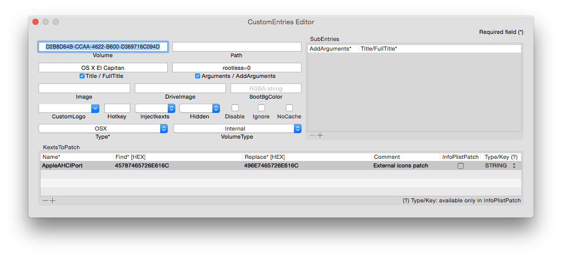

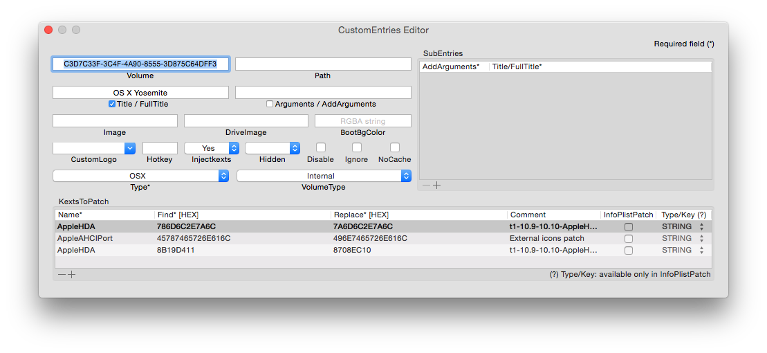

polyzargone Posted June 12, 2015 Share Posted June 12, 2015 I'm sure a new patch will come out once someone finds the new location for the code that needs patching. Have you tried the patch proposed by lisai9093 ? And you should really try Clover r3224. I'm not sure but this could fix the "OS detection" issue you met . BTW, could you tell how you do that : "I have separate config files for Yosemite and El Cap because I need different DSDT's for each installation" ? I'd like to do the same but since I have only one EFI partition with Clover to manage all my OS, I can't figure how to do this … Link to comment https://www.insanelymac.com/forum/topic/306527-apple-unveils-os-x-1011-el-capitan/page/4/#findComment-2144352 Share on other sites More sharing options...

mnfesq Posted June 13, 2015 Share Posted June 13, 2015 Have you tried the patch proposed by lisai9093 ? And you should really try Clover r3224. I'm not sure but this could fix the "OS detection" issue you met . BTW, could you tell how you do that : "I have separate config files for Yosemite and El Cap because I need different DSDT's for each installation" ? I'd like to do the same but since I have only one EFI partition with Clover to manage all my OS, I can't figure how to do this … I tried lisai9093's new handoff patch without success. It may be due to the modded IOBluetoothFamily.kext I'm using. I prefer to inject the firmware with a separate kext rather than to modify the apple kext but that is a project for another day. I am slow to get new builds of Clover so I haven't seen any links for Clover r3224. 3215 is the newest one I have seen. Having separate config files for Yosemite and El Cap is super-easy. Right next to my config.plist file is a file called config2.plist. When I boot to Clover, I select options and the first option is to select the config.plist. The default is "config" so I just type "2" at the end and it calls up that config. For me, I have different boot args, a different DSDT, which I call DSDT2.aml (it sits next to my DSDT.aml in ACPI/Patched, and now I have different Handoff patches (even if the patch for El Cap isn't working yet.) Link to comment https://www.insanelymac.com/forum/topic/306527-apple-unveils-os-x-1011-el-capitan/page/4/#findComment-2144413 Share on other sites More sharing options...
polyzargone Posted June 13, 2015 Share Posted June 13, 2015 I am slow to get new builds of Clover so I haven't seen any links for Clover r3224. 3215 is the newest one I have seen. Having separate config files for Yosemite and El Cap is super-easy. Right next to my config.plist file is a file called config2.plist. When I boot to Clover, I select options and the first option is to select the config.plist. The default is "config" so I just type "2" at the end and it calls up that config. For me, I have different boot args, a different DSDT, which I call DSDT2.aml (it sits next to my DSDT.aml in ACPI/Patched, and now I have different Handoff patches (even if the patch for El Cap isn't working yet.) See here for Clover r3224. Thanks for the config.plist tip but I know that. Actually, I was asking if there's a way to load a specific config.plist automatically depending of what OS Clover detects. In exemple : Loads config1.plist if Clover detects Mavericks, loads config2.plist if it's Yosemite, loads config3.plist if it's El Capitan etc. Link to comment https://www.insanelymac.com/forum/topic/306527-apple-unveils-os-x-1011-el-capitan/page/4/#findComment-2144526 Share on other sites More sharing options...
