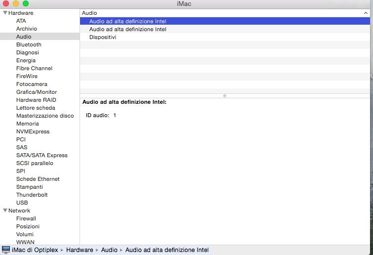

MacPeet Posted July 3, 2015 Share Posted July 3, 2015 Dear users, this is just for a test for Optiplex 755 !!! Layout ID 1 via DSDT or HDAEnabler patched for 10.10.3 or higher @teeodor If some connections then work please screenshots of System Preferences / Sound !!! differences: Optiplex 760/780 Device 114A194A Nodes: Mic front: 9 13 20 40 LineIn back: 8 12 21 LineOut back: 18 10 4 HP front: 17 7 34 3 Optiplex 755 Device 114A1984 Nodes: Mic front: 9 13 20 2 or 9 13 20 ??? LineIn back: 8 12 21 LineOut back: 18 10 4 HP front: 17 7 34 3 I hope. Good Luck. AppleHDA.kext_775_Ver01.zip AppleHDA.kext_775_Ver02.zip 3 Link to comment https://www.insanelymac.com/forum/topic/302877-guide-yosemite-1010x-dell-optiplex-780-760/page/14/#findComment-2150469 Share on other sites More sharing options...
teeodor Posted July 6, 2015 Share Posted July 6, 2015 Hi,thanks so much!I have tried all 2,no sound. I post to you one image Link to comment https://www.insanelymac.com/forum/topic/302877-guide-yosemite-1010x-dell-optiplex-780-760/page/14/#findComment-2151264 Share on other sites More sharing options...
MacPeet Posted July 7, 2015 Share Posted July 7, 2015 Too bad, I'll see what I can change. Link to comment https://www.insanelymac.com/forum/topic/302877-guide-yosemite-1010x-dell-optiplex-780-760/page/14/#findComment-2151509 Share on other sites More sharing options...
