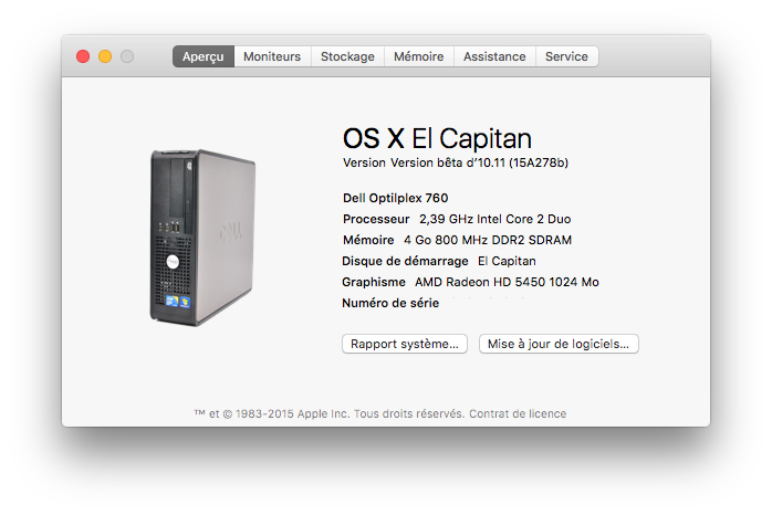

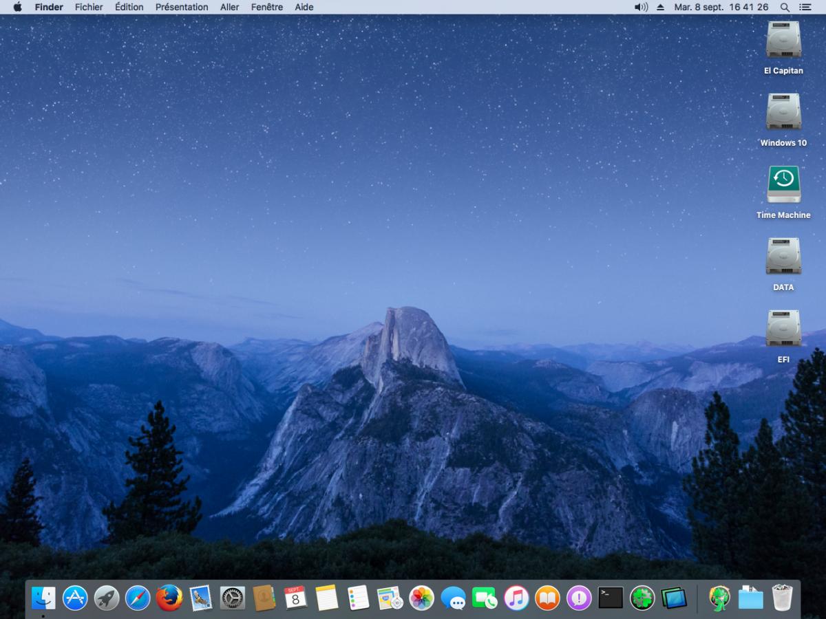

polyzargone Posted September 8, 2015 Share Posted September 8, 2015 (edited) Hey guys ! Wanted to share some report about El Capitan Public Beta 6 on the Dell Optiplex 760 SFF - Core e6600 - 4 Gb DDR2 - AMD Radeon HD 5450 1 Gb : Good news : Installation, graphics, network, sleep/wake, USB ports works fine. Still needs some tests on the USB side since El Capitan introduced new kexts for USB management but no issues so far and no need to install anything more (like DummyUSBEHCIPCI.kext - see here). Bad news : AppleHDA patch don't work anymore. We need an updated Clover patch and/or new platform & layout .zml.zlib. While waiting for this, VoodooHDA 2.8.7 works just fine. (I haven't tested newer or older versions). Attached is my Clover folder for those who want to test El Capitan before the GM and the final is out. And I have the feeling it will be very soon . Opimac:~ polyzargone$ csrutil statusSystem Integrity Protection status: enabled (Custom Configuration). Configuration:Apple Internal: disabledKext Signing: disabledFilesystem Protections: disabledDebugging Restrictions: enabledDTrace Restrictions: enabledNVRAM Protections: enabled This is an unsupported configuration, likely to break in the future and leave your machine in an unknown state. Opimac:~ polyzargone$ kextstat | grep -v com.appleIndex Refs Address Size Wired Name (Version) UUID <Linked Against> 22 2 0xffffff7f830be000 0x19000 0x19000 org.netkas.driver.FakeSMC (1363) 90461687-95E8-3618-AF0E-14B6F0380F0C <11 7 5 4 3 1> 23 0 0xffffff7f830d7000 0x5000 0x5000 org.hwsensors.driver.CPUSensors (1363) 01EDCDA6-816B-3C05-AF61-BFFB235C8FF4 <22 7 5 4 3> 42 0 0xffffff7f830dc000 0xe000 0xe000 com.tootoosoft.driver.Intel82566MM (1.0.0d1) 259B42A1-C7B2-46C8-F2FC-30C0BE21CDD6 <41 12 5 4 3 1> 47 0 0xffffff7f830ea000 0x2000 0x2000 net.osrom.kext.Disabler (1.0.1) 7D158CD9-D1C2-6ADC-D896-2FD8E29CD4AD <4 3> 50 0 0xffffff7f830ec000 0x21000 0x21000 org.voodoo.driver.VoodooHDA (2.8.7) no UUID <49 12 7 5 4 3> 52 0 0xffffff7f83120000 0x15000 0x15000 org.hwsensors.driver.GPUSensors (1363) 5E976353-9E21-34D6-BCEA-9E63B7010FC2 <22 12 11 7 5 4 3> 106 0 0xffffff7f8313a000 0x17000 0x17000 com.tuxera.filesystems.tufsfs.fusefs_txantfs (2013.3.14) 61F2ABBC-F434-3091-8169-063F600D60FD <7 5 4 3 1> Opimac:~ polyzargone$ ioreg | grep ATY | | | | +-o ATY,Eulemur@0 <class AtiFbStub, id 0x1000002ad, registered, matched, active, busy 0 (7 ms), retain 8> | | | | | +-o ATY_Eulemur <class AMDFramebuffer, id 0x1000002b0, registered, matched, active, busy 0 (6 ms), retain 18> | | | | +-o ATY,Eulemur@1 <class AtiFbStub, id 0x1000002ae, registered, matched, active, busy 0 (3 ms), retain 8> | | | | | +-o ATY_Eulemur <class AMDFramebuffer, id 0x1000002b6, registered, matched, active, busy 0 (0 ms), retain 15> | | | | +-o ATY,Eulemur@2 <class AtiFbStub, id 0x1000002af, registered, matched, active, busy 0 (1 ms), retain 8> | | | | | +-o ATY_Eulemur <class AMDFramebuffer, id 0x1000002bc, registered, matched, active, busy 0 (0 ms), retain 15> Opimac:~ polyzargone$ ioreg | grep AMD | | | | +-o AMD5000Controller@0 <class AMD5000Controller, id 0x100000298, registered, matched, active, busy 0 (0 ms), retain 5> | | | | | +-o ATY_Eulemur <class AMDFramebuffer, id 0x1000002b0, registered, matched, active, busy 0 (6 ms), retain 18> | | | | | +-o AMDNDRVService <class AtiAppServices, id 0x1000002f4, registered, matched, active, busy 0 (0 ms), retain 6> | | | | | +-o ATY_Eulemur <class AMDFramebuffer, id 0x1000002b6, registered, matched, active, busy 0 (0 ms), retain 15> | | | | | +-o AMDNDRVService <class AtiAppServices, id 0x1000002fa, registered, matched, active, busy 0 (0 ms), retain 6> | | | | | +-o ATY_Eulemur <class AMDFramebuffer, id 0x1000002bc, registered, matched, active, busy 0 (0 ms), retain 15> | | | | | +-o AMDNDRVService <class AtiAppServices, id 0x1000002fe, registered, matched, active, busy 0 (0 ms), retain 6> | | | | +-o AMDSupport <class AMDSupport, id 0x100000299, registered, matched, active, busy 0 (0 ms), retain 5> | | | | +-o AMDCedarGraphicsAccelerator <class AMDCedarGraphicsAccelerator, id 0x10000029b, registered, matched, active, busy 0 (0 ms), retain 33> | | | | +-o AMDRadeonX3000_AMDAccel2DContext <class AMDRadeonX3000_AMDAccel2DContext, id 0x100000303, !registered, !matched, active, busy 0, retain 7> | | | | +-o AMDRadeonX3000_AMDAccel2DContext <class AMDRadeonX3000_AMDAccel2DContext, id 0x100000304, !registered, !matched, active, busy 0, retain 6> | | | | +-o AMDRadeonX3000_AMDAccel2DContext <class AMDRadeonX3000_AMDAccel2DContext, id 0x100000305, !registered, !matched, active, busy 0, retain 6> | | | | +-o AMDR8xxSurface <class AMDR8xxSurface, id 0x10000030d, !registered, !matched, active, busy 0, retain 6> | | | | +-o AMDR8xxSurface <class AMDR8xxSurface, id 0x10000030e, !registered, !matched, active, busy 0, retain 6> | | | | +-o AMDR8xxSurface <class AMDR8xxSurface, id 0x10000030f, !registered, !matched, active, busy 0, retain 6> | | | | +-o AMDRadeonX3000_AMDAccelDevice <class AMDRadeonX3000_AMDAccelDevice, id 0x10000031a, !registered, !matched, active, busy 0, retain 6> | | | | +-o AMDRadeonX3000_AMDAccelSharedUserClient <class AMDRadeonX3000_AMDAccelSharedUserClient, id 0x10000031b, !registered, !matched, active, busy 0, retain 6> | | | | +-o AMDR8xxGLContext <class AMDR8xxGLContext, id 0x10000031e, !registered, !matched, active, busy 0, retain 6> | | | | +-o AMDR8xxSurface <class AMDR8xxSurface, id 0x100000323, !registered, !matched, active, busy 0, retain 6> | | | | +-o AMDR8xxSurface <class AMDR8xxSurface, id 0x100000324, !registered, !matched, active, busy 0, retain 6> | | | | +-o AMDRadeonX3000_AMDAccelDevice <class AMDRadeonX3000_AMDAccelDevice, id 0x100000345, !registered, !matched, active, busy 0, retain 6> | | | | +-o AMDRadeonX3000_AMDAccelSharedUserClient <class AMDRadeonX3000_AMDAccelSharedUserClient, id 0x100000346, !registered, !matched, active, busy 0, retain 6> | | | | +-o AMDR8xxGLContext <class AMDR8xxGLContext, id 0x100000347, !registered, !matched, active, busy 0, retain 6> | | | | +-o AMDR8xxCLContext <class AMDR8xxCLContext, id 0x100000348, !registered, !matched, active, busy 0, retain 6> | | | | +-o AMDRadeonX3000_AMDAccelDevice <class AMDRadeonX3000_AMDAccelDevice, id 0x1000003aa, !registered, !matched, active, busy 0, retain 6> | | | | +-o AMDR8xxSurface <class AMDR8xxSurface, id 0x1000003b1, !registered, !matched, active, busy 0, retain 6> | | | | +-o AMDRadeonX3000_AMDAccelDevice <class AMDRadeonX3000_AMDAccelDevice, id 0x1000003d9, !registered, !matched, active, busy 0, retain 6> | | | | +-o AMDRadeonX3000_AMDAccelSharedUserClient <class AMDRadeonX3000_AMDAccelSharedUserClient, id 0x1000003da, !registered, !matched, active, busy 0, retain 6> | | | | +-o AMDR8xxGLContext <class AMDR8xxGLContext, id 0x1000003db, !registered, !matched, active, busy 0, retain 6> | | | | +-o AMDR8xxGLContext <class AMDR8xxGLContext, id 0x1000003dc, !registered, !matched, active, busy 0, retain 6> Note : CLOVER.zip has been removed. Waiting for a new version with new DSDT - Follow this thread to stay tuned . Edited September 28, 2015 by polyzargone Link to comment https://www.insanelymac.com/forum/topic/302877-guide-yosemite-1010x-dell-optiplex-780-760/page/17/#findComment-2166293 Share on other sites More sharing options...
