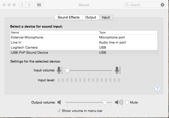

MacPeet Posted May 21, 2015 Share Posted May 21, 2015 A really serious case For me the sound is very good. With me Headphone has great sound quality. Has he now sound via VoodooHDA or AppleHDA ???? Delete AppleHDADisabler.kext, VoodooHDA and VoodooHDASettingsloader in System Preferences/Startup object Link to comment https://www.insanelymac.com/forum/topic/302877-guide-yosemite-1010x-dell-optiplex-780-760/page/10/#findComment-2137586 Share on other sites More sharing options...

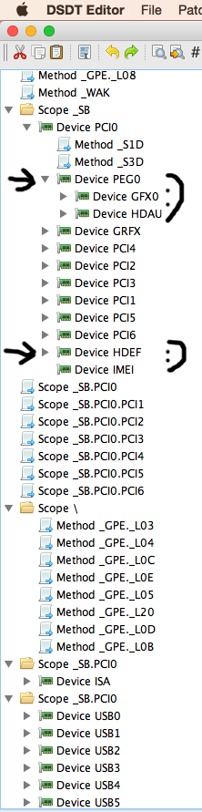

polyzargone Posted May 21, 2015 Share Posted May 21, 2015 @morpheousman Here's another edited DSDT with GFX, HDAU & HDEF devices fixed. It's based on Jake Lo's original DSDT so it's basically the same as the one you're currently using. Use this with patched AppleHDA v3 (HDAEnabler1.kext is useless in this case) or On-the-fly patching method. It works with both ! You can't fail with all of this informations Hello, it sounded very promising to have native Audio with HDMI as well so I tried to install the AppleHDA as well. My steps: (Big mistake, accidentally overrid config.plist with an empty one, grrrrrr) - del VoodooHDA, VoodooHDASettingsloader, AppleHDADisabler - Install AppleHDA_Version3 with Kext Wizard - import MacPeets sample config.plist and change Serials etc. - mod DSDT.aml with MaciASL: "layout-id", Buffer (0x04) { 0x01, 0x00, 0x00, 0x00 }, - fixed permissions and rebuilt cache with Kext Wizard - Rebooted. Unfortunately regular system audio is not working at all... :/ Can't test HDMI. Editing config.plist for on-the-fly patching is unnecessary as you're already use the patched AppleHDA v.3. Remove these edits and it should work . Or use method 2. But not both at the same time. Also, check that HDEF device is correctly placed in the DSDT. I've noticed that Jake Lo's original one is incorrectly configured on that particular point. DSDT.zip 1 Link to comment https://www.insanelymac.com/forum/topic/302877-guide-yosemite-1010x-dell-optiplex-780-760/page/10/#findComment-2137668 Share on other sites More sharing options...

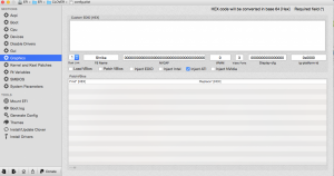

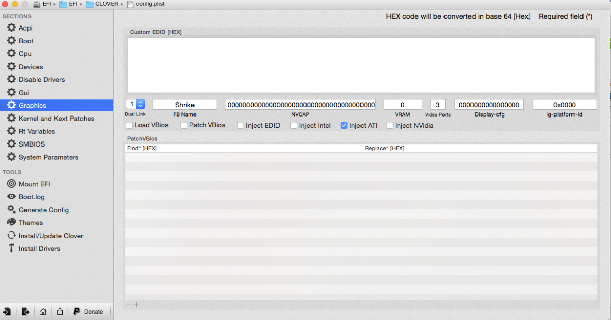

morpheousman Posted May 22, 2015 Share Posted May 22, 2015 @Polyzargone I installed HDAEnabler1 and tried both simple method 1 and injection, no success. No HDMI in Sound Settings. Did I miss something? Was this only for Method I or Method 2? Probably something simple in my config, or kext conflict. I am still trying to learn. @ MacPeet ioreg attached for you. Delete AppleHDADisabler.kext, VoodooHDA and VoodooHDASettingsloader in System Preferences/Startup objectDelete AppleHDADisabler.kext, VoodooHDA and VoodooHDASettingsloader in System Preferences/Startup object How do I do that? I have google searched, but cannot find answer. Link to comment https://www.insanelymac.com/forum/topic/302877-guide-yosemite-1010x-dell-optiplex-780-760/page/10/#findComment-2137698 Share on other sites More sharing options...

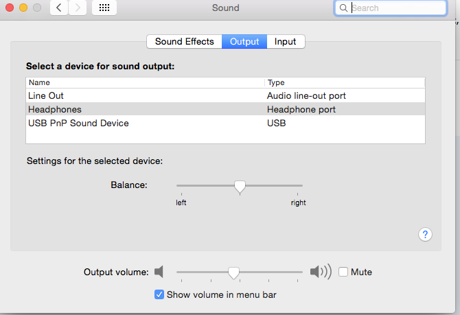

MacPeet Posted May 22, 2015 Share Posted May 22, 2015 I see the pictures you've got now already sound with AppleHDA, right? HDAU is incorrect in ioreg. Post your DSDT.aml here, please. Link to comment https://www.insanelymac.com/forum/topic/302877-guide-yosemite-1010x-dell-optiplex-780-760/page/10/#findComment-2137727 Share on other sites More sharing options...
morpheousman Posted May 22, 2015 Share Posted May 22, 2015 Yes, I have AppleHDA audio out the Line out and Headphones. Headphones are sounding pretty good too. Did I patch my Config correctly? Thanks for your help! Edit: I tried to boot with the DSDT you attached a few posts back, and it hangs on boot. Hangs at dependency:com.apple.10kit.IOACPIFAMILY(1.4)...... Will not boot Ignore Cache, or Injected Kexts. Had to connect the hard drive to another install via USB and change the DSDT back. Weird Stuff! My case is the SFF not the Mid Tower. Not sure how much that matters. My SFF only has 2 PCI slots, if that matters. DSDT.aml.zip Link to comment https://www.insanelymac.com/forum/topic/302877-guide-yosemite-1010x-dell-optiplex-780-760/page/10/#findComment-2137728 Share on other sites More sharing options...

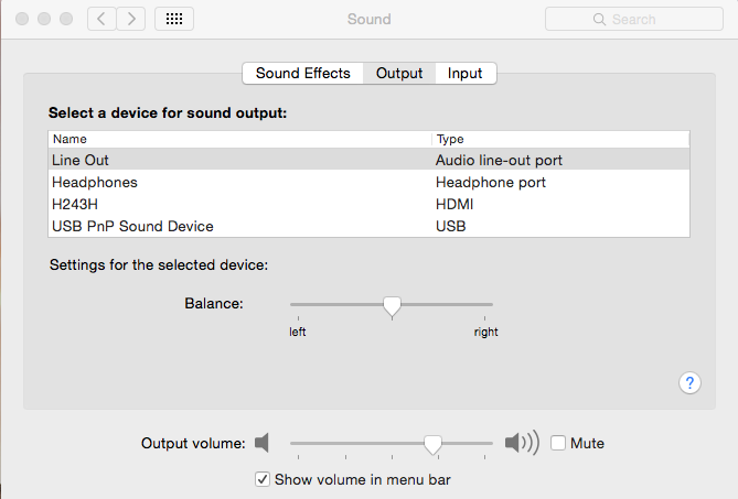

morpheousman Posted May 22, 2015 Share Posted May 22, 2015 @Polyzargone I used your config from post #234, and your DSDT with Version 3 AppleHDA.Kext and...... Woohooo! Fully-Functional AppleHDA Sound, including Sound Over HDMI. Looks like my config had issues. I will start with your config, and add on from there. Edit: I cannot open your Config in Clover Configurator. Just empty windows. I edited my RTVariables in TextEdit. Too tired to look for an update now. Many thanks!!! @MacPeet Thank you so much for your contributions to this Optiplex 780/760 project!!! Please do us all a large favor, and keep coming back! Link to comment https://www.insanelymac.com/forum/topic/302877-guide-yosemite-1010x-dell-optiplex-780-760/page/10/#findComment-2137743 Share on other sites More sharing options...
polyzargone Posted May 22, 2015 Share Posted May 22, 2015 @morpheousman Finally ! Have you updated Clover Configurator to 4.22.9 yet ? It may be due to changes on how config.plist are managed (which is far more better than previous versions BTW) because I don't have any problems opening the one from #234. Link to comment https://www.insanelymac.com/forum/topic/302877-guide-yosemite-1010x-dell-optiplex-780-760/page/10/#findComment-2137762 Share on other sites More sharing options...
