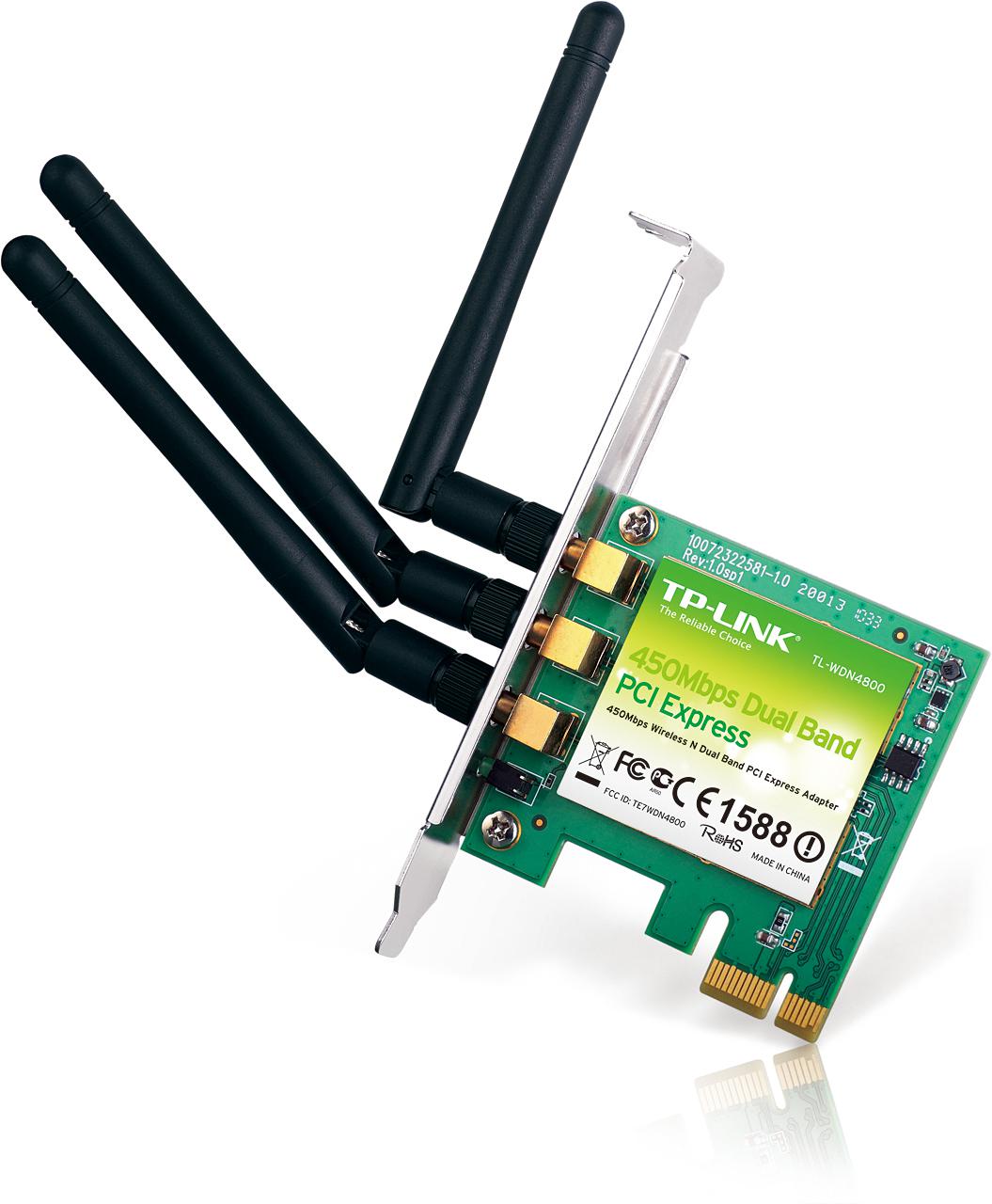

MacPeet Posted December 6, 2015 Share Posted December 6, 2015 WLAN: TP-Link TL-WDN4800 N900 Dualband-Adapter (PCIe, 450 Mbit/s) ——> works OOB with my Optiplex 780 Bluetooth: try another BT stick graphic: What is the Monitor connect ??? HDMI? I think with HDMI is only 1920x1080. The HD5450 can not there more with HDMI. Link to comment https://www.insanelymac.com/forum/topic/302877-guide-yosemite-1010x-dell-optiplex-780-760/page/19/#findComment-2194376 Share on other sites More sharing options...

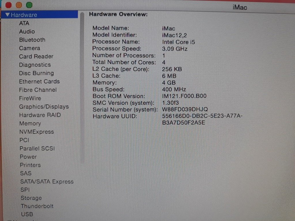

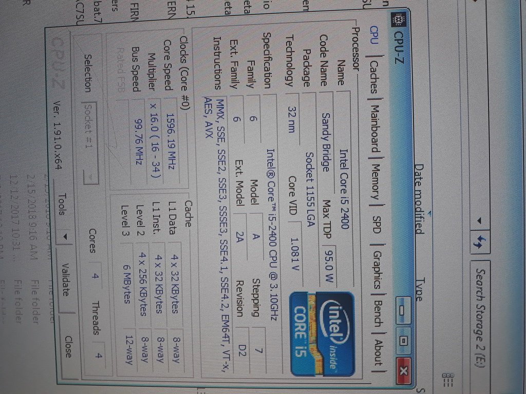

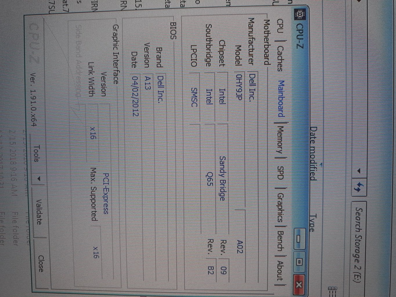

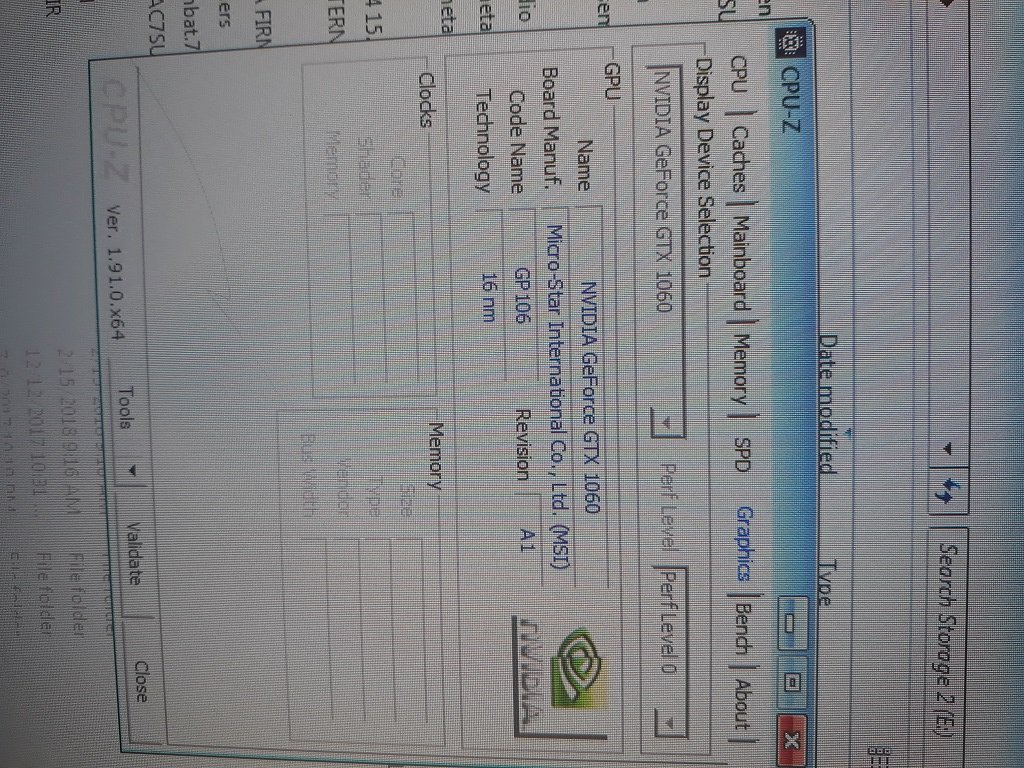

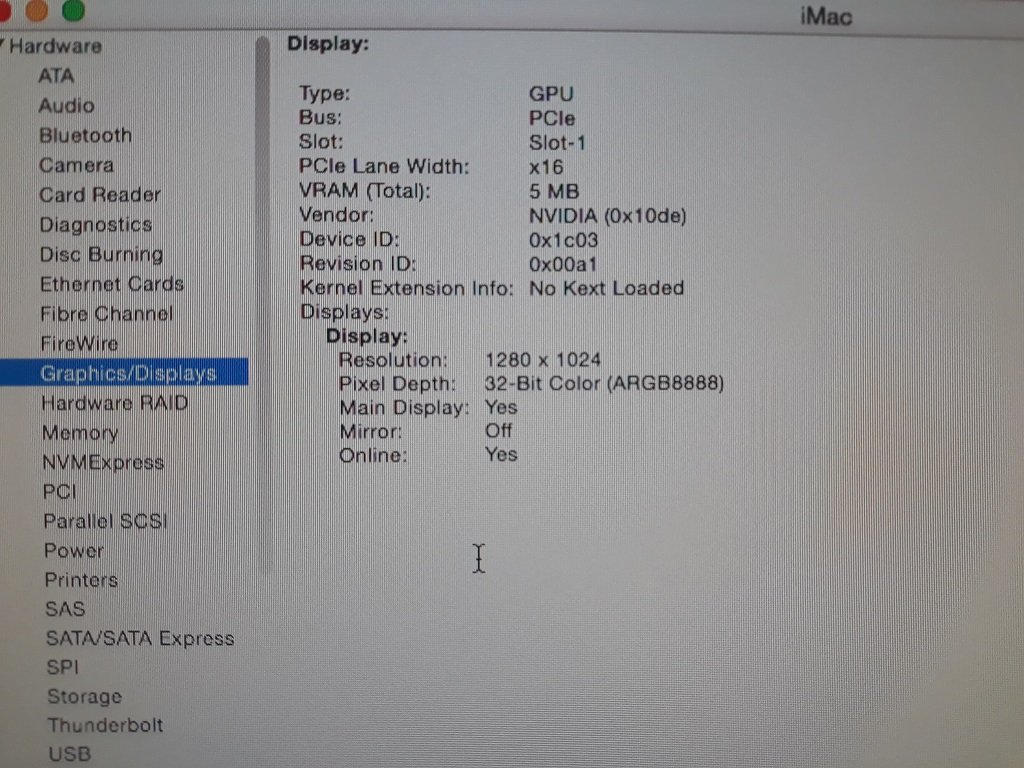

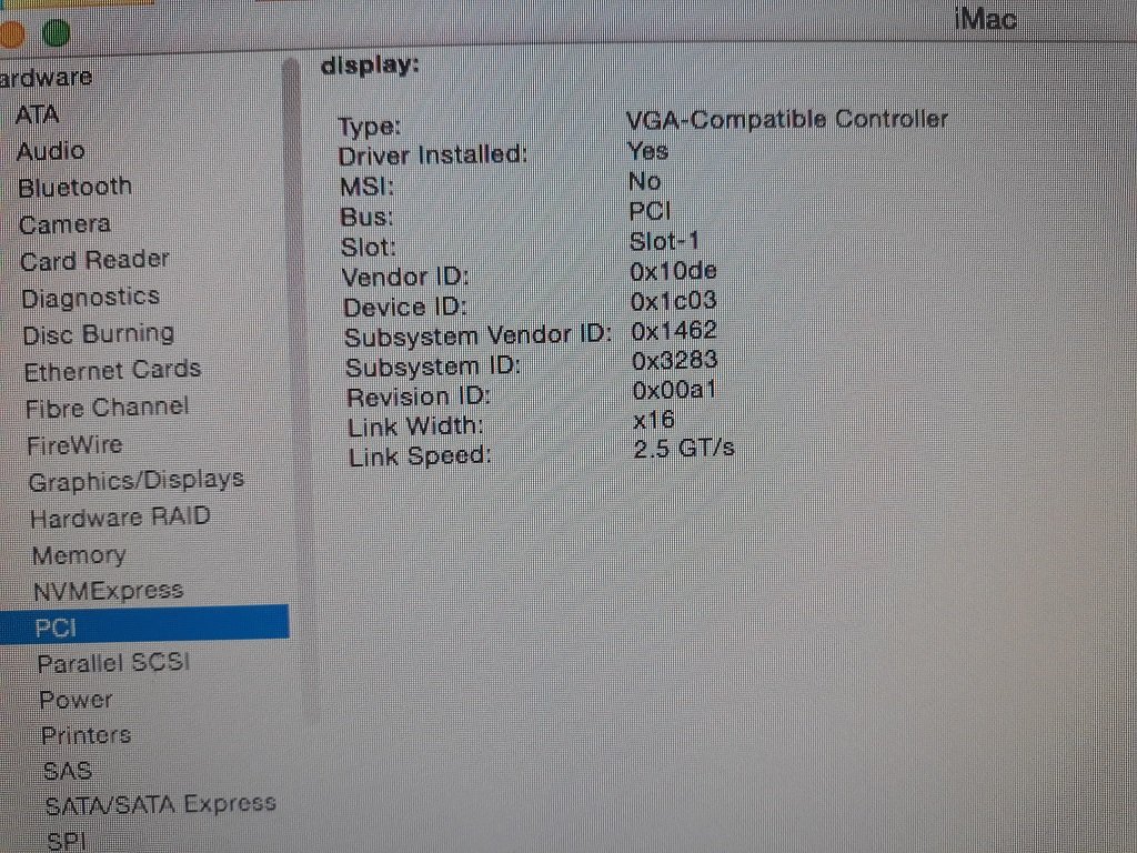

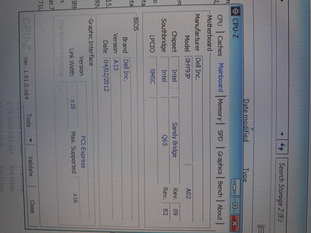

bogdangepe Posted March 19, 2020 Share Posted March 19, 2020 Hi, I need a little help. I managed to install Yosemite, Dell 790 i5 2400, gtx 1060. Everything works, except the gtx1060 video card. I installed nvidia web driver, it loads it but it has no graphics acceleration. El Capitan, Sierra, High Sierra do not manage to install them. I have attached the EFI file, maybe someone can help me make my DSDT. The files are extracted to the origin folder. https://mega.nz/#!k9JHHIaZ!JmuzVfcB6I5QPsbq1FBTUKYZycMBTR2lEXKxv1naw3Y https://mega.nz/#F!lwAxVAoJ!XckwbahrS71yXIxxTpUZTQ Link to comment https://www.insanelymac.com/forum/topic/302877-guide-yosemite-1010x-dell-optiplex-780-760/page/19/#findComment-2712863 Share on other sites More sharing options...
