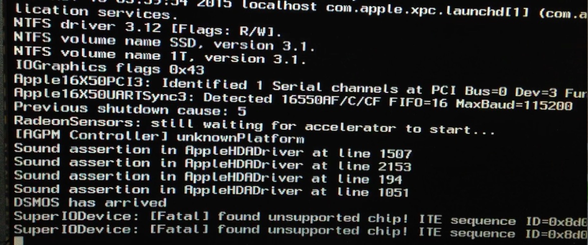

DutchAcerOne Posted November 15, 2015 Share Posted November 15, 2015 Try this DSDT.aml instead of the current one in /EFI/CLOVER/ACPI/patched : I disabled "InjectATI" with Clover Configurator. I saw there is the verbose (-v) option and I swichted that on. I placed your DSDT in folder /EFI/CLOVER/ACPI/patched of the installation usb-stick and rebooted. But nothing changed (I get some scrolling text, but it goes to fast to see wat ihe last line is). Then the screen darkens and activity on the usb-stick stops. Edit: I made movie with my iPhone and was able to catch the last moment, line says something like: "SuperIODevice: [fatal] found unsupported chip!" (see attachment) Few days ago I tested the Radeon HD5450 with windows 7 and made a screen dump of the specs as shows by 'speccy'. See attachment. Maybe AMD is using a different chipset or rom than the ones who are working without problems? Link to comment https://www.insanelymac.com/forum/topic/302877-guide-yosemite-1010x-dell-optiplex-780-760/page/18/#findComment-2188577 Share on other sites More sharing options...

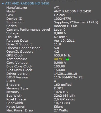

polyzargone Posted November 15, 2015 Share Posted November 15, 2015 Well according to your screenshots, seems like you have the same exact "problem" than member jakeyg1. Your Radeon HD 5450 is NOT a 5450. Look here then you can see that it's more likely a Radeon HD 6450 model. And as I said, this card is natively supported on OS X. But the Generic DSDT I pointed out should have solved the problem. Don't worry about messages in verbose mode, they don't really matters. It's just FakeSMC's GPU Plugins that complains it can't identify your model. Try with InjectATI=true AND with the Generic DSDT. Also, tell me what video connectors and display you're currently using (HDMI/DVI/VGA) ad post your config.plist too. Link to comment https://www.insanelymac.com/forum/topic/302877-guide-yosemite-1010x-dell-optiplex-780-760/page/18/#findComment-2188606 Share on other sites More sharing options...
DutchAcerOne Posted November 15, 2015 Share Posted November 15, 2015 Try with InjectATI=true AND with the Generic DSDT. Also, tell me what video connectors and display you're currently using (HDMI/DVI/VGA) ad post your config.plist too. Didn't help. After a few seconds the Apple logo disappears and installation halts. See attachment for my config.plist. Maybe can send me the whole EFI-folder (about 8 MB), there is so much discussion about merging, replacing or deleting the Clover-folder... ;-) config.plist.zip Link to comment https://www.insanelymac.com/forum/topic/302877-guide-yosemite-1010x-dell-optiplex-780-760/page/18/#findComment-2188632 Share on other sites More sharing options...
polyzargone Posted November 15, 2015 Share Posted November 15, 2015 Remove Shrike in Clover Configurator > Graphics > FB Name. Maybe can send me the whole EFI-folder (about 8 MB), there is so much discussion about merging, replacing or deleting the Clover-folder... ;-) May be helpful yes. BTW, did you edit any AMD kexts ? Link to comment https://www.insanelymac.com/forum/topic/302877-guide-yosemite-1010x-dell-optiplex-780-760/page/18/#findComment-2188648 Share on other sites More sharing options...
DutchAcerOne Posted November 15, 2015 Share Posted November 15, 2015 Hi, Removed 'shrike' with Clover Configurator, but that didn't help. I did not edit any kexts yet. As attachment my zipped EFI-folder from the usb-stick. (I'm so happy you have some time to help me, thanks a lot!) EFI.zip Link to comment https://www.insanelymac.com/forum/topic/302877-guide-yosemite-1010x-dell-optiplex-780-760/page/18/#findComment-2188662 Share on other sites More sharing options...
polyzargone Posted November 15, 2015 Share Posted November 15, 2015 Good, but I need to know what connectors/Display you're using. Your whole EFI folder is OK and I'm pretty sure there's no problem with it. The only reason I can see why your Monitor goes black is that there's an issue with the way you connect it to the Optiplex. HDMI/DVI is prefered though it should work fine in VGA too. Have you tried others video ports on your "Radeon 6450 disguised in 5450" ? Link to comment https://www.insanelymac.com/forum/topic/302877-guide-yosemite-1010x-dell-optiplex-780-760/page/18/#findComment-2188674 Share on other sites More sharing options...
DutchAcerOne Posted November 15, 2015 Share Posted November 15, 2015 I used the DVI until now, the VGA is on a seperate connector on the Radeon 6450/5450 but I was able to use it via a opening in the housing (I'm using a Optiplex smal form factor). But it doesn't solve the problem... Installation starts, I see the logo few seconds and then the screen go black. I give up, gonna look for a different video card... Link to comment https://www.insanelymac.com/forum/topic/302877-guide-yosemite-1010x-dell-optiplex-780-760/page/18/#findComment-2188688 Share on other sites More sharing options...
