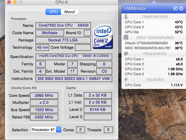

René_ Posted May 25, 2015 Share Posted May 25, 2015 I have read that Clover Generated Config is known to mess up CPU settings. When I use Clover Configurator to generate boot log, it shows Clover see Correct CPU of E8400, but it says Threads 2, Cores 1: :9:899 0:000 CPU Vendor = 756E6547 Model=1067A 19:899 0:000 The CPU not supported turbo 19:899 0:000 BrandString = Intel(R) Core(TM)2 Duo CPU E8400 @ 3.00GHz 19:899 0:000 MSR dumps: 19:899 0:000 @0x00CD=80000804 19:899 0:000 @0x0198=616091E0600091E 19:899 0:000 FSBFrequency=577MHz DMIvalue=1333330kHz 19:899 0:000 Corrected FSBFrequency=1333MHz 19:899 0:000 Vendor/Model/Stepping: 0x756E6547/0x17/0xA 19:899 0:000 Family/ExtFamily: 0x6/0x0 19:899 0:000 MaxDiv/MinDiv: 9.0/6 19:899 0:000 Turbo: 10/0/0/0 19:899 0:000 Features: 0xBFEBFBFF 19:899 0:000 Threads: 2 19:899 0:000 Cores: 1 19:899 0:000 FSB: 1333 MHz 19:899 0:000 CPU: 5200 MHz 19:899 0:000 TSC: 5200 MHz 19:899 0:000 PIS: 5333 MHz My Q9450 shows the same as yours, 1 Core. I think Clover mixed "Cores, Treads and CPU" When I look at CPU-X, System info, HWSensors and Activity monitor it is shown as it is: 2 Link to comment https://www.insanelymac.com/forum/topic/302877-guide-yosemite-1010x-dell-optiplex-780-760/page/11/#findComment-2138529 Share on other sites More sharing options...
morpheousman Posted May 25, 2015 Share Posted May 25, 2015 My Q9450 shows the same as yours, 1 Core. I think Clover mixed "Cores, Treads and CPU" When I look at CPU-X, System info, HWSensors and Activity monitor it is shown as it is: Yeah, good post! Mine runs too good once it is booted to be running on only one core. CPU-X does show 2 Cores on mine, but it has the Rated FSB & Multiplier incorrect. My e8400 has a FSB of 333 MHZ, or to be more accurate, 332.500 KHZ with a Multiplier of 9, 332,500 X 9 = 2,992,500 or 3GHZ HWMonitor is more accurate, showing my Multiplier running between x6 and x9. Link to comment https://www.insanelymac.com/forum/topic/302877-guide-yosemite-1010x-dell-optiplex-780-760/page/11/#findComment-2138561 Share on other sites More sharing options...

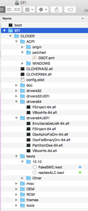

morpheousman Posted May 26, 2015 Share Posted May 26, 2015 I assume that Clover is installed in UEFI and not Legacy (EFI folder) at the root of system disk since you're always referencing to the EFI partition. I have Clover installed in my EFI Partition. EFI/EFI/Clover Is Clover supposed to be installed somewhere else? Guide Says: "Move the folder /Clover from the unzipped to your hard drives /EFI/EFI/Clover/ location, make sure to choose to MERGE these folders." What do you mean, "I assume clover is installed in UEFI", where is UEFI? Link to comment https://www.insanelymac.com/forum/topic/302877-guide-yosemite-1010x-dell-optiplex-780-760/page/11/#findComment-2138730 Share on other sites More sharing options...
polyzargone Posted May 26, 2015 Share Posted May 26, 2015 I meant in UEFI mode aka EFI partition based installation. Well you've got a lot of things in drivers64UEFI folder and you need… none of them since this folder is useless if you have Legacy bios like the one of Optiplex series. Remove all files in this folder (not the folder) and it should speed up the boot process. You can also try to replace VBoxHfs-64.efi by HFSPlus.efi in drivers64 folder. It's a little bit faster than VBoxHfs-64.efi. Link to comment https://www.insanelymac.com/forum/topic/302877-guide-yosemite-1010x-dell-optiplex-780-760/page/11/#findComment-2138790 Share on other sites More sharing options...
