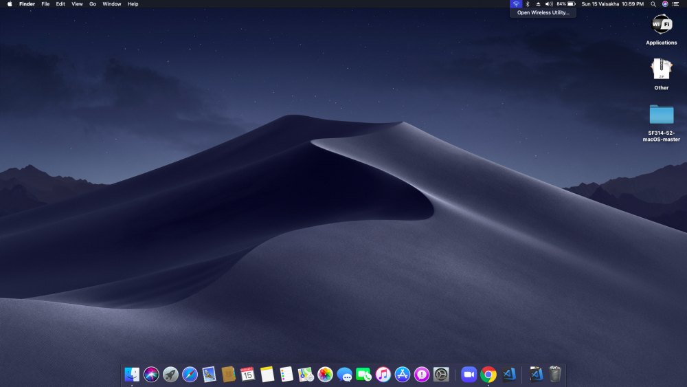

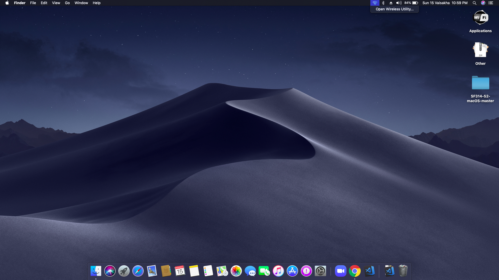

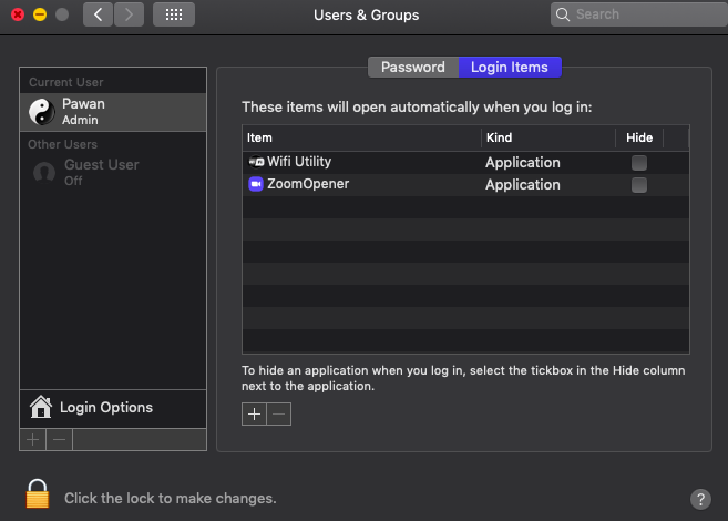

pawanzZ Posted May 5, 2019 Share Posted May 5, 2019 On 5/9/2018 at 3:58 AM, wfd18 said: Installed the kext and rebooted but still constantly opening and closing.. I managed to get the mediatek wireless utility to work from here: https://www.tonymacx86.com/threads/mediatek-wireless-dongle-mt7601-chip-sierra.244543/ this one actually stays open now, but pretty sure it still isn't picking up my device... I've tried so many things, I just want this to work.. Any ideas..? I was able to get it to work with the same device specs. My wifi adaptor dongle was from Wayona 802.11n used the https://www.insanelymac.com/applications/core/interface/file/attachment.php?id=298354 kext , along with the wifi utility tool. Was not able to see connected devices initially. After Rescan - found the available ssid's I had to keep the application in the "wake on signin" list in case wifi gets disabled after sleep etc., so that I can get the app start again once I sign out and sign In Bingo- Thanks to dev @chris1111 and all participants. I'm made this in my recent build Hackintosh for Acer Swift3 SF314-52 (MAC OS Mojave 10.4.0) BTW Link to comment https://www.insanelymac.com/forum/topic/299948-usb-wifi-updated-ralinkmediatek-rt2870-rt2770-rt3x7x-rt537x-rt5572/page/14/#findComment-2672653 Share on other sites More sharing options...
