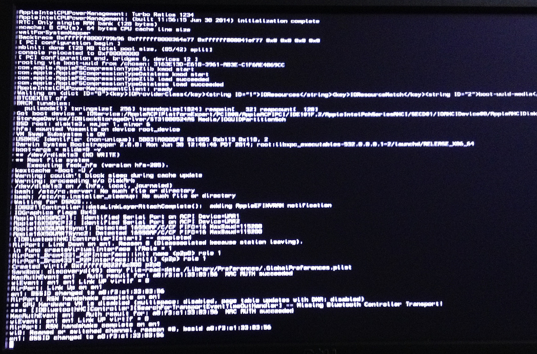

ADHDMedia Posted July 10, 2014 Share Posted July 10, 2014 Untill yesterday my Yosemite DP3 was working fine... but today it stops at APPLEKEXTEXCLUDEDLIST... what could it be? Rebuild Kernel Cache? If so, how can I do it without booting to Yosemite? I have another partition with Mavericks... I'm sending a picture and my boot.plist Can anyone help me? Thank you! Using Chameleon_2.2svn_r2380_10.10_CBv2 My Boot.plist are: DropSSDT Yes EthernetBuiltIn Yes GraphicsEnabler Yes Kernel /System/Library/Kernels/kernel Kernel Flags -v kext-dev-mode=1 Legacy Logo Yes Theme Default Timeout 3 UseKernelCache Yes It's FileNVRAM.dylib. 1 Link to comment https://www.insanelymac.com/forum/topic/298402-os-x-yosemite-dps-builds/page/51/#findComment-2038817 Share on other sites More sharing options...
prcmelo Posted July 10, 2014 Share Posted July 10, 2014 Thank you, ADHDMedia ! I'll try without NVRAM.dlyb... but I think I can't login to Messages without NVRAM.dylib... 1 Link to comment https://www.insanelymac.com/forum/topic/298402-os-x-yosemite-dps-builds/page/51/#findComment-2038823 Share on other sites More sharing options...
ADHDMedia Posted July 10, 2014 Share Posted July 10, 2014 Thank you, ADHDMedia ! I'll try without NVRAM.dlyb... but I think I can't login to Messages without NVRAM.dylib... Yup. Once you get the cache rebuilt you should be able to drop FileNVRAM.dylib back into your Modules folder. For whatever reason, it just doesn't get past AppleKextExcludeList when you try to boot without caches with Chameleon. I didn't stick around on Chameleon for long enough to find out why lol Link to comment https://www.insanelymac.com/forum/topic/298402-os-x-yosemite-dps-builds/page/51/#findComment-2038832 Share on other sites More sharing options...
RN95 Posted July 10, 2014 Share Posted July 10, 2014 Untill yesterday my Yosemite DP3 was working fine... but today it stops at APPLEKEXTEXCLUDEDLIST... what could it be? Rebuild Kernel Cache? If so, how can I do it without booting to Yosemite? I have another partition with Mavericks... I'm sending a picture and my boot.plist Can anyone help me? Thank you! Using Chameleon_2.2svn_r2380_10.10_CBv2 My Boot.plist are: <key>DropSSDT</key> <string>Yes</string> <key>EthernetBuiltIn</key> <string>Yes</string> <key>GraphicsEnabler</key> <string>Yes</string> <key>Kernel</key> <string>/System/Library/Kernels/kernel</string> <key>Kernel Flags</key> <string>-v kext-dev-mode=1</string> <key>Legacy Logo</key> <string>Yes</string> <key>Theme</key> <string>Default</string> <key>Timeout</key> <string>3</string> <key>UseKernelCache</key> <string>Yes</string> Hi, I had similar symptoms and fixed it by removing the Kernel Flag : <key>Kernel</key> <string>/System/Library/Kernels/kernel</string> Using 2391. Good luck Link to comment https://www.insanelymac.com/forum/topic/298402-os-x-yosemite-dps-builds/page/51/#findComment-2038912 Share on other sites More sharing options...

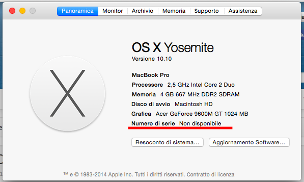

Marchrius Posted July 10, 2014 Share Posted July 10, 2014 I have this "problem" with Yosemite. Serial number: Not available With this I can't connect to iMessage and FaceTime. The same Serial Number is totally functional in Mavericks/Mountain Lion/Lion ecc... Link to comment https://www.insanelymac.com/forum/topic/298402-os-x-yosemite-dps-builds/page/51/#findComment-2039137 Share on other sites More sharing options...
Allan Posted July 10, 2014 Share Posted July 10, 2014 try edit the serial number. which bootloader you use? Link to comment https://www.insanelymac.com/forum/topic/298402-os-x-yosemite-dps-builds/page/51/#findComment-2039139 Share on other sites More sharing options...
Lordadmiral Drake Posted July 10, 2014 Share Posted July 10, 2014 So i updated to DP2, and now my System refuses to boot. No matter which settings and boot flags i choose in clover I tried now with and without: safe mode, verbose mode, single user mode and loading fakesmc explicitly (alone and in combinations) and nothing got OS X to boot successfully Link to comment https://www.insanelymac.com/forum/topic/298402-os-x-yosemite-dps-builds/page/51/#findComment-2039146 Share on other sites More sharing options...
Marchrius Posted July 10, 2014 Share Posted July 10, 2014 try edit the serial number. which bootloader you use? Clover 2747. Just tried another serial but don't works... Link to comment https://www.insanelymac.com/forum/topic/298402-os-x-yosemite-dps-builds/page/51/#findComment-2039153 Share on other sites More sharing options...

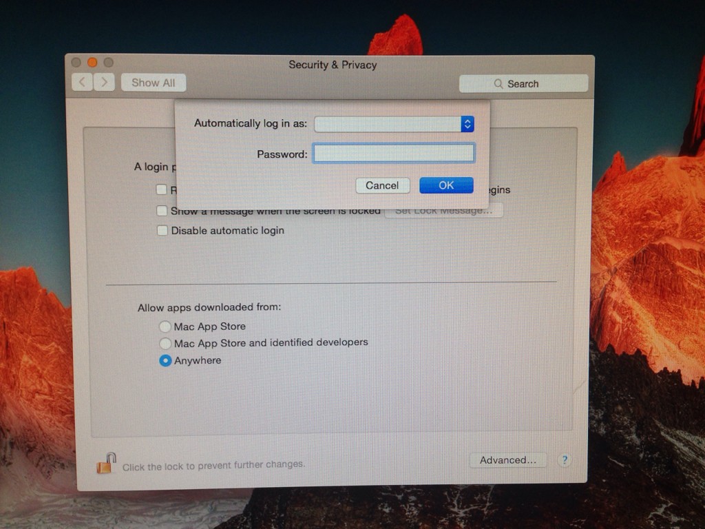

Pavo Posted July 10, 2014 Share Posted July 10, 2014 Reinstall the update? Mine failed as well and I just booted up again and ran it one more time, worked like a charm. **************************************************** I'm also curious if anyone else is not able to turn on Automatic Login for the main account? It will let me enable it for a Guest User, but not for my main user. Can anyone else confirm this or is it just me? My main account is setup with auto login and everything is working fine, I don't have the Guest account Link to comment https://www.insanelymac.com/forum/topic/298402-os-x-yosemite-dps-builds/page/51/#findComment-2039158 Share on other sites More sharing options...
ADHDMedia Posted July 10, 2014 Share Posted July 10, 2014 Ya I can't figure out why it won't let me enable Auto Login. I went into security and check this out, there's no account. Can't enable from login options either. ***EDIT*** Hey, just figured it out! If anyone else has this issue, it's because I was logging into OSX using my iCloud password. I went in and changed it to a 'Separate Password' and the 'Automatic Login' option immediately opened up. NO idea why these two settings would affect each other, but it is what it is. Fixed it now lol Link to comment https://www.insanelymac.com/forum/topic/298402-os-x-yosemite-dps-builds/page/51/#findComment-2039169 Share on other sites More sharing options...
Pavo Posted July 11, 2014 Share Posted July 11, 2014 Ya I can't figure out why it won't let me enable Auto Login. I went into security and check this out, there's no account. ImageUploadedByTapatalk1405032354.179452.jpg Can't enable from login options either. ***EDIT*** Hey, just figured it out! If anyone else has this issue, it's because I was logging into OSX using my iCloud password. I went in and changed it to a 'Separate Password' and the 'Automatic Login' option immediately opened up. NO idea why these two settings would affect each other, but it is what it is. Fixed it now lol You are in the wrong section. https://www.dropbox.com/s/zoxoa5dfca5318v/Screenshot%202014-07-10%2020.04.18.png Link to comment https://www.insanelymac.com/forum/topic/298402-os-x-yosemite-dps-builds/page/51/#findComment-2039193 Share on other sites More sharing options...
