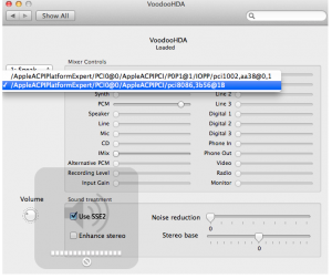

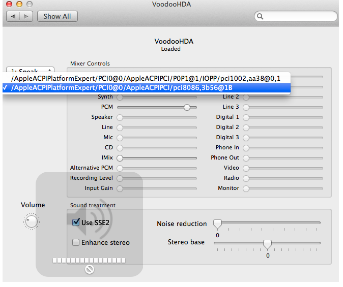

I had the same device working on Lion with VoodooHDA 2.7.2, But in Mavericks i get this. (Attached screenshot)
I also injected my Device and Vendor ID inside Info.plist still nothing. Also here is my Info.plist text

Thanks in advance. :thumbsup_anim:
EDIT : I got it working i had
<key>IOPCIPrimaryMatch</key>
<string>0x80863B56</string>
wrong. It should have been like
<string>0x3B568086</string>
