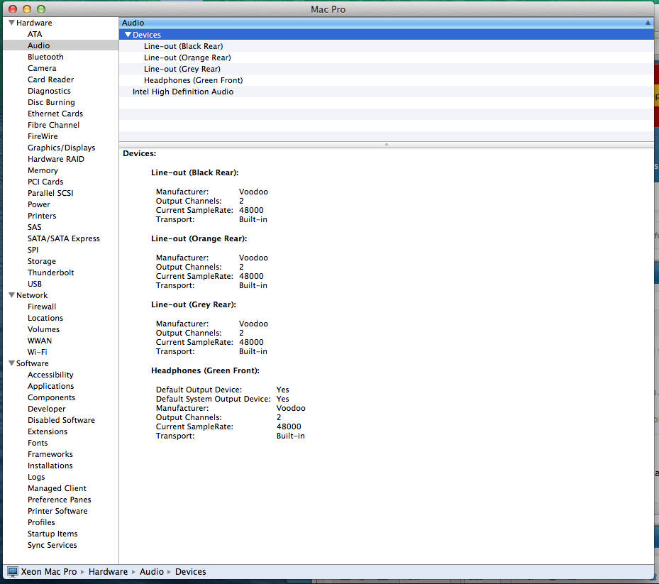

Thanks so much!   This is much better, but still a few things;
The 4 output jacks on the rear work great (green, black, orange and grey).  The front headphone jack (green) is a no-go, though as is the front microphone jack (pink).  The rear microphone jack seems to be looping back to the rear green output.
I can live with these if I have to, but I'd like to be able to use a headset for Skype and Webex conference calls, if possible.   I guess I could use a USB audio device just for that, though.

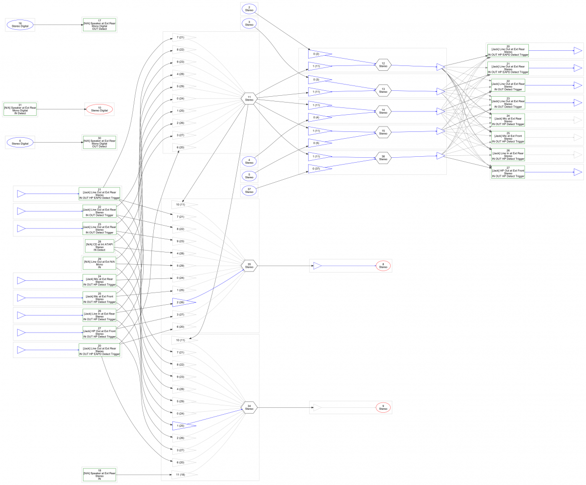

It looks like this is the config when forcing nodes 24 and 26 to be line outs instead of line/mic ins:
Node 26 (blue rear) acts as a headphone for node 21 (speaker). When 26 is plugged in, 21 should then be disabled
Node 20 is independent (nothing linked to it)
Node 27 (green front hp) acts as a headphone for node 24 (pink rear). When 27 is plugged in, 24 should then be disabled.
Is this the behavior you're getting? You'd probably be better off not forcing nodes 24 and 26 to be line outs (unless you decided to try patching AppleHDA instead).

Ok, the outputs should all be good with this one. The inputs are a bit more tricky however.
There are three input pin complexes, yet only 2 input nodes. I tried setting up the line in for one of the nodes and the 2 mics on the other. The front mic should act like a headphone for the back one so plugging the front one should disable the back one. Try this and attach another voodoo dump to see if it works right

How about line in? I've attached your codec dump converted to decimal for voodooHDA. As you can see in it, all three inputs prefer the same node as the first line out (node 20). This is your codec graph also in decimal:
It's most confusing because the input nodes are almost like output ones.
Try this one. I associated the inputs with node 20 since they prefer to follow it's path. See what happens and post the voodoo dump too please :)

This makes sense, I forgot that you have to trace inputs the opposite of outputs (from the input node, not pin complex) and since I paired inputs and outputs in the same association, voodoo just disabled the whole association.
I got 3 ideas here:
The first one is to associate the inputs together and see what happens.
The second one is the same as the first but I noticed that the amp in values for node 9 was different than 8 (9 was the same as everything else while 8 was different). So I routed the inputs all to node 9.
The third one is the same as two but I associated the headphones with node 20 (primary line out).

 Whoops, I messed up the connections in the info.plist so there wasn't any actual change in the inputs. Try this, I changed the green back line out to a speaker so the headphones should disable it when plugged in. If this doesn't work, try toledo's patched AppleHDA for your codec: https://github.com/toleda/audio_ALC888
