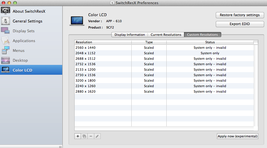

Hi,
My laptop lcd display has a resolution of 1920x1080 and can do 960x540 hidpi mode. Any higher resolution setting in Overrider display folder shows Invalid. I am trying to get the system to accept 1280x720 HIDPI mode (2560x1440 scaled resolution). Using FixEDID I was able to change VendorID and ProductID, but scaled resolution is still the same as before, no 1280x720 hi dpi mode. How can I fix this?
Thanks for your help.
Edit: Problem solved!
This is due to graphics driver. My graphics card is HD3000 and original driver from Apple does not permit higher scaled resolutions. Download modified kext from hackintosh site, install to the laptop and now all high resolutions are available including hidpi.
Anyone having problem of "System Only - Invalid?" with SwitchResX may use modified graphics drivers to get HiDPI working.
