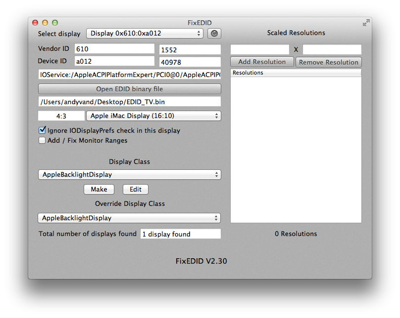

Okay Andy, here is some Feedback :-)
1. If you use 16:9 Display and you want a 16:9 HiDPI Resolution, it won't work with 16:10 Displays like:
--- Apple iMac Display, Apple MacBook Pro Display, Apple Cinema HD Display or Apple Led Cinema Display!
--- Only "Apple Thunderbold Display" is a 16:9 Display, but this won't work with Built-In Display because you get "Stripes/Wrong Color" Errors!
2. Only "Only Eject EDID Unpatched" working for 16:9 HiDPI Resolution!

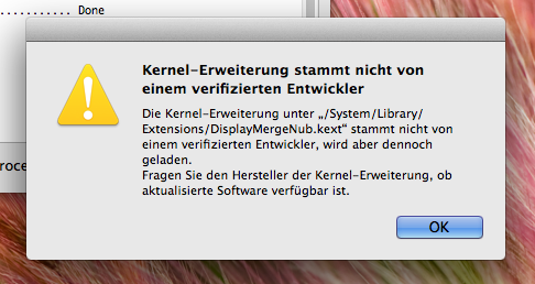

3. You asked you signed the Kext with Developer Account... but see at the (Attached) Picture... The message is still here...
4. Everything else is fine :-) Just ask the ppls, the should add 3200x1800 for a 1600x900 HiDPI Resolution... (x2)
PS: 5. Andy, please ask the Users, that they can Activate HiDPI Resolutions, after they put the Override Files in the right place only with this tool:
https://github.com/Ramalama2/UX301_DSDT/blob/master/5.%20Tools/Apps/RetinaDisplayMenu.zip
The hiDPI resolutions are not listed in System --> Display settings :-)
Thank you Andy :-)

1. I added this info to the help... also added color profile only patch
2. Now you can also use color profile only patch, info also in the help
3. This is probably due to the custom Info.plist... no fix yet
4. Remove button added for resolutions
5. App uploaded too...

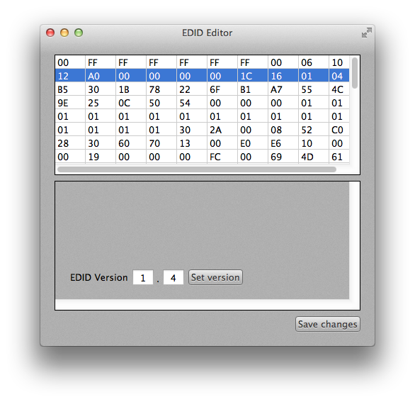

I started coding the new feature.
Advanced EDID editing.
So far I have hex editing the EDID working and I have implemented the view for version editing.
A lot more views will follow.
It also already auto-corrects the checksum of every EDID block so far on a click of the save button.
More to follow...
Sneak preview of version 2.4.0 (pre-beta).
Note the new 'Edit" button.
When you click that you get the EDID Editor in a new window...
More to follow. :D
The version editor you see in the screenshot is toggled by clicking offset 18 or 19 (row 1, column 8 or 9).
The views in the scrollbar (NSScrollView) part will be auto-toggled by clicking a certain value in the data table.
Double clicking a value will allow hex edit... ;)

The new editor will make that crystal clear.
Whenever you click a value it will show you the easy way to edit.
The advanced hex edit is for advanced users...
