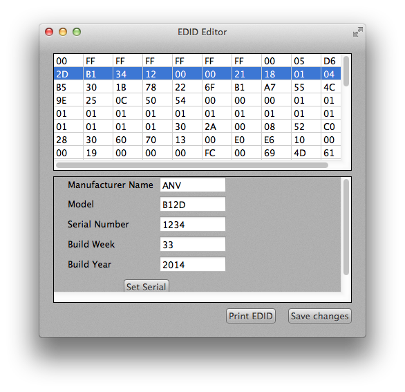

Andy Vandijck Posted April 24, 2014 Author Share Posted April 24, 2014 I started coding the serial value editor. So far it fetches the 3B manufacturer name, the model number in hex and the serial number. Still todo: fetching the build week and year from the serial block and procedure to set new values. EDIT: got a little further. It now fetches every value of the serial block and is capable of setting the 3B manufacturer name. Still needs a bit of work in case a too short name is put in but when that is done it will quickly be capable of setting the entire serial block (all 10B of it). Coding continues later today. Then it will be capable of editing the first 20B (bytes 0-19 will have editors). Then I need to code panel identifications (digital and analog, separate editors for each) Link to comment Share on other sites More sharing options...

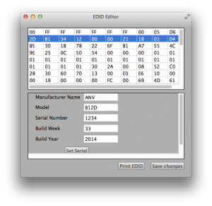

Andy Vandijck Posted April 25, 2014 Author Share Posted April 25, 2014 I finished the serial data editor. Now the first 2 lines of the EDID (20B, 0-19) can be edited. I attached the current result, alpha 2. Screenshot is also there... I also made the manufacturer name idiot proof, if somebody only wants to set 1B or 2B of the name, it will pad the other 2 or 1 characters with '@' (00 in those 5 bits). I also upgraded the hex2int routine to also work with uppercase characters (for both FixEDID itself as well as the editor) EDIT: Removed download due to alpha 3 below 1 Link to comment Share on other sites More sharing options...

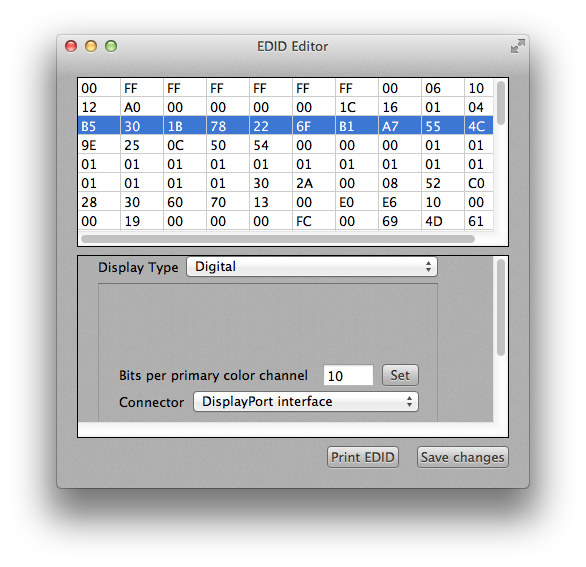

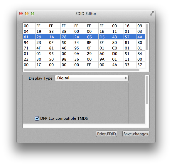

Andy Vandijck Posted April 25, 2014 Author Share Posted April 25, 2014 I started coding the Basic Parameters editor. These 5B control the display type and stuff... So far it switches between digital and analog. Lots more to do... EDIT: added the Digital Panel EDID 1.4 view. So far it fetches the bits per primary color channel and I'm going to add the panel type selector. Work continues... Link to comment Share on other sites More sharing options...

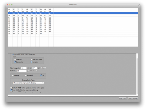

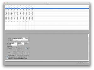

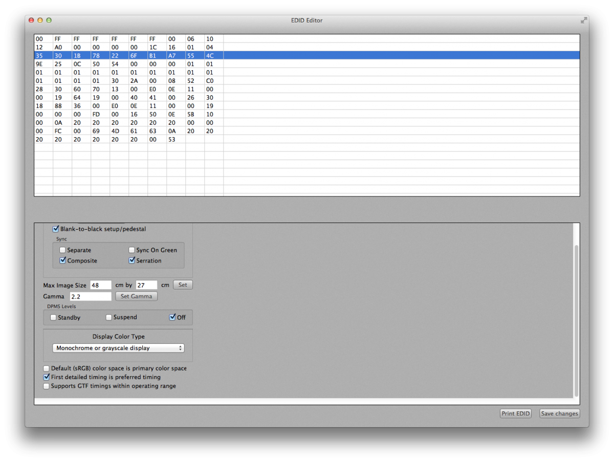

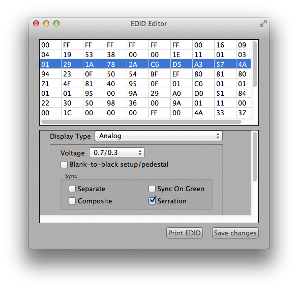

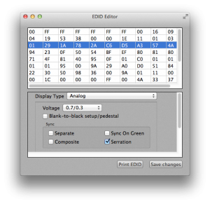

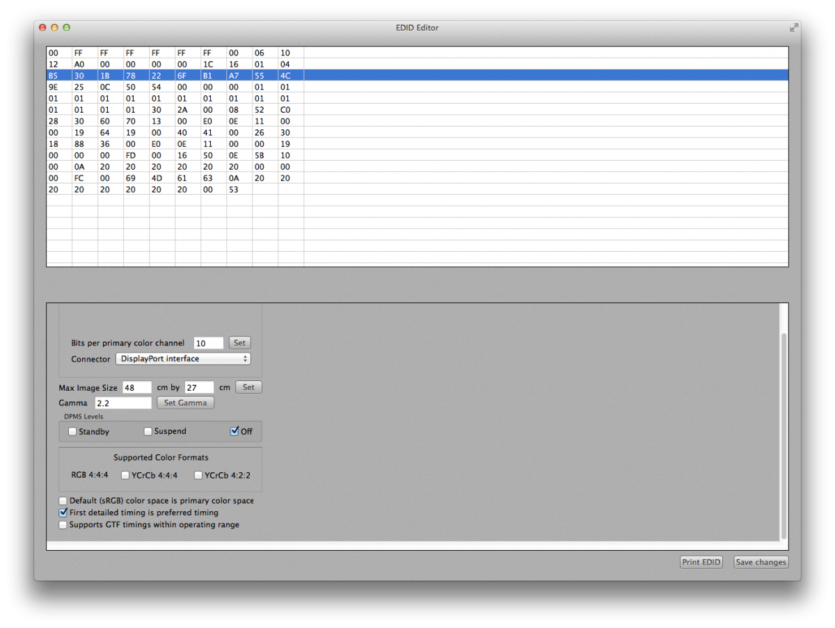

Andy Vandijck Posted April 25, 2014 Author Share Posted April 25, 2014 The editor for the panel type is implemented.This allows setting paramaters (both analog and digital).This also depends on EDID version for digital panels.EDID >= 1.4: full digital editorEDID >= 1.2: DFP settingEDID < 1.2: no digital settingsGonna take a small break and the continue the work... EDIT: Some pictures of the new basic params edtor so far... At current it can manipulate the first byte (out of 5). This was the hardest... The rest will follow... 1 Link to comment Share on other sites More sharing options...
Andy Vandijck Posted April 26, 2014 Author Share Posted April 26, 2014 I finished the basic parameters editor (bytes 20-24). It's fully implemented, new view example in screenshots. alpha 3 is now available... Next up is the chroma info... (tomorrow)... So far bytes 0-24 have got advanced editors These 5 bytes where a lot of work but are fine now... EDIT: Alpha 3 removed due to alpha 4 below 1 Link to comment Share on other sites More sharing options...

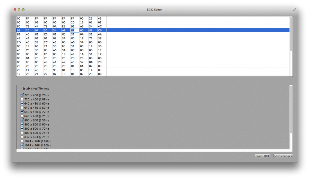

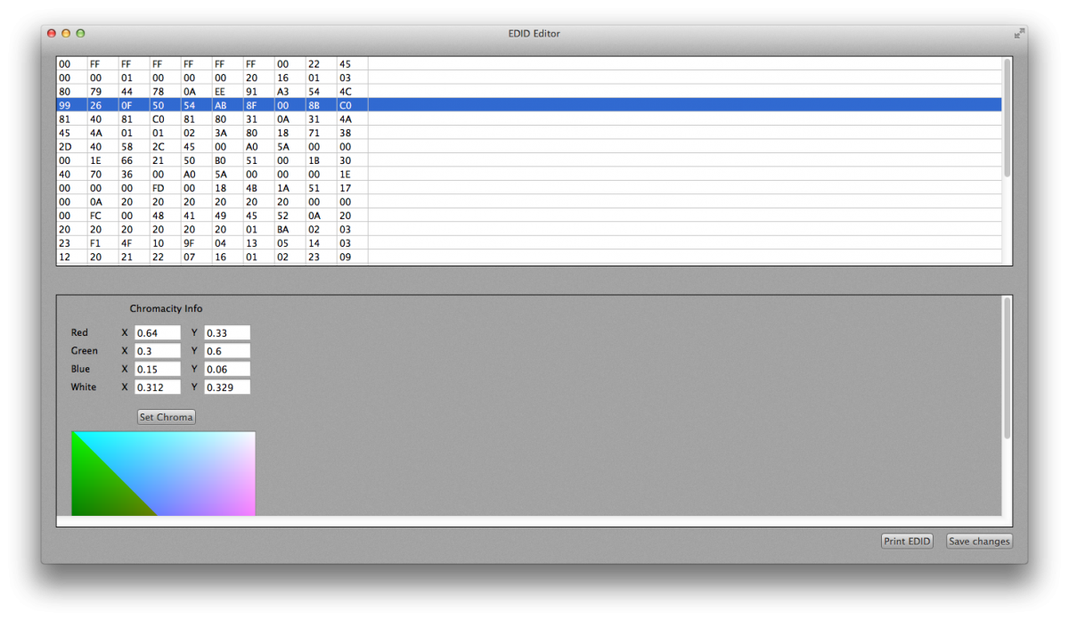

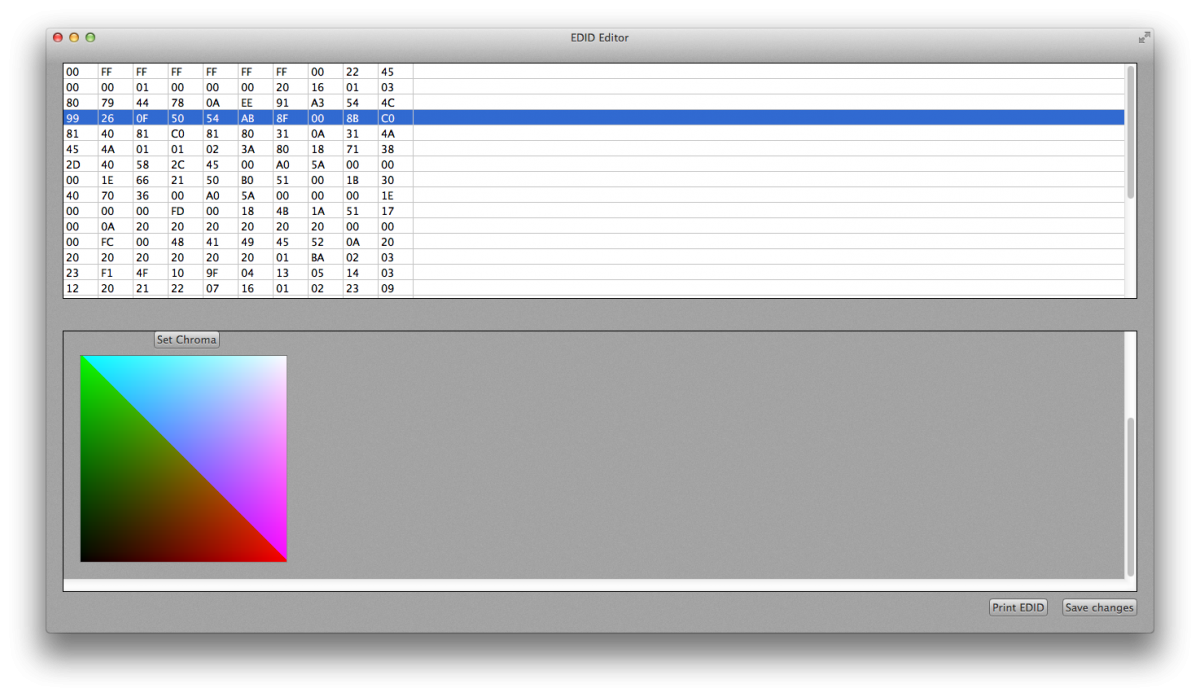

Andy Vandijck Posted April 28, 2014 Author Share Posted April 28, 2014 I finished the next phase. I implemented the chromacity info viewer and editor (red, green, blue, specified in X Y coordinates). I had very little info on this but I managed to do it right. It also shows a display color test... this is based on RGB values implemented in an NSView directly... I also implemented the Established Timings editor (standard resolutions as defined by VESA EDID 1.4 standard). Screenshots and downloads below... Next up: detailed timings and then detailed descriptor blocks (the most work, but if this is done most of it is implemented). Enjoy... EDIT: Removed alpha 4 because of alpha 5 below... 3 Link to comment Share on other sites More sharing options...

Andy Vandijck Posted May 2, 2014 Author Share Posted May 2, 2014 Ok. For today I managed to implement reading the standard timings. Tomorrow evening the reverse operation... Setting resolutions. Once this is done alpha 5 is out. 1 Link to comment Share on other sites More sharing options...

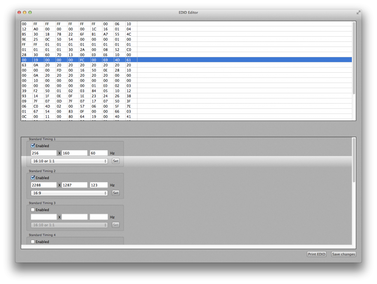

Andy Vandijck Posted May 3, 2014 Author Share Posted May 3, 2014 I finished the standard timings editor view... Minimum and maximum values are shown below... To make a standard timing first enable the entry, then set the horizontal resolution, select the aspect ratio and click set. Now it will also determine the vertical resolution and set the data Tomorrow the detailed descriptors (lots of work)... Enjoy alpha 5 Bytes 0-53 are now editable... EDIT: Removed alpha 5 due to alpha 6 below... 1 Link to comment Share on other sites More sharing options...
Ramalama Posted May 3, 2014 Share Posted May 3, 2014 Can you adjust the limit to 3840? (I need it for HiDPI) Because 2288 is not high enough for me :-) Cheers :-) Link to comment Share on other sites More sharing options...
