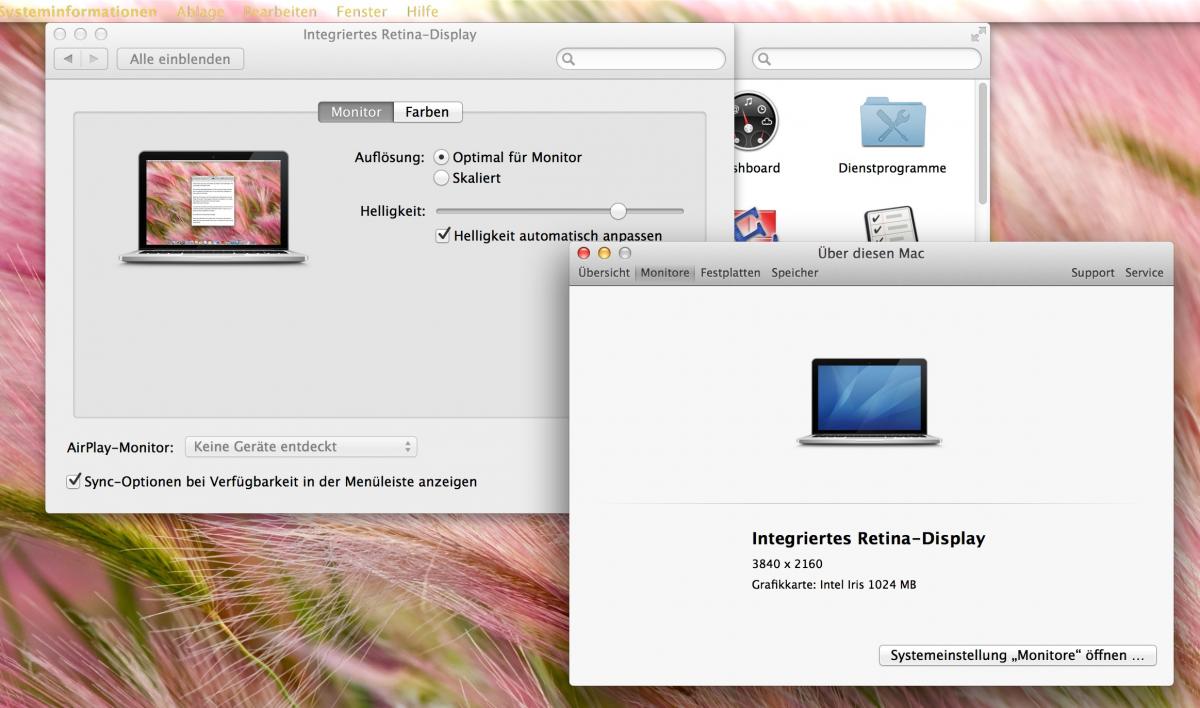

Can you adjust the limit to 3840? (I need it for HiDPI)
Because 2288 is not high enough for me :-)
Cheers :-)

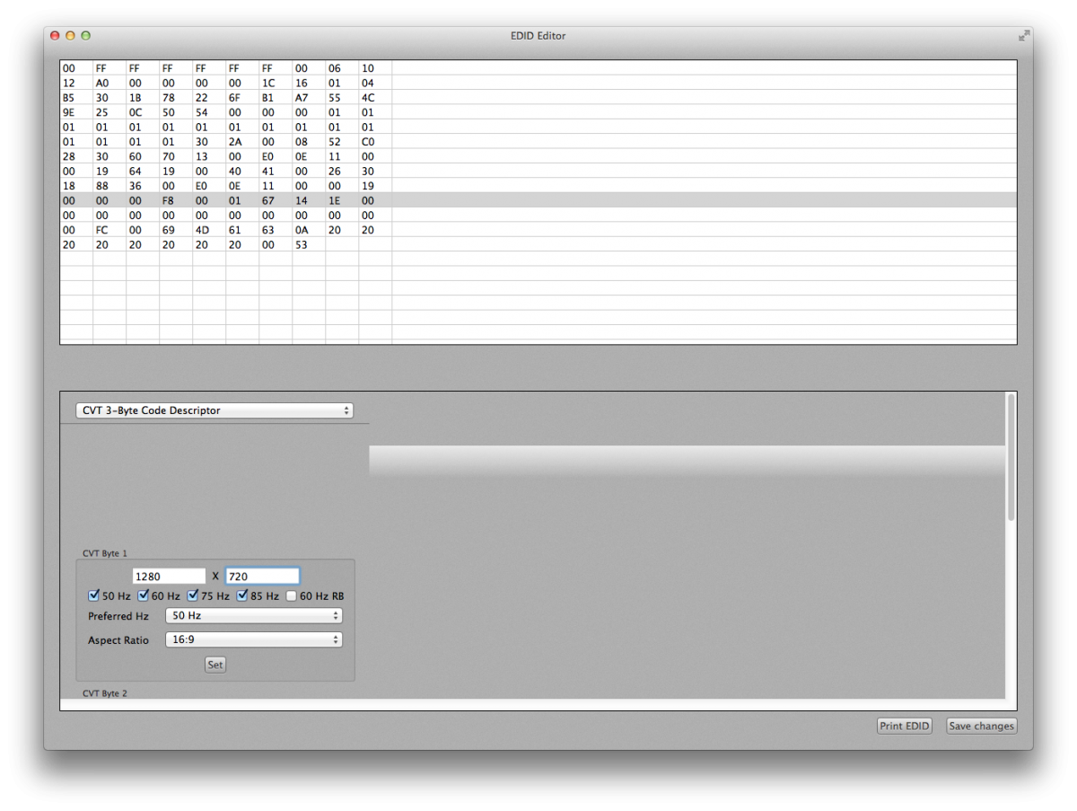

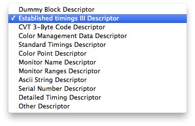

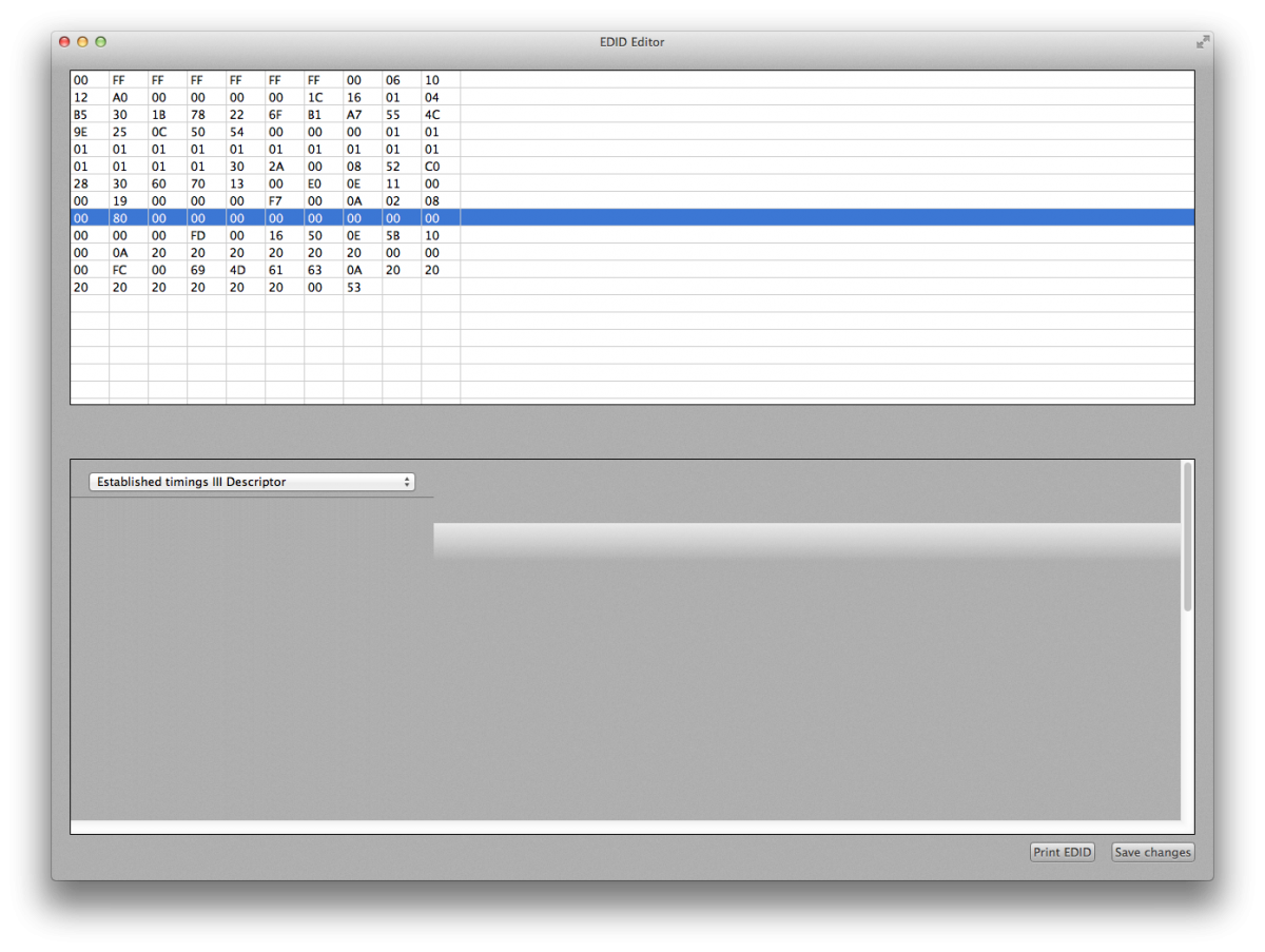

I found some time today to start coding the 12 detailed views.
So far I implemented the list with detailed descriptors, these get identified upon a click of the detailed descriptor in question.
Clicking in that list on another type of descriptor will initialise it as an empty descriptor of that type.
This already works.
I also started coding the view for the established timings III.
So far it has views for dummy block and established timings III.
More work to follow... :D

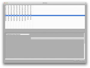

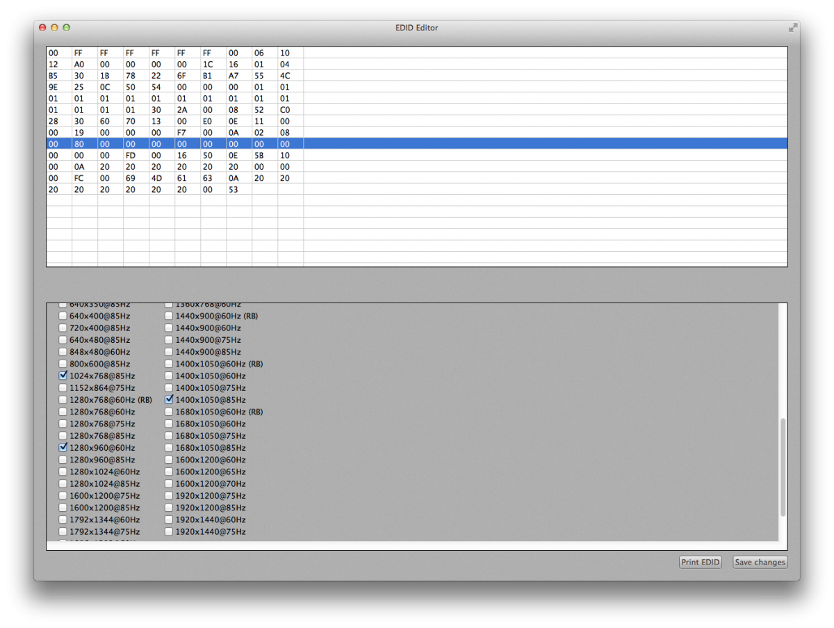

I finished the code for established timings III.
Alpha 6!
It can already do everything mentioned previously and set established timings III.
Tomorrow works continues when I have the time (CVT is next)...
Screenshots attached too and alpha 6 too...
For those thinking the implementation was easy: look at the code... 44 checkboxes linked through for the desired result...
The detailed descriptors are till byte 125 from byte 54...
EDIT: Removed alpha 6 due to alpha 7 below...

I'm currently coding the CVT 3B descriptors (4 of them in the descriptor).
So far reading works...
Gonna write setting them now...
CVT 3B descriptors can now be set...
You do it like this:
Enter vertical resolution, select refresh rates, select preferred refresh rate, select aspect ratio and click set.
You can set up to 4 resolutions in 1 CVT block...
Example shown in screenshot...
Alpha 7 is ready... the rest I can do tomorrow or sunday... (when I have the time)
It wasn't easy implementing this but it is done now :D
FixEDID-2.4.0-alpha7.zip

Andy? Do you know, how i can calculate Pixel Clock?
I Changed Active Horzontal to 3840 (from 2560) and vertical to 2160 (from 1440)...
But it seems that i need todo more, because i get stripes and pixel bugs... :-)
But with the new "Buggy" EDID, i get Retina-Display, with all the nice Switches :-)
Attached :-)
Attached :-)
It has something to do with the number of lines and stuff.
Look for EEDIDrAr2.pdf on Google.
This contains all the needed info.
