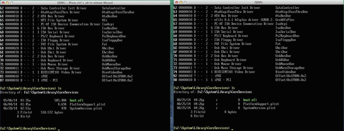

Assert can happen in FreePool if you pass it something that is not allocated with AllocatePool. For example: possible issue in grub_driver.c, GetFSGuid(): FreePool(FsName).
Thanks dmazar.
Indeed that is one issue.
Another issue is in driver.c, FreeFsInstance(): FreePool(Instance->RootFile). That one assets also for FreePool on EFI_INVALID_PARAMETER.
You should probably just comment that line - I do no see this one allocated.
Regarding FreeFsInstance(), I think that RootFile is being allocated by grub_file.c, GrubCreateFile(). The assert is because it tries to free it without checking it if its value is NULL, so it may end up trying to FreePool(NULL). I think we should just add checks for non-NULL values in FreeFsInstance(), for both DevicePathString and RootFile, as I see in the code cases where FreeFsInstance() may be called without any of these being allocated.
Anyway, with the above checks added, and commenting out the FreePool which you mentioned (which is not being allocated, so there's no reason to free it), there seem to be no more asserts.
Now to some testing of the Grub HfsPlus driver:
Unfortunately, for media created by 'createinstallmedia' the situation is similar to VboxHfs, so it also doesn't handle hfs hard links properly. It seems to support symlinks though (which VBoxHfs does not), but this doesn't really help us.
