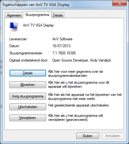

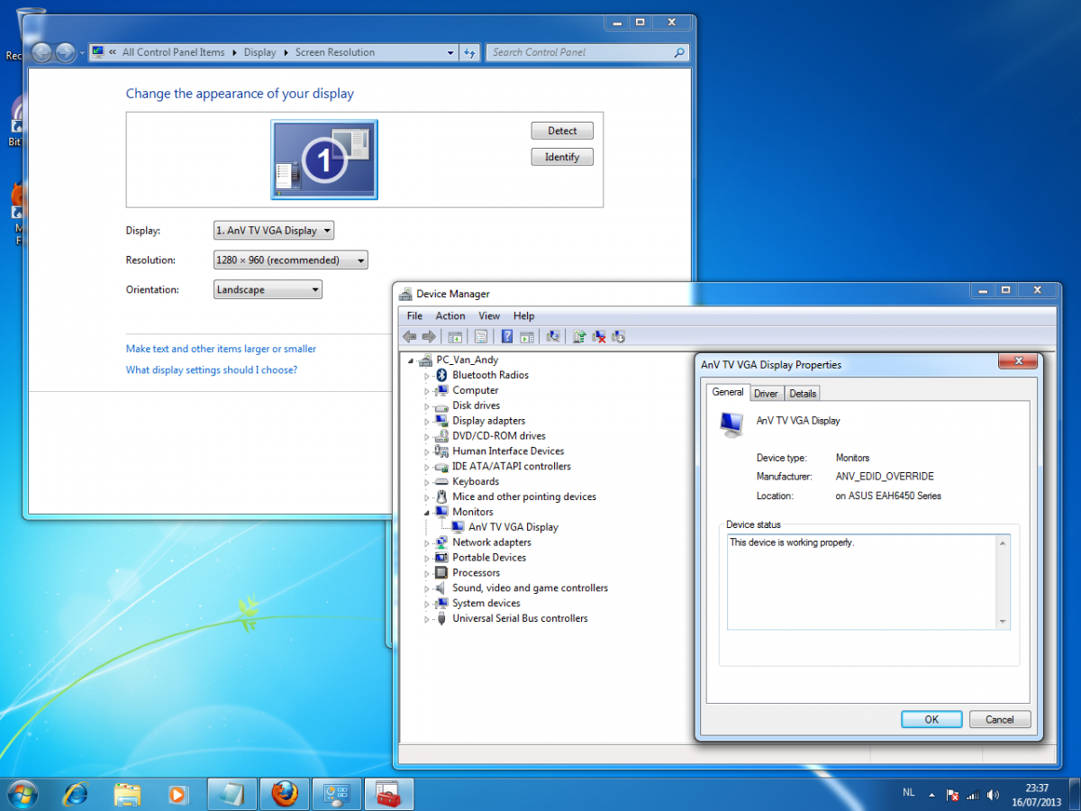

Andy Vandijck Posted July 16, 2013 Author Share Posted July 16, 2013 I made a Windows driver that can override the EDID of a non-plug and play monitor. I use it to give Windows an EDID of my VGA connector of my TV. By default it sets the EDID of a TV with a resolution of 1280x960. You can edit the EDID inside the .inf file by editing this: [ANV_EDID_OVERRIDE-1_AddReg] HKR,EDID_OVERRIDE,"0",0x01,0x00,0xFF,0xFF,0xFF,0xFF,0xFF,0xFF,0x00,0x06,0x10,0x12,0xA0,0x00,0x00,0x00,0x00,0x1C,0x16,0x01,0x04,0xB5,0x30,0x1B,0x78,0x22,0x6F,0xB1,0xA7,0x55,0x4C,0x9E,0x25,0x0C,0x50,0x54,0x00,0x00,0x00,0x01,0x01,0x01,0x01,0x01,0x01,0x01,0x01,0x01,0x01,0x01,0x01,0x01,0x01,0x01,0x01,0x30,0x2A,0x00,0x08,0x52,0xC0,0x28,0x30,0x60,0x70,0x13,0x00,0xE0,0xE6,0x10,0x00,0x00,0x19,0x64,0x19,0x00,0x40,0x41,0x00,0x26,0x30,0x18,0x88,0x36,0x00,0xE0,0xE6,0x10,0x00,0x00,0x19,0x00,0x00,0x00,0xFD,0x00,0x16,0x50,0x0E,0x5B,0x10,0x00,0x0A,0x20,0x20,0x20,0x20,0x20,0x20,0x00,0x00,0x00,0xFC,0x00,0x69,0x4D,0x61,0x63,0x0A,0x20,0x20,0x20,0x20,0x20,0x20,0x20,0x20,0x00,0xA5 NOTE: The EDID is preseeded by "0",0x01,... You can modify the resolution in this are: [1024] HKR,,MaxResolution,,"1024,768" [1280] HKR,,MaxResolution,,"1280,960" And this gets put here: AddReg=ANV_EDID_OVERRIDE-1.AddReg, 1024, 1280, DPMS Note that the EDID first has a 0x01 before the EDID data.If you edit the driver inf, change this: CatalogFile=anvdisplay.cat To this: ; CatalogFile=anvdisplay.cat You can then install the driver after a save (change driver of your Monitor that is non-plug and play).Enjoy... Tested on Windows 7, should work on better too... EDIT: New version (V2) This one has 2 drivers (1600x1200 and 1280x960) I fixed sync issue causing the image to not always stand on the right place. I fixed driver params for horizontal and vertical resolution. Now there is a perfect way to get an EDID in Windows with TV's connected through VGA. The newest version (V2 signed) has got a Certum correct code signature. Now it doesn't say it can't verify the signature after install of the public certs provided along. Enjoy... EDIT: If anybody wants an EDID override for Windows for a plug-and-play monitor, contact me and I'll make one. AnV_Windows_TV_EDID_Driver_V2_signed.zip Link to comment https://www.insanelymac.com/forum/topic/294634-different-solutions/page/12/#findComment-1932688 Share on other sites More sharing options...
