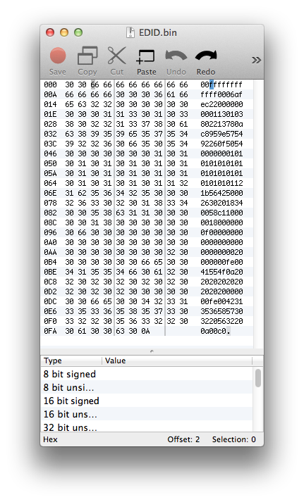

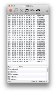

artur_pt Posted June 24, 2013 Share Posted June 24, 2013 hello Andy when i try to open the edid.bin file extracted with darwin dumper it give me incorrect file header EDID.bin.zip thanks Link to comment https://www.insanelymac.com/forum/topic/294634-different-solutions/page/7/#findComment-1927471 Share on other sites More sharing options...
Andy Vandijck Posted June 24, 2013 Author Share Posted June 24, 2013 hello Andy when i try to open the edid.bin file extracted with darwin dumper it give me incorrect file header EDID.bin.zip thanks hello Andy when i try to open the edid.bin file extracted with darwin dumper it give me incorrect file header EDID.bin.zip thanks Take a peek at the screenshot.It's hex data, not EDID binary Try the attached one (I used a hex editor to put it right - damn... thought it put it in binary). So extra step needed... copy in 0xED the right parts to the left parts and save it up... EDIT: This terminal command can be used to convert it: xxd -r -p EDID.bin > EDID.hex Then opening the EDID.hex Didn't know DarwinDumper didn't use flat binary format... doh... lol EDIT2: DarwinDumper 2.7.6 will also be able to dump EDID in binary format. Thanks Blackosx... EDID_Correct.bin.zip Link to comment https://www.insanelymac.com/forum/topic/294634-different-solutions/page/7/#findComment-1927472 Share on other sites More sharing options...

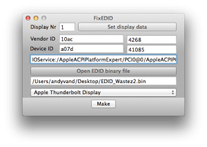

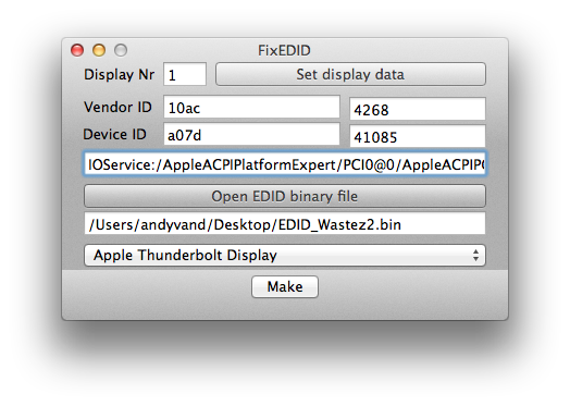

wastez Posted June 25, 2013 Share Posted June 25, 2013 If you mean ioclass it´s AppleDisplay Some things are not integrated in the EDID of this display. (Serialnumber for example) Could this cause the problem? EDIT: Seems IOClass is wrong in the kext, it is AppleUSBMergeNub Link to comment https://www.insanelymac.com/forum/topic/294634-different-solutions/page/7/#findComment-1927625 Share on other sites More sharing options...
Andy Vandijck Posted June 25, 2013 Author Share Posted June 25, 2013 If you mean ioclass it´s AppleDisplay Some things are not integrated in the EDID of this display. (Serialnumber for example) Could this cause the problem? EDIT: Seems IOClass is wrong in the kext, it is AppleUSBMergeNub IOClass is the injector (AppleUSBMergeNub). IOProviderClass is the class it matches on (AppleDisplay). I fixed up the kext for both your displays. So other people: Here is an example of 2 displays injection. I also took the liberty of correcting your internal EDID a bit more (monitor range info for example). Both are now EDID 1.4 Remove the display override and install the kext, correct the ownership and permissions, remove the kernelcache and Extensions.mkext and reboot. It should work now for both your displays (the Dell one becomes Thunderbolt display and the internal one MacBook Color LCD). Let me know I manually put the parameters in the app (this is possible too) for adding the Thunderbolt display info... (see screenshot) Monitor_Apple_Wastez_2displays.kext.zip Link to comment https://www.insanelymac.com/forum/topic/294634-different-solutions/page/7/#findComment-1927653 Share on other sites More sharing options...
