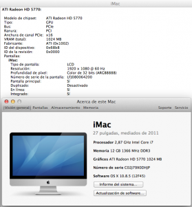

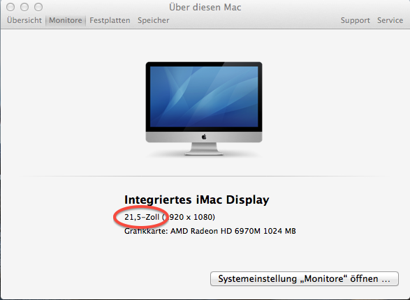

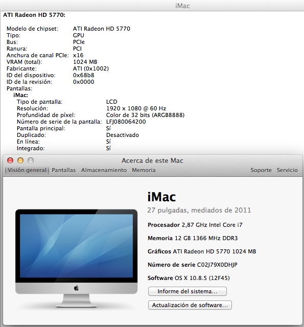

Give me the patched EDID for that monitor please.
I'll check it this evening.
EDIT: Oh... you uploaded it.
It was a very bad EDID.
It had 3 times monitor name string (3x 00 00 00 FC entry).
It had no monitor range limits inside.
I corrected it to conform to EDID 1.4 totally.
Try it and let me know.
