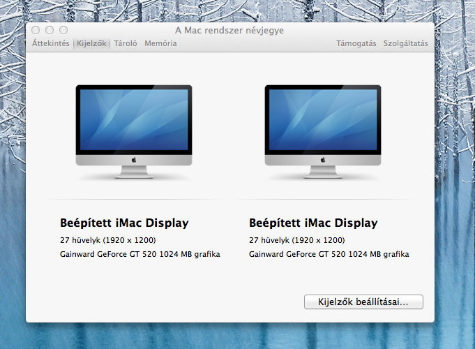

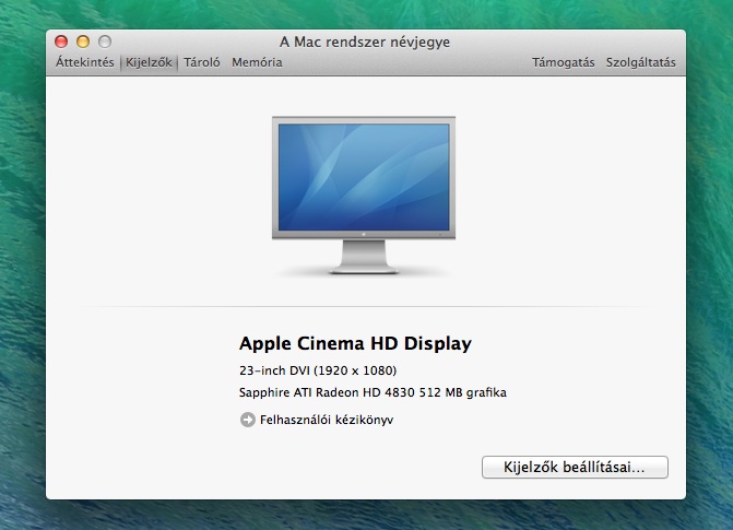

Could someone tell the Cinema HD Display 23' productID? Or how could I get it?
I know this is just a small thing but it says that I have a 30' display... But in real I have a 22-23' display. It would be nice to match the cols... So if I would change the product id in the DisplayMergeNub.kext to the 23 col model, then it would say the correct (23) cols... (I think).
Can somebody help me with that productID?
Nevermind, found it with google, the 23" version product id is: 37404  :)
edit: nicely working with that ID, note 23 inch:

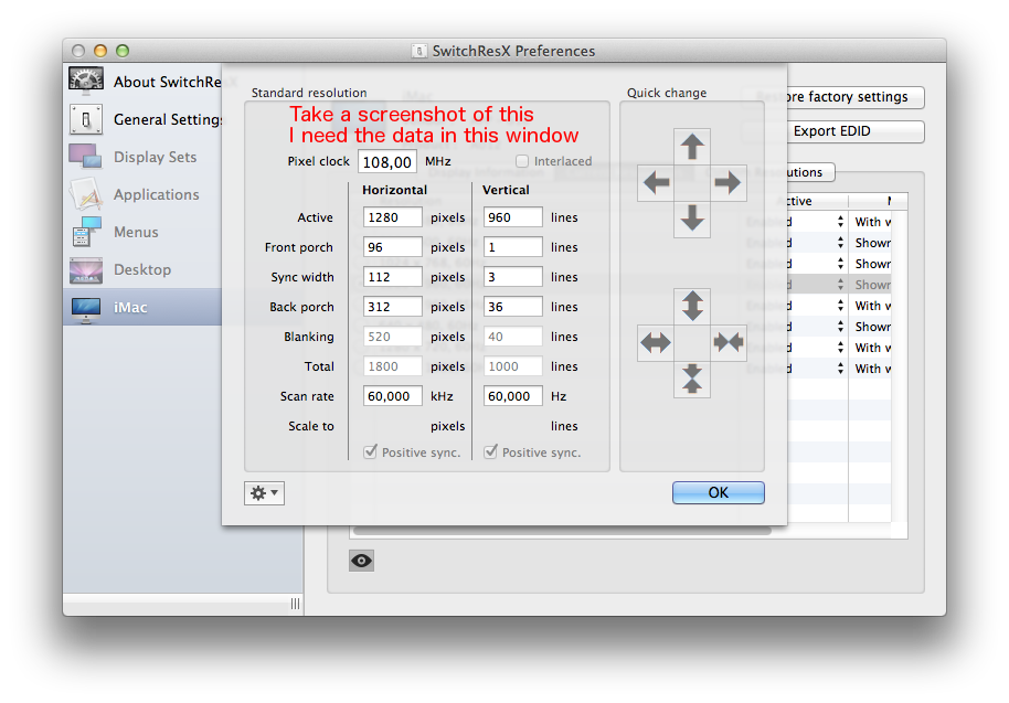

I'm gonna upload something to determine the parameters.

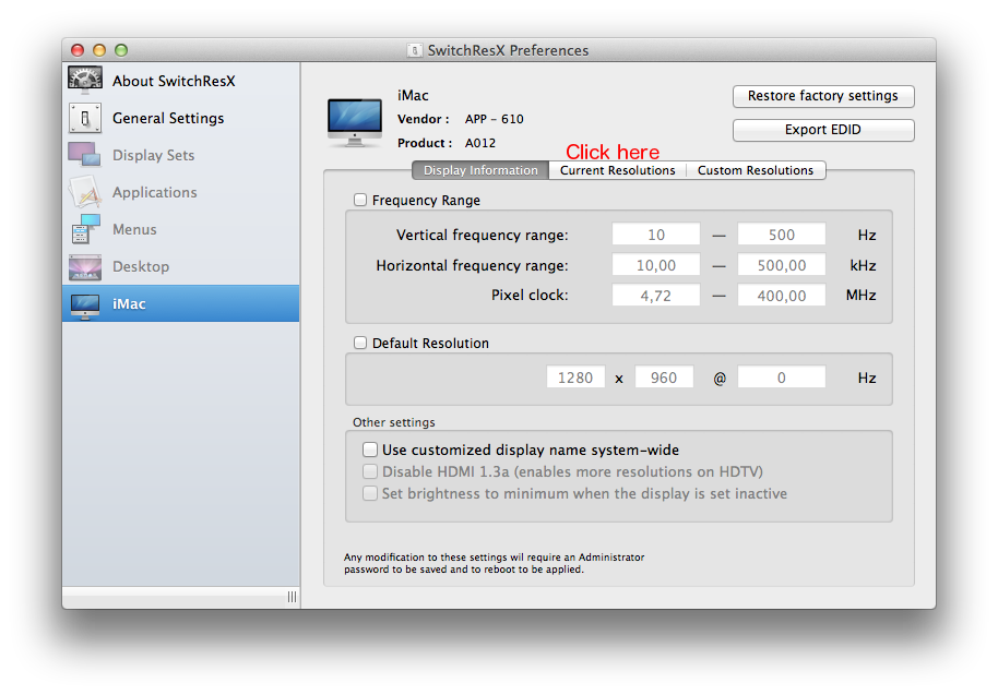

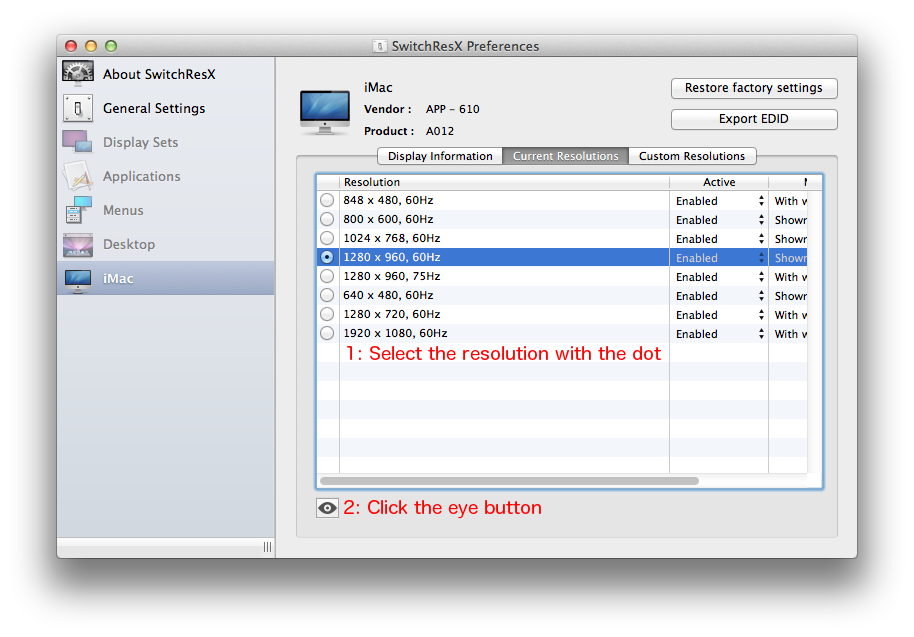

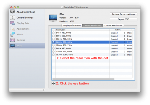

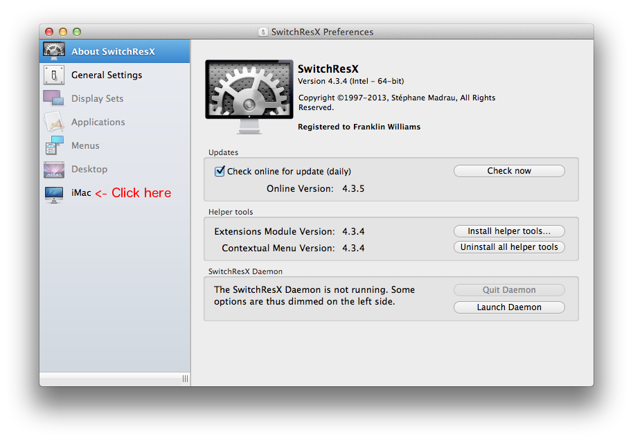

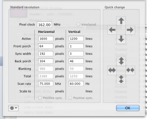

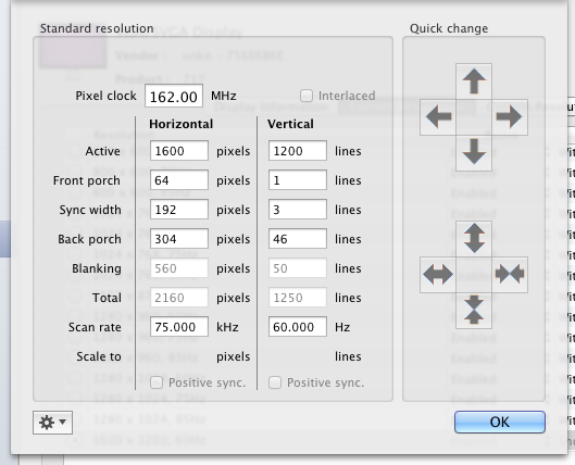

@Shane: download this
https://www.dropbox.com/s/7ktc5v3f8k745yp/SwitchResX%204.3.4.zip
Install it and enter the serial number.
Follow the following tutorial in the images below and give me the screenshot.
Ok got it. Now to work
I crafted the new EDID based on the screenshot you provided me.
It has 1 resolution: 1600x1200@75 like in the screenshot.
I also corrected the maximum dot clock to 170Mhz (resolution uses dotclock at 162Mhz).
Test it and please let me know
EDID_Shane2.zip

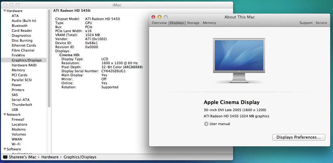

Worked great thanks a lot Andy. Only thing is it says its a 30-inch not a 32-inch but its not a problem.
I recommend using the LED cinema display.
It sets the display icon right.

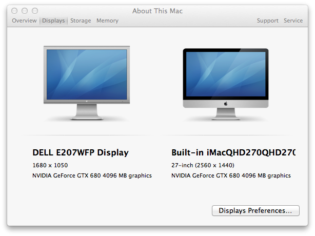

Thx for great app!
any way to fix my name of display?
also how do you make kext for 2 displays at the same time?
By copying the 1st generated kext to e.g. documents.
Regenerate the kext for the 2nd display with the 2nd EDID.
Next merge both IOKitPersonalities entries in the Info.plist files with a plist editor and install the kext.
It now works for both.
