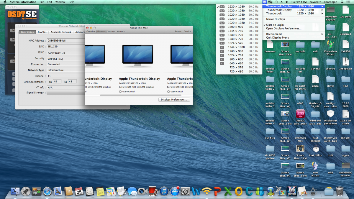

Luminadevapps Posted June 25, 2013 Share Posted June 25, 2013 with or without kext displayoverride worked. may be kext not worked 4 me Because 3 display I try like this <key>IOProviderMergeProperties</key> <dict> <key>AppleDisplayType</key> <integer>1</integer> <key>AppleSense</key> <integer>36864</integer> <key>DisplayProductID</key> <integer>37426</integer> <key>DisplayVendorID</key> <integer>1552</integer> <key>IODisplayConnectFlags</key> <data> xEEAAA== </data> <key>IODisplayEDID</key> <data> AP///////wAGEDKSfJ8AAioQAQOAPCJ4Kv6Ho1dKnCUT UFQjCACBgIFAgQCVALMAAQEBAQEBAjqAGHE4LUBYLEUA VlAhAAAeAAAA/wBDWTY0MjBaNlVHMQoAAAAA/QAYSxpR FwAKICAgICAgAAAA/ABDaW5lbWEgSEQKAAAAAUICAyjx SZAfBBMFFAMSICMJBweDAQAA4gAPbgMMABAAAC0gkAQI EBgQAR0AclHQHiBuKFUAVlAhAAAeAR0AvFLQHiC4KFVA VlAhAAAeAR2AGHEcFiBYLCUAVlAhAACeAR2A0HIcFiAQ LCWAVlAhAACeAAAAAAAAAAAAAAAAAAAA1g== </data> <key>IODisplayPrefsKey</key> <string>IOService:/AppleACPIPlatformExpert/PCI0@0/AppleACPIPCI/PEGP@3/IOPCI2PCIBridge/GFX0@0/NVDA,Display-A@0/NVDA/display0/AppleDisplay-610-9232</string> </dict> <key>IOProviderMergeProperties 2</key> <dict> <key>AppleDisplayType</key> <integer>2</integer> <key>DisplayProductID</key> <integer>37415</integer> <key>DisplaySerialNumber</key> <integer>371392543</integer> <key>DisplayVendorID</key> <integer>1552</integer> <key>IODisplayCapabilityString</key> <data> cHJvdChtb25pdG9yKSB0eXBlKExDRCkgbW9kZWwoVGh1 bmRlcmJvbHQgRGlzcGxheSkgY21kcygwMSAwMiAwMyBF MyBGMykgVkNQKDAyIDA1IDEwIDUyIDYyIDY2IDhEIDkz IEI2IEMwIEM4IEM5IENBIEQ2KDAxIDAyIDAzIDA0KSBE RiBFOSBFQiBFRCBGRCkgbWNjc192ZXIoMi4yKQ== </data> <key>IODisplayConnectFlags</key> <data> AAAAAA== </data> <key>IODisplayControllerID</key> <data> AAAA/w== </data> <key>IODisplayEDID</key> <data> AP///////wAGECeSHwAjFiMWAQOAPCJ4Km+xp1VMniUM UFQjCACBgIFAgQCVALMAAQEBAQEBAjqAGHE4LUBYLEUA VlAhAAAeAAAA/wBDMDJKOTAwWEYyR0MKAAAA/QAYSxpR FwAKICAgICAgAAAA/ABUaHVuZGVyYm9sdAogAaoCAyjx SZAfBBMFFAMSICMJBweDAQAA4gAPbgMMABAAAC0gkAQI EBgQAR0AclHQHiBuKFUAVlAhAAAeAR0AvFLQHiC4KFVA VlAhAAAeAR2AGHEcFiBYLCUAVlAhAACeAR2A0HIcFiAQ LCWAVlAhAACeAAAAAAAAAAAAAAAAAAAA1g== </data> <key>IODisplayFirmwareLevel</key> <data> //8BOA== </data> <key>IODisplayMCCSVersion</key> <data> AP///////wAGEDKSfJ8AAioQAQOAPCJ4Kv6Ho1dKnCUT UFQjCACBgIFAgQCVALMAAQEBAQEBAjqAGHE4LUBYLEUA VlAhAAAeAAAA/wBDWTY0MjBaNlVHMQoAAAAA/QAYSxpR FwAKICAgICAgAAAA/ABDaW5lbWEgSEQKAAAAAUICAyjx SZAfBBMFFAMSICMJBweDAQAA4gAPbgMMABAAAC0gkAQI EBgQAR0AclHQHiBuKFUAVlAhAAAeAR0AvFLQHiC4KFVA VlAhAAAeAR2AGHEcFiBYLCUAVlAhAACeAR2A0HIcFiAQ LCWAVlAhAACeAAAAAAAAAAAAAAAAAAAA1g== </data> <key>IODisplayPrefsKey</key> <string>00020200 </string> <key>IODisplayTechnologyType</key> <string>IOService:/AppleACPIPlatformExpert/PCI0@0/AppleACPIPCI/PEGP@3/IOPCI2PCIBridge/GFX0@0/NVDA,Display-A@0/NVDA/display0/AppleDisplay-610-9227</string> </dict> <key>IOProviderMergeProperties 3</key> <dict> <key>AppleDisplayType</key> <integer>3</integer> <key>AppleSense</key> <integer>36864</integer> <key>DisplayProductID</key> <integer>37426</integer> <key>DisplayVendorID</key> <integer>1552</integer> <key>IODisplayConnectFlags</key> <data> xEEAAA== </data> <key>IODisplayEDID</key> <data> AP///////wAGEDKSfJ8AAioQAQOAPCJ4Kv6Ho1dKnCUT UFQjCACBgIFAgQCVALMAAQEBAQEBAjqAGHE4LUBYLEUA VlAhAAAeAAAA/wBDWTY0MjBaNlVHMQoAAAAA/QAYSxpR FwAKICAgICAgAAAA/ABDaW5lbWEgSEQKAAAAAUICAyjx SZAfBBMFFAMSICMJBweDAQAA4gAPbgMMABAAAC0gkAQI EBgQAR0AclHQHiBuKFUAVlAhAAAeAR0AvFLQHiC4KFVA VlAhAAAeAR2AGHEcFiBYLCUAVlAhAACeAR2A0HIcFiAQ LCWAVlAhAACeAAAAAAAAAAAAAAAAAAAA1g== </data> <key>IODisplayPrefsKey</key> <string>IOService:/AppleACPIPlatformExpert/PCI0@0/AppleACPIPCI/PEG1@7/IOPCI2PCIBridge/GFX1@0/ATY,Gibba@0/ATIFramebufferNI/display0/AppleDisplay-4c2d-79e</string> </dict> </dict> </dict> <key>OSBundleRequired</key> <string>Root</string> </dict> </plist> Link to comment https://www.insanelymac.com/forum/topic/294634-different-solutions/page/8/#findComment-1927715 Share on other sites More sharing options...

Luminadevapps Posted June 25, 2013 Share Posted June 25, 2013 Now EDID get more Resolution good job. Thanks. Anybody working 3 displays? with kext? Link to comment https://www.insanelymac.com/forum/topic/294634-different-solutions/page/8/#findComment-1927738 Share on other sites More sharing options...

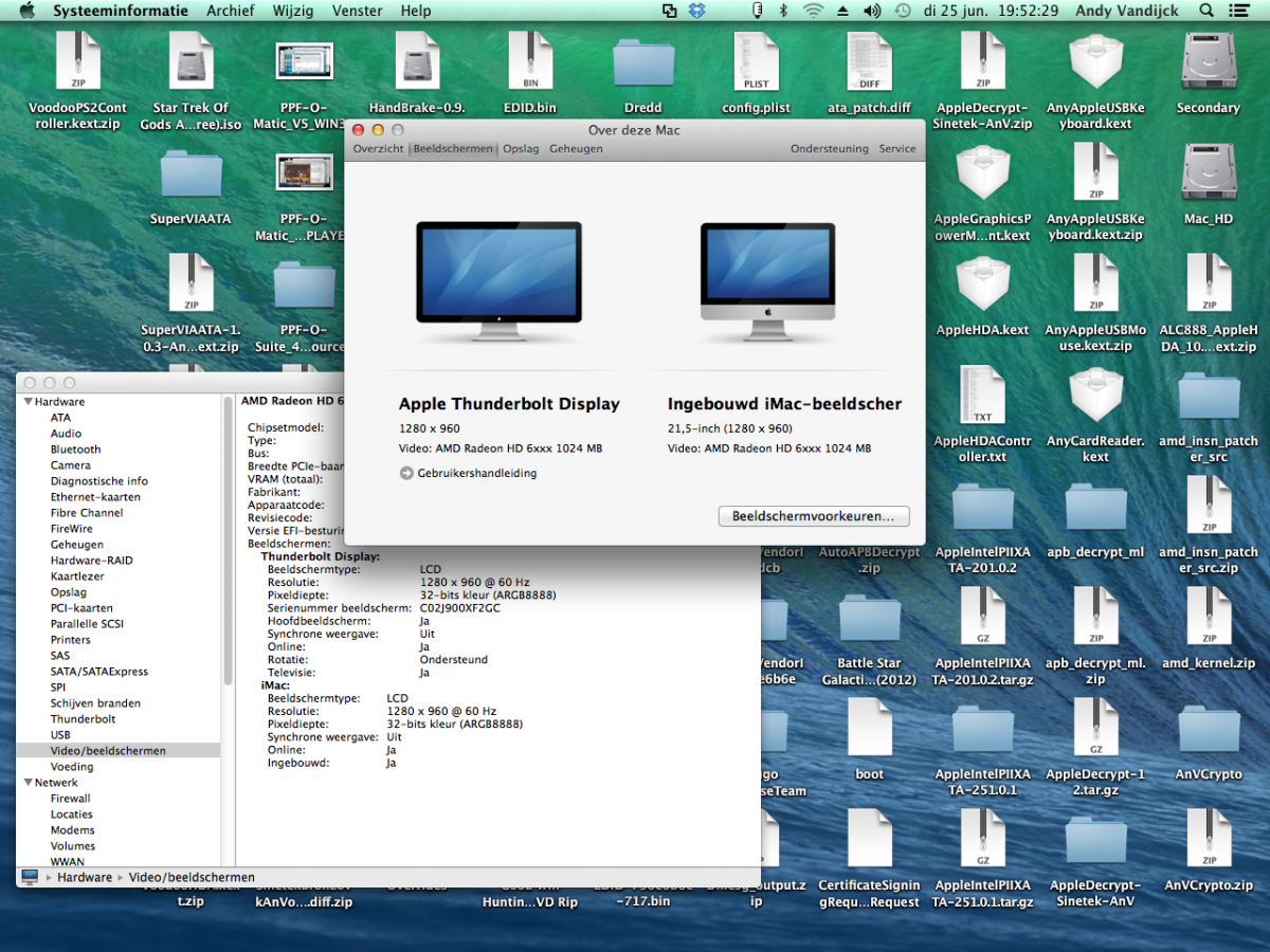

Andy Vandijck Posted June 25, 2013 Author Share Posted June 25, 2013 I found the issue.It's in the kext.I will need to make a new injector based on AppleUSBMergeNub.Otherwise it won't separate the displays (injects first one in all).Work continues... EDIT: Yamayo! Succes!... Sources for the merging nub are attached here. I'll compile it and modify the FixEDID app (new version V1.1) DisplayMergeNub.zip Link to comment https://www.insanelymac.com/forum/topic/294634-different-solutions/page/8/#findComment-1927782 Share on other sites More sharing options...

Andy Vandijck Posted June 25, 2013 Author Share Posted June 25, 2013 New version V1.1 - Modified driver creation to use the new DisplayMergeNub - Fixed a bug to get 2nd / 3rd / etc display with button (caused crash) - Added basic params override for display to be set as LCD - Fixed Info.plist creation code Everyone, please test and report back. It should be fixed now Also some additional fixes done. Remove Monitor_Apple.kext before you install the new DisplayMergeNub.kext For download and sources, see first post EDIT: Ooops... forgot to add the OSBundleLibraries to the Info.plist generation. V1.1b attached in opening post will work right now I've remove the injector, made an override and I'm gonna test now Yeah! Bingo! Now it works fine! Below is with auto-generated driver... 1 Link to comment https://www.insanelymac.com/forum/topic/294634-different-solutions/page/8/#findComment-1927816 Share on other sites More sharing options...

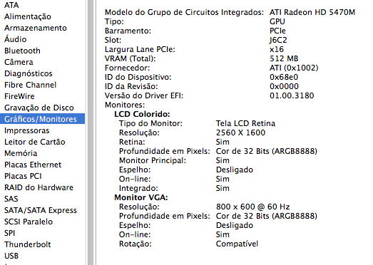

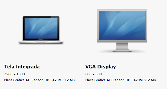

artur_pt Posted June 26, 2013 Share Posted June 26, 2013 hello Andy is working retina display.. rsrsrsrsrs thanks Link to comment https://www.insanelymac.com/forum/topic/294634-different-solutions/page/8/#findComment-1927971 Share on other sites More sharing options...
Andy Vandijck Posted June 26, 2013 Author Share Posted June 26, 2013 hello Andy is working retina display.. rsrsrsrsrs null null thanks You can copy the kext e.g. to documents. Run the app again. Change the value from 1 to 2 and click the top right button. Open the second edid Set it to Thunderbolt display. Click make. It will generate the new driver. Open the Info.plist of the one in documents and the new one. Copy the key under IOKitPersonalities and add it under IOKitPersonalities of the second Info.plist. Save it and install the driver. Enjoy one display as integrated and one as Thunderbolt EDIT: I'll fix the binary copy. I forgot to add \" around the %s parts EDIT: Fixed in the new version Link to comment https://www.insanelymac.com/forum/topic/294634-different-solutions/page/8/#findComment-1927975 Share on other sites More sharing options...

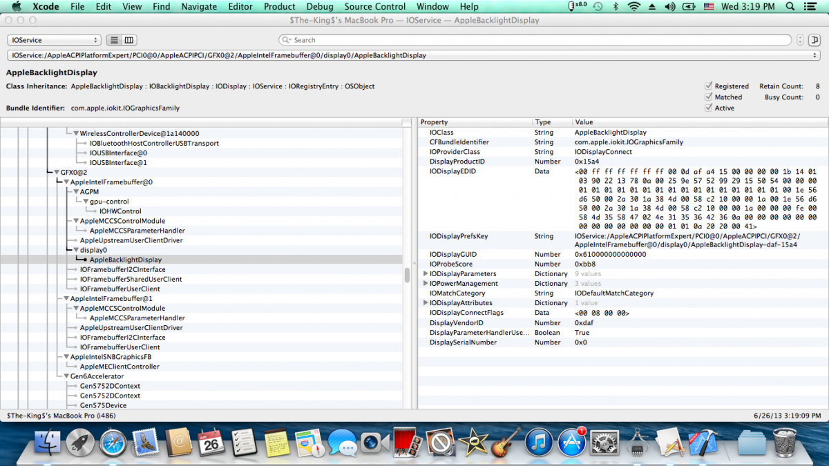

Mohamed Khairy Posted June 26, 2013 Share Posted June 26, 2013 hi andy tried this on my notebook here is my EDID.bin EDID.bin.zip and here is the generated kext DisplayMergeNub.kext.zip and installed it on system /library / extensions but it appears that kext not loaded ! and no changes on ioreg so what is the problem ?! Link to comment https://www.insanelymac.com/forum/topic/294634-different-solutions/page/8/#findComment-1928100 Share on other sites More sharing options...
