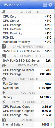

TimeWalker75a Posted February 15, 2014 Author Share Posted February 15, 2014 I've done some crucial changes to the slim app. the notifyicon text can hold only 64 characters, so it's not much we can utilize- don't go with profile names.. been looking at baloontips (which can update when you have them show up), but they are ugly. 1. config changed, now each setting is a separate entry. no more legacy point entries. 2. some crucial checks for when the fan is not controlled by bios. if fan has locked at a greater speed than requested - give bios control back. if fan speed is 0 and 0 is not requested per profile's config - give bios control back 3. because of changes in 2 I made the fan speed bar colorize depending on the mode. if fan has locked the speed bar will be white, if bios still controls the fan it will be green. if passive mode is used the notifyicon text will say that "Mode: Locked" if fan was locked in off state because there's no bar to report this. 4. if gpu temp is found to be 0 then never again should the program read gpu temp from 0x56 register, because it will produce garbage if done otherwise 5. added possibility to specify -delay XX in the app shortcut to delay the start of the application, since the port driver takes some time to start (with SSD anyway). I will push the code later at some point. (setting in your shortcut IT8518E-SCT-FC.exe" -delay 15 will delay the app start for 15 second) I've done some changes to OSX ACPI tables for fan control .. the one thing that you need is _PTS patch to reset TCTL bit after every power state transition. Also, I should implement additional checks from (2) into the acpi table as well. but you can use it none the less at its current state. https://github.com/Dolnor/Vostro-3450-Fan-Override (the alt one is the one that locks the fan at 3000rpm, you can change the value if you want). Basically you replace the PollDevc table with this one, all the configuration is done inside this table. Then you just edit the ACPISensors plist for ACPIProbe to math the name PLL0000 and not POLL0000. Then it should work in the same manner as the windows app does (except the checks i've mentioned). bins-it8518e-fc.rar Link to comment https://www.insanelymac.com/forum/topic/293246-osx-on-dell-vostro-3450-inspiron-n4110-xps-l702x-uefi-clover/page/9/#findComment-1994319 Share on other sites More sharing options...

TimeWalker75a Posted February 15, 2014 Author Share Posted February 15, 2014 There you go .. the behavior coded in is the same as "Audible" profile under Windows. I will update the "Passive" profile's analog and push this to git when I have time. HWMonitor application has been patched to include monitoring for fan control mode. As expected - it's either auto or steady. osx-fan-control.zip mirror: https://www.dropbox.com/s/t69jtriziymbtih/osx-fan-control.zip 1 Link to comment https://www.insanelymac.com/forum/topic/293246-osx-on-dell-vostro-3450-inspiron-n4110-xps-l702x-uefi-clover/page/9/#findComment-1994373 Share on other sites More sharing options...

Inter95 Posted February 16, 2014 Share Posted February 16, 2014 Great! it working fine, now we know when is controlling by bios, very nice feature. can you set up a red flag on the number when goes over 68 or 70? Link to comment https://www.insanelymac.com/forum/topic/293246-osx-on-dell-vostro-3450-inspiron-n4110-xps-l702x-uefi-clover/page/9/#findComment-1994579 Share on other sites More sharing options...
TimeWalker75a Posted February 16, 2014 Author Share Posted February 16, 2014 The notifyicon text is rendered all together, so I can't set the color to individual part of it. The notifyicon icon is rendered from a font resource. The font color is plain white, so for it to turn red I'd need to recolor the font and add a secondary resource file. I suppose I could do that, but would it make a dramatic difference? Chances of it exceeding 70C when you are seeing your task bar are slim. Link to comment https://www.insanelymac.com/forum/topic/293246-osx-on-dell-vostro-3450-inspiron-n4110-xps-l702x-uefi-clover/page/9/#findComment-1994615 Share on other sites More sharing options...
