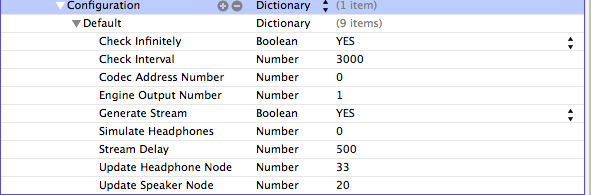

Sherlocks Posted February 26, 2014 Share Posted February 26, 2014 Thanks Timewalker i'm waiting .I have mac 3 version except snow leopard. I'm ready to test codec commander. # i builded codec commander SDK 10.8 kext loaded. but after sleep, Generate Stream is not working. so i cant use headphone here is log 14. 2. 27. 오전 9:47:36.000 kernel: CodecCommander: cc: --> awake 14. 2. 27. 오전 9:47:36.000 kernel: CodecCommander: cc: --> hda codec power restored 14. 2. 27. 오전 9:47:36.000 kernel: Previous Sleep Cause: 5 14. 2. 27. 오전 9:47:36.000 kernel: The USB device HubDevice (Port 1 of Hub at 0x1a000000) may have caused a wake by issuing a remote wakeup (2) 14. 2. 27. 오전 9:47:36.000 kernel: CodecCommander: w: ICW stored set command 1470c02 14. 2. 27. 오전 9:47:36.000 kernel: CodecCommander: w: ICB was set, sending verb over the link 14. 2. 27. 오전 9:47:36.000 kernel: CodecCommander: w: PIO operation #1 14. 2. 27. 오전 9:47:36.000 kernel: CodecCommander: rw: IRV was set by hardware 14. 2. 27. 오전 9:47:36.000 kernel: CodecCommander: rw: IRV cleared, allowing new commands 14. 2. 27. 오전 9:47:36.000 kernel: CodecCommander: w: ICW stored set command 2170c02 14. 2. 27. 오전 9:47:36.000 kernel: CodecCommander: w: ICB was set, sending verb over the link 14. 2. 27. 오전 9:47:36.000 kernel: CodecCommander: w: PIO operation #2 14. 2. 27. 오전 9:47:36.000 kernel: CodecCommander: rw: IRV was set by hardware 14. 2. 27. 오전 9:47:36.000 kernel: CodecCommander: rw: IRV cleared, allowing new commands 14. 2. 27. 오전 9:47:36.000 kernel: CodecCommander: cc: --> workloop started 14. 2. 27. 오전 9:47:36.000 kernel: DSP Sound assertion in DspFuncManager at line 425 14. 2. 27. 오전 9:47:36.000 kernel: DSP Sound assertion in DspFuncManager at line 1419 14. 2. 27. 오전 9:47:36.000 kernel: CodecCommander: cc: --> simulate mute-unmute event 14. 2. 27. 오전 9:47:36.000 kernel: CodecCommander: hi: scancode 20 in 14. 2. 27. 오전 9:47:36.000 kernel: CodecCommander: hi: adb keycode 74 out 14. 2. 27. 오전 9:47:36.000 kernel: CodecCommander: hi: scancode 20 in 14. 2. 27. 오전 9:47:36.000 kernel: CodecCommander: hi: adb keycode 74 out 14. 2. 27. 오전 9:47:36.000 kernel: CodecCommander: cc: --> simulate headphone jack event 14. 2. 27. 오전 9:47:36.000 kernel: CodecCommander: w: ICW stored set command 707c0 14. 2. 27. 오전 9:47:36.000 kernel: CodecCommander: w: ICB was set, sending verb over the link 14. 2. 27. 오전 9:47:36.000 kernel: CodecCommander: rw: IRV was set by hardware 14. 2. 27. 오전 9:47:36.000 kernel: CodecCommander: rw: IRV cleared, allowing new commands 14. 2. 27. 오전 9:47:36.000 kernel: CodecCommander: w: ICW stored set command 70700 14. 2. 27. 오전 9:47:36.000 kernel: CodecCommander: w: ICB was set, sending verb over the link 14. 2. 27. 오전 9:47:36.000 kernel: CodecCommander: rw: IRV was set by hardware 14. 2. 27. 오전 9:47:36.000 kernel: CodecCommander: rw: IRV cleared, allowing new commands Link to comment https://www.insanelymac.com/forum/topic/293246-osx-on-dell-vostro-3450-inspiron-n4110-xps-l702x-uefi-clover/page/14/#findComment-1997896 Share on other sites More sharing options...

Sherlocks Posted February 27, 2014 Share Posted February 27, 2014 Codec Commander sometimes can't recognize headphone. simulate headphone is not working as default setting So i changed value like blow. Link to comment https://www.insanelymac.com/forum/topic/293246-osx-on-dell-vostro-3450-inspiron-n4110-xps-l702x-uefi-clover/page/14/#findComment-1997935 Share on other sites More sharing options...
TimeWalker75a Posted February 27, 2014 Author Share Posted February 27, 2014 UPD: USB3 and speaking are working perfect. but headphone doesn't work at all. it was working fine after i applied the patch for USB3 but now doesnt. If you rebooted from windows the headphone port will be able to detect the jack, but audio won't pass through ... also, make sure you still have HDA Hardware Config in CustomPeripheral kext. i builded codec commander SDK 10.8 kext loaded. but after sleep, Generate Stream is not working. so i cant use headphone 14. 2. 27. 오전 9:47:36.000 kernel: CodecCommander: rw: IRV cleared, allowing new commands 14. 2. 27. 오전 9:47:36.000 kernel: CodecCommander: cc: --> workloop started 14. 2. 27. 오전 9:47:36.000 kernel: DSP Sound assertion in DspFuncManager at line 425 14. 2. 27. 오전 9:47:36.000 kernel: DSP Sound assertion in DspFuncManager at line 1419 Have you built it with 10.8 SDK and trying to use it with 10.7.5? While this somewhat works, certain functions DSP functions may be different in 10.7.5, so kext will not work properly. Codec Commander sometimes can't recognize headphone. simulate headphone is not working as default setting So i changed value like blow. Just read the readme on git .. if no audio stream is generated headphones won't work in any OSX version after 25 seconds after wake. In 10.9.2 headphones won't be detected after 2nd PIO is sent. Link to comment https://www.insanelymac.com/forum/topic/293246-osx-on-dell-vostro-3450-inspiron-n4110-xps-l702x-uefi-clover/page/14/#findComment-1997952 Share on other sites More sharing options...
