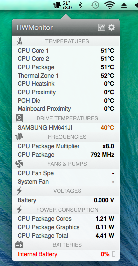

Mohamed Khairy Posted February 21, 2014 Share Posted February 21, 2014 glad it works for amd models as well. kudos to RehabMan for finishing what hotKoffy started .. I've tried the kext ages ago (in early 2012) and it didn't work at all. fan 1 is actually the system fan, it doesn't know (and has no way to tell) what is the maxim rpm for it. fan0 is fake fan.. and i have no way to make it something else except a fake fan, so pay no attention to it. none. I deciphered what the embedded controller registers are and how to control the fan, then made my own acpi tables and control logic (except average temp part, that was borrowed from Rehab's). this won't affect because you can always add what's missing.. your laptop has to have an embedded controller and you can read all the data from it from RW Everything. i added yours SSDT-1 but it can't read values :/ Link to comment https://www.insanelymac.com/forum/topic/293246-osx-on-dell-vostro-3450-inspiron-n4110-xps-l702x-uefi-clover/page/11/#findComment-1996211 Share on other sites More sharing options...
TimeWalker75a Posted February 21, 2014 Author Share Posted February 21, 2014 i added yours SSDT-1 but it can't read values :/ Untitled.png Your firmware is not Tiano, but Aptio and chances are your EC is not an ITE IT8518E either .. so no wonder it doesn't read anything. 1 Link to comment https://www.insanelymac.com/forum/topic/293246-osx-on-dell-vostro-3450-inspiron-n4110-xps-l702x-uefi-clover/page/11/#findComment-1996219 Share on other sites More sharing options...
Mohamed Khairy Posted February 21, 2014 Share Posted February 21, 2014 so there is an easy solution to get fan reads ? Link to comment https://www.insanelymac.com/forum/topic/293246-osx-on-dell-vostro-3450-inspiron-n4110-xps-l702x-uefi-clover/page/11/#findComment-1996221 Share on other sites More sharing options...
TimeWalker75a Posted February 21, 2014 Author Share Posted February 21, 2014 Install Windows, install RW Everything, stare at your screen forever trying to understand what register shows fan speed... 1 Link to comment https://www.insanelymac.com/forum/topic/293246-osx-on-dell-vostro-3450-inspiron-n4110-xps-l702x-uefi-clover/page/11/#findComment-1996222 Share on other sites More sharing options...
