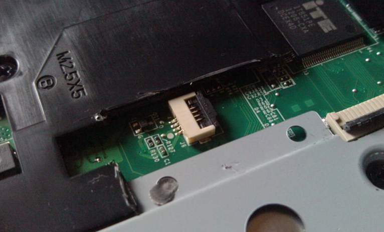

Inter95 Posted February 10, 2014 Share Posted February 10, 2014 i compile and installed but for now it useless for me until i get a backlit keyboard. it make me ask you a question, if i buy a backlit keyboard, is it compatible with my 14R system? because i search on ebay for it and he say if my system 14R didn't ship with backlit wouldn't work. 2/10/14 2:16:53.000 PM kernel[0]: BacklightCommander: commander initializing 2/10/14 2:16:53.000 PM kernel[0]: BacklightCommander: plist config --> time zone GMT:-5 2/10/14 2:16:53.000 PM kernel[0]: BacklightCommander: commander probing 2/10/14 2:16:53.000 PM kernel[0]: BacklightCommander: commander version 0.1.0 starting 2/10/14 2:16:53.000 PM kernel[0]: BacklightCommander: acpi config --> backlight level 1, timeout level 180 2/10/14 2:16:53.000 PM kernel[0]: BacklightCommander: acpi config --> enable past 17:00, disable past 09:00 2/10/14 2:16:53.000 PM kernel[0]: BacklightCommander: backlight timeout level set to 15 min Link to comment https://www.insanelymac.com/forum/topic/293246-osx-on-dell-vostro-3450-inspiron-n4110-xps-l702x-uefi-clover/page/8/#findComment-1992884 Share on other sites More sharing options...
TimeWalker75a Posted February 10, 2014 Author Share Posted February 10, 2014 Just pop the tabs on your keyboard with a guitar pick or something of that kind and check if there's an empty ZIF connector in there. Link to comment https://www.insanelymac.com/forum/topic/293246-osx-on-dell-vostro-3450-inspiron-n4110-xps-l702x-uefi-clover/page/8/#findComment-1992916 Share on other sites More sharing options...
Inter95 Posted February 12, 2014 Share Posted February 12, 2014 unfortunately it is not compatible doesnt have an empty zif connector Link to comment https://www.insanelymac.com/forum/topic/293246-osx-on-dell-vostro-3450-inspiron-n4110-xps-l702x-uefi-clover/page/8/#findComment-1993356 Share on other sites More sharing options...
Zprood Posted February 12, 2014 Share Posted February 12, 2014 As experienced, 14R n4110 needs cutting out a piece of cover like blew then you can see the power connector. Link to comment https://www.insanelymac.com/forum/topic/293246-osx-on-dell-vostro-3450-inspiron-n4110-xps-l702x-uefi-clover/page/8/#findComment-1993434 Share on other sites More sharing options...
TimeWalker75a Posted February 12, 2014 Author Share Posted February 12, 2014 Oh those bastards hid the connector lol. But you can certainly dremel the plastic out and use the zif, just make sure to tape the plastic that may potentially cut the flimsy ribbon of the backlight connector. On a related note.. Ive spent grand majority of yesterday debugging the ITE keyboard/EC controller that is seen on that picture. If you have access to a live distribution of Ubuntu mind checking if this would work for ya? Use sudo perl dell_ec command in terminal to read from the embedded controller. https://github.com/Dolnor/DELL-Tiano-IT8518E-Debug Link to comment https://www.insanelymac.com/forum/topic/293246-osx-on-dell-vostro-3450-inspiron-n4110-xps-l702x-uefi-clover/page/8/#findComment-1993438 Share on other sites More sharing options...
