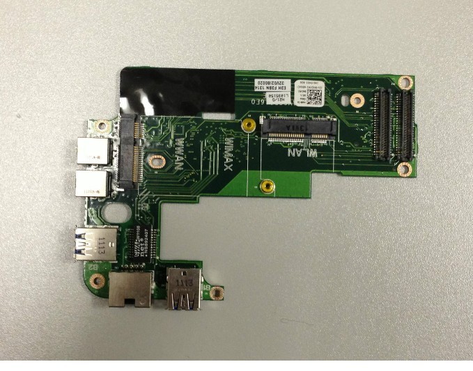

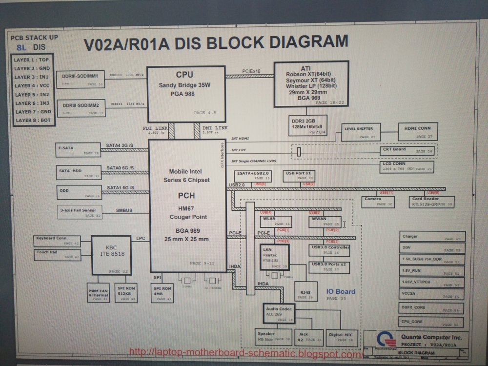

Hello, I'm using the N4110, after flashing the BIOS from Inspiron N4110 A12-C4, there are some advanced options including the UEFI option and some others. The UEFI option is working for me, which is excellent.
However,  when I want to change the PCIe configuration to enable port 2,  the settings do not work. The settings can be edit and save, but port 2 cannot be seen in the system. Furthermore, when I disable all the PCIe ports(default enabled port 1, 3, 5), all the ports still can be seen in the system, and are all correctly working. The system diagram is shown in the attachment.
The reason I want to enable port 2 is to utilize the WWAN slot on the motherboard. And furthermore, I want to add the external graphics cards to the N4110 via PCIe slot.
Currently, it is working via the WLAN PCIe port with GTX 730 card which has 1gb memory. But when I change to another GPU card like GTX750ti 2gb, the N4110 can not boot up with only a back screen after pushing the power button. But ONLY when I reduce my 8gb memory to 2gb, the 750ti could work correctly.
I guess the onboard 6630m has taken a lot of resources that leave a little resource to the external graphics cards.
So, is it possible to disable the 6630m via the BIOS? Or expand the BIOS resource from 32bit to more i.e 36bit ?
