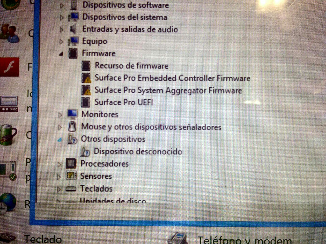

I am having problem with the last Firmware update. Check attach image.
Other devices is system cover telemetry.
I have the same problem!
How to fix it?

I fix my [ PCI configuration begin ] block deleting the npci=0x2000 from clover config!
It might cause some trouble removing this value?
