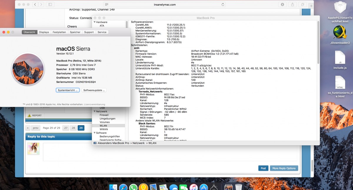

UltraLaser Posted October 27, 2016 Share Posted October 27, 2016 Adding this will work again on 10.12.1 if you had it working in 10.12.0 it only works at 2,4 Ghz no AC mode. I also installed IO80211Family.kext but still in non AC mode Link to comment https://www.insanelymac.com/forum/topic/292542-airport-pcie-half-mini/page/24/#findComment-2307306 Share on other sites More sharing options...
jsl Posted October 27, 2016 Share Posted October 27, 2016 it only works at 2,4 Ghz no AC mode. I also installed IO80211Family.kext but still in non AC mode Please try this Post#1: http://www.insanelymac.com/forum/topic/312759-fix-macos-sierra-dp1-bcm94532z-wifi/ Link to comment https://www.insanelymac.com/forum/topic/292542-airport-pcie-half-mini/page/24/#findComment-2307330 Share on other sites More sharing options...

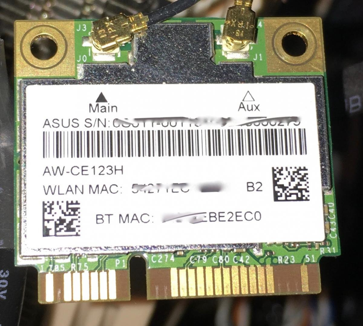

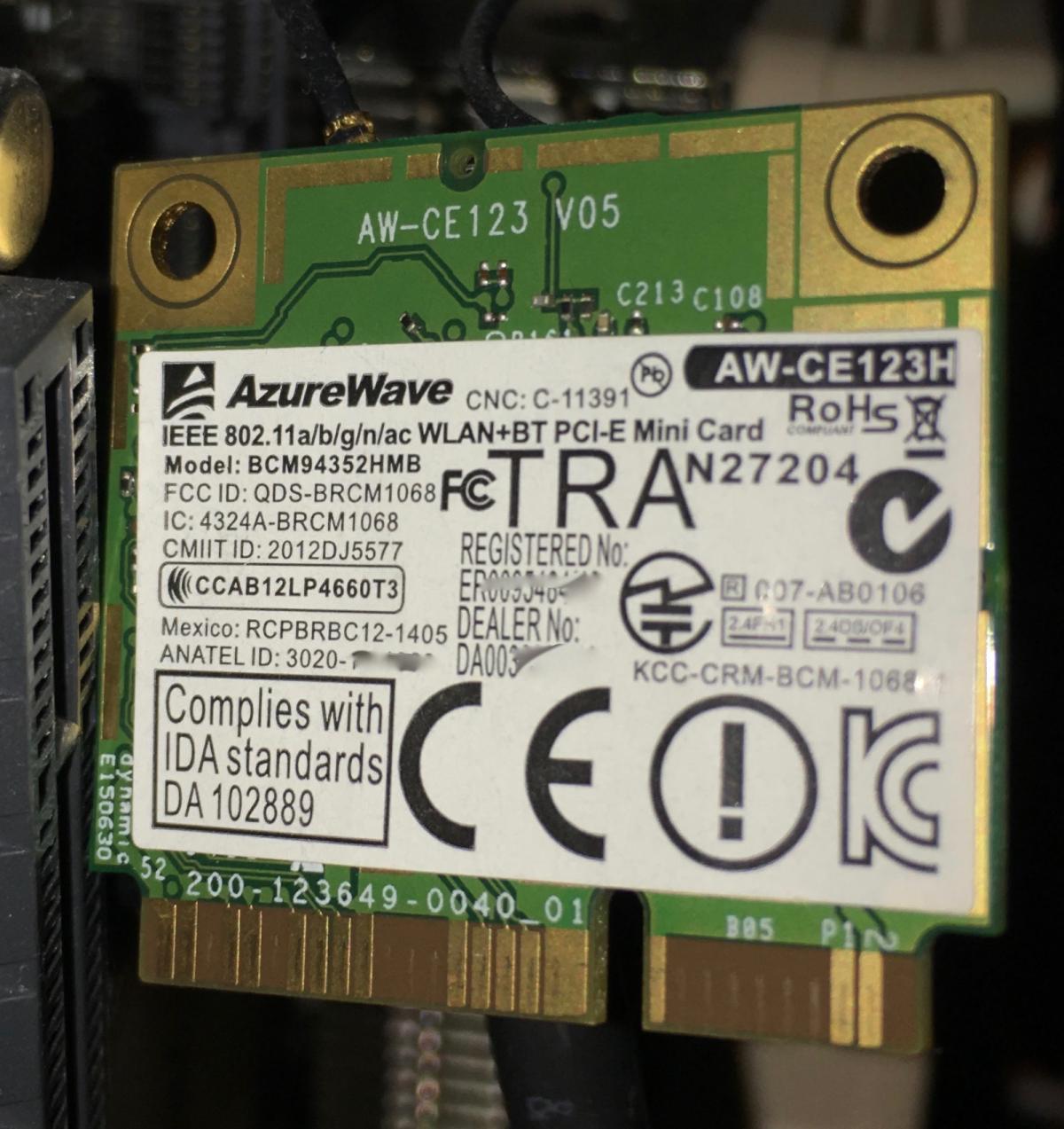

UltraLaser Posted October 28, 2016 Share Posted October 28, 2016 I had that already for 10.12 GM. For 10.12.1, I need to add those additional 3 patches to work. IO80211Family.kext and IO80211FamilyV2 from 10.12.1 IO80211Family.zip I restored the original IO80211Family.kext and applied the 3 patch.. but now i have "No hardware found". So what can I do to get this card to work? Mine is this : Link to comment https://www.insanelymac.com/forum/topic/292542-airport-pcie-half-mini/page/24/#findComment-2307952 Share on other sites More sharing options...
iloveYou Posted October 28, 2016 Share Posted October 28, 2016 IO80211Family.zip I restored the original IO80211Family.kext and applied the 3 patch.. but now i have "No hardware found". So what can I do to get this card to work? Mine is this : Same card. Here's my config.plist: <dict> <key>Comment</key> <string>AirPortBrcm4360 - PCI Error 2</string> <key>Disabled</key> <false/> <key>Find</key> <data> QQ+3zTnBdQw= </data> <key>Name</key> <string>AirPortBrcm4360</string> <key>Replace</key> <data> QQ+3zTnBZpA= </data> </dict> <dict> <key>Comment</key> <string>AirPortBrcm4360 - PCI Error 1</string> <key>Disabled</key> <false/> <key>Find</key> <data> QTnEdRs= </data> <key>Name</key> <string>AirPortBrcm4360</string> <key>Replace</key> <data> QTnEZpA= </data> </dict> <dict> <key>Comment</key> <string>10.11-BCM94352-CC=#a-Ramalama</string> <key>Disabled</key> <false/> <key>Find</key> <data> QYP8/3QsSA== </data> <key>Name</key> <string>AirPortBrcm4360</string> <key>Replace</key> <data> ZscGI2HrKw== </data> </dict> <dict> <key>Comment</key> <string>Sierra Boot Logo Fix</string> <key>Disabled</key> <false/> <key>Find</key> <data> AQAAdSU= </data> <key>Name</key> <string>IOGraphicsFamily</string> <key>Replace</key> <data> AQAA6yU= </data> </dict> <dict> <key>Comment</key> <string>AirPortBrcm4360 - PCI Error 3</string> <key>Disabled</key> <false/> <key>Find</key> <data> g33EBHQG </data> <key>Name</key> <string>AirPortBrcm4360</string> <key>Replace</key> <data> g33EBGaQ </data> </dict> <dict> <key>Comment</key> <string>10.11-BCM94352-Whitelest-0x4353-MacBoolAir5,2</string> <key>Disabled</key> <false/> <key>Find</key> <data> TWFjLUM2RUZBNjM5NjJGQzZFQTA= </data> <key>Name</key> <string>AirPortBrcm4360</string> <key>Replace</key> <data> TWFjLTI3QURCQjdCNENFRThFNjE= </data> </dict> <dict> <key>Comment</key> <string>BCM94352 Airport</string> <key>Disabled</key> <false/> <key>Find</key> <data> gflSqgAAdSk= </data> <key>Name</key> <string>AirPortBrcm4360</string> <key>Replace</key> <data> gflSqgAAZpA= </data> </dict> <dict> <key>Comment</key> <string>10.11-BCM94352-Whitelest-0x4331-iMac14,3</string> <key>Disabled</key> <false/> <key>Find</key> <data> TWFjLUM2RUZBNjM5NjJGQzZFQTA= </data> <key>Name</key> <string>AirPortBrcm4360</string> <key>Replace</key> <data> TWFjLTI3QURCQjdCNENFRThFNjE= </data> </dict> <dict> <key>Comment</key> <string>10.11-BCM94352-5GHz-US-FCC-dv</string> <key>Disabled</key> <false/> <key>Find</key> <data> QYP8/3QsSA== </data> <key>Name</key> <string>AirPortBrcm4360</string> <key>Replace</key> <data> ZscGVVPrKw== </data> </dict> <dict> <key>Comment</key> <string>10.11-BCM94352-Airport-Extreme</string> <key>Disabled</key> <false/> <key>Find</key> <data> axAAAHUN </data> <key>Name</key> <string>AirPortBrcm4360</string> <key>Replace</key> <data> axAAAJCQ </data> </dict> <dict> <key>Comment</key> <string>10.11-BT4LE-Handoff-Hotspot-lisai9093</string> <key>Disabled</key> <false/> <key>Find</key> <data> SIX/dEdIiwc= </data> <key>Name</key> <string>IOBluetoothFamily</string> <key>Replace</key> <data> Qb4PAAAA60Q= </data> </dict> Link to comment https://www.insanelymac.com/forum/topic/292542-airport-pcie-half-mini/page/24/#findComment-2307975 Share on other sites More sharing options...
UltraLaser Posted October 28, 2016 Share Posted October 28, 2016 Same card. Here's my config.plist: <dict> <key>Comment</key> <string>AirPortBrcm4360 - PCI Error 2</string> <key>Disabled</key> <false/> <key>Find</key> <data> QQ+3zTnBdQw= </data> <key>Name</key> <string>AirPortBrcm4360</string> <key>Replace</key> <data> QQ+3zTnBZpA= </data> </dict> <dict> <key>Comment</key> <string>AirPortBrcm4360 - PCI Error 1</string> <key>Disabled</key> <false/> <key>Find</key> <data> QTnEdRs= </data> <key>Name</key> <string>AirPortBrcm4360</string> <key>Replace</key> <data> QTnEZpA= </data> </dict> <dict> <key>Comment</key> <string>10.11-BCM94352-CC=#a-Ramalama</string> <key>Disabled</key> <false/> <key>Find</key> <data> QYP8/3QsSA== </data> <key>Name</key> <string>AirPortBrcm4360</string> <key>Replace</key> <data> ZscGI2HrKw== </data> </dict> <dict> <key>Comment</key> <string>Sierra Boot Logo Fix</string> <key>Disabled</key> <false/> <key>Find</key> <data> AQAAdSU= </data> <key>Name</key> <string>IOGraphicsFamily</string> <key>Replace</key> <data> AQAA6yU= </data> </dict> <dict> <key>Comment</key> <string>AirPortBrcm4360 - PCI Error 3</string> <key>Disabled</key> <false/> <key>Find</key> <data> g33EBHQG </data> <key>Name</key> <string>AirPortBrcm4360</string> <key>Replace</key> <data> g33EBGaQ </data> </dict> <dict> <key>Comment</key> <string>10.11-BCM94352-Whitelest-0x4353-MacBoolAir5,2</string> <key>Disabled</key> <false/> <key>Find</key> <data> TWFjLUM2RUZBNjM5NjJGQzZFQTA= </data> <key>Name</key> <string>AirPortBrcm4360</string> <key>Replace</key> <data> TWFjLTI3QURCQjdCNENFRThFNjE= </data> </dict> <dict> <key>Comment</key> <string>BCM94352 Airport</string> <key>Disabled</key> <false/> <key>Find</key> <data> gflSqgAAdSk= </data> <key>Name</key> <string>AirPortBrcm4360</string> <key>Replace</key> <data> gflSqgAAZpA= </data> </dict> <dict> <key>Comment</key> <string>10.11-BCM94352-Whitelest-0x4331-iMac14,3</string> <key>Disabled</key> <false/> <key>Find</key> <data> TWFjLUM2RUZBNjM5NjJGQzZFQTA= </data> <key>Name</key> <string>AirPortBrcm4360</string> <key>Replace</key> <data> TWFjLTI3QURCQjdCNENFRThFNjE= </data> </dict> <dict> <key>Comment</key> <string>10.11-BCM94352-5GHz-US-FCC-dv</string> <key>Disabled</key> <false/> <key>Find</key> <data> QYP8/3QsSA== </data> <key>Name</key> <string>AirPortBrcm4360</string> <key>Replace</key> <data> ZscGVVPrKw== </data> </dict> <dict> <key>Comment</key> <string>10.11-BCM94352-Airport-Extreme</string> <key>Disabled</key> <false/> <key>Find</key> <data> axAAAHUN </data> <key>Name</key> <string>AirPortBrcm4360</string> <key>Replace</key> <data> axAAAJCQ </data> </dict> <dict> <key>Comment</key> <string>10.11-BT4LE-Handoff-Hotspot-lisai9093</string> <key>Disabled</key> <false/> <key>Find</key> <data> SIX/dEdIiwc= </data> <key>Name</key> <string>IOBluetoothFamily</string> <key>Replace</key> <data> Qb4PAAAA60Q= </data> </dict> And which kext have u copied in S/L/E ? Link to comment https://www.insanelymac.com/forum/topic/292542-airport-pcie-half-mini/page/24/#findComment-2308006 Share on other sites More sharing options...
toleda Posted October 28, 2016 Author Share Posted October 28, 2016 Adding this will work again on 10.12.1 if you had it working in 10.12.0 Not necessary, device id injection problem. See Post #1, Airport Injection Methods have "No hardware found". There are no PCI errors for AW-CE123H, remove See Problem Reporting, Post #1; attach all requested files Link to comment https://www.insanelymac.com/forum/topic/292542-airport-pcie-half-mini/page/24/#findComment-2308348 Share on other sites More sharing options...

toleda Posted October 29, 2016 Author Share Posted October 29, 2016 if I enable AddDTGP and FixAirpot then have KP! But without AddDTGP and FixAirport all works great Issue: clover/FixAirport does not work in 10.12.1 Suggestions: Remove Whitelist (2x), 10.11-BCM94352-5GHz-US-FCC-dv. Use only if not US/FCC: 10.11-BCM94352-CC=#a-Ramalama Do not need/use: FixAirport Link to comment https://www.insanelymac.com/forum/topic/292542-airport-pcie-half-mini/page/24/#findComment-2309200 Share on other sites More sharing options...

UltraLaser Posted November 5, 2016 Share Posted November 5, 2016 The attached is an older kext. Anyone has IO80211Family.kext from 10.12 floating around? I've patched the original kexts (only add the device) Install it and remove - FakePCIID_Broadcom_WiFi.kext - FakePCIID.kext From SLE IO80211Family.kext.zip Link to comment https://www.insanelymac.com/forum/topic/292542-airport-pcie-half-mini/page/24/#findComment-2314168 Share on other sites More sharing options...
toleda Posted November 5, 2016 Author Share Posted November 5, 2016 Update v4.1 - 11/5/16 - 10.12.1 WiFi Injection stopped working (1. FakePCIID.kext and 5. Clover/FixAirport), see Post #1 Airport Injection Methods. I've patched the original kexts (only add the device) Clover patch: see Post #1/Airport Injection Methods/2. kext edit/Info.plist Link to comment https://www.insanelymac.com/forum/topic/292542-airport-pcie-half-mini/page/24/#findComment-2314254 Share on other sites More sharing options...
