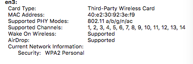

OK, so now, using "BrcmFirmwareData.kext" and "BrcmPatchRAM2.kext" BT now works, but Wifi only on channels 1-14.
You need FakePCIID.kext+FakePCIID_Broadcom_WiFi.kext.
And 5Ghz patch (see post #1).

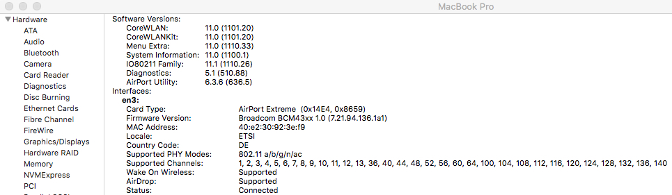

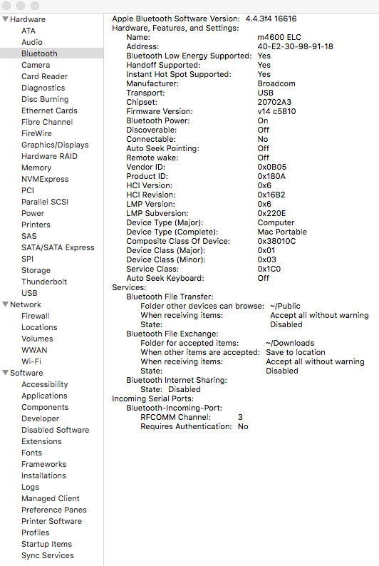

Great, but I resolve my problem with these steps:
1. move BrcmFirmwareData.kext" and "BrcmPatchRAM2.kext to EFI/Clover/kexts/10.11
2. apply wireless_bcm94352-110-v4.0c.command with option "3" and country code "DE"
now, my BT works with Handoff support and also Wifi works on 2,4GHz + 5GHz channels with Airdrop.
(BCM94360HMB/AzureWave AW-CB160H)

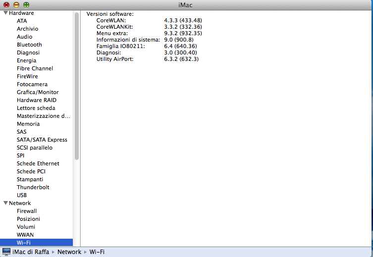

hi,i need a hand with this modules that a buy
Under Mavericks 10.9.5 and chameleon bootloader
BCM943602CS wifi + bt 4.1
With the steps on first page i will be able to making work??
Actually the card is connected to the mobo (Asus P8P67 Deluxe) but no wifi and no BT
I see post #1,read all and i don't understand what steps i must fallow

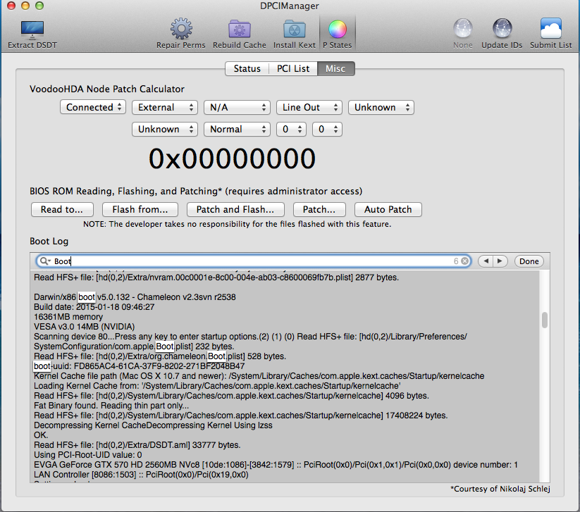

maybe i'm wrong but i don't see a method to making work BCM943602CS...Anyway this is my Problem Reporting:
OSX: Mavericks 10.9.5
Bootlooader: Chameleon
MotherBoard: Asus P8P67 Deluxe
Bios Version: 2103
CPU: i7 2600K
GPU: EVGA 570HD (2560MB VRAM)
I almost forgot to say that i make a test with another SSD,
Bootlooader Clover installed on a pen drive prepared to install El Capitan
The BCM943602CS work's OOB,even during installation process ask me to turn on the magic mouse and Keyboard.
Thank's for your Time and Patience :wink_anim:  :wink_anim:
IOReg iMac di Raffa.zip
org.chameleon.Boot.plist.zip
