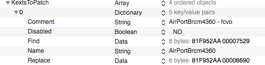

magnifico Posted May 10, 2017 Share Posted May 10, 2017 hi toleda 1) I use kext to patch <dict> <key>Comment</key> <string>AirPortBrcm4360 - fcvo</string> <key>Disabled</key> <false/> <key>Find</key> <data> gflSqgAAdSk= </data> <key>Name</key> <string>AirPortBrcm4360</string> <key>Replace</key> <data> gflSqgAAZpA= </data> </dict> Wi fi is located in RP04 from IoRegister ..and i used also SSDT..but not work ( I mean wi fi does not work , trusted me) My problem has become very boring, I repeat when it goes to sleep, after it takes a lot of time to reactivate the wi fi, about 30 40 seconds, where am I mistaken ?? Now i'm using racer kexts, FakePCIID.kext FakePCIID_Broadcom_WiFi.kext (includes 94352) of course, but with ssdt it does not work wi fi, i obviously have the problem of the losing time to reactivate SSDT-ARPT-RP04-4352.aml.zip MacBook Pro1 di magnifico.zip Link to comment https://www.insanelymac.com/forum/topic/292542-airport-pcie-half-mini/page/28/#findComment-2421218 Share on other sites More sharing options...
RehabMan Posted May 10, 2017 Share Posted May 10, 2017 hi toleda 1) I use kext to patch Wi fi is located in RP04 from IoRegister ..and i used also SSDT..but not work ( I mean wi fi does not work , trusted me) My problem has become very boring, I repeat when it goes to sleep, after it takes a lot of time to reactivate the wi fi, about 30 40 seconds, where am I mistaken ?? Now i'm using racer kexts, FakePCIID.kext FakePCIID_Broadcom_WiFi.kext (includes 94352) of course, but with ssdt it does not work wi fi, i obviously have the problem of the losing time to reactivate Your ioreg indicates FakePCIID.kext and/or FakePCIID_Broadcom_WiFi.kext is not installed. After installing the kexts... No need to inject "compatible" (remove the SSDT). Link to comment https://www.insanelymac.com/forum/topic/292542-airport-pcie-half-mini/page/28/#findComment-2421276 Share on other sites More sharing options...
magnifico Posted May 10, 2017 Share Posted May 10, 2017 Your ioreg indicates FakePCIID.kext and/or FakePCIID_Broadcom_WiFi.kext is not installed. After installing the kexts... No need to inject "compatible" (remove the SSDT). yes of course ,I'm doing tests with wi fi injected into fake.smc, that is why do not you see your kext, clear racer? Link to comment https://www.insanelymac.com/forum/topic/292542-airport-pcie-half-mini/page/28/#findComment-2421281 Share on other sites More sharing options...
RehabMan Posted May 10, 2017 Share Posted May 10, 2017 yes of course ,I'm doing tests with wi fi injected into fake.smc, that is why do not you see your kext, clear racer? Advice remains the same. Remove the SSDT. Install FakePCIID kexts. Your problem likely has to do with country code setting/patch... Link to comment https://www.insanelymac.com/forum/topic/292542-airport-pcie-half-mini/page/28/#findComment-2421428 Share on other sites More sharing options...
