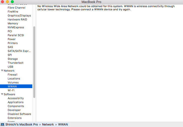

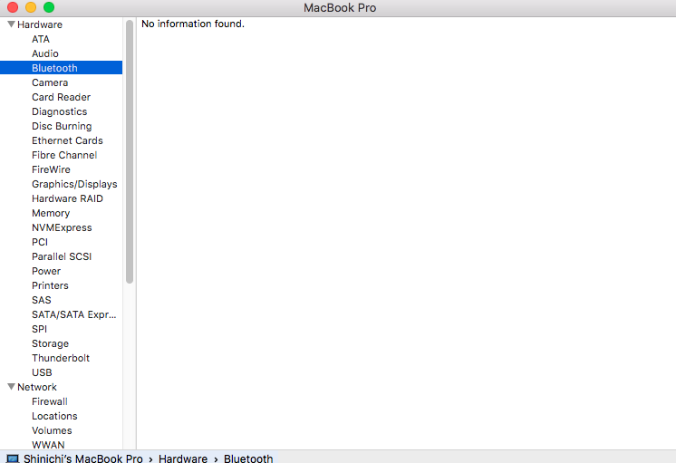

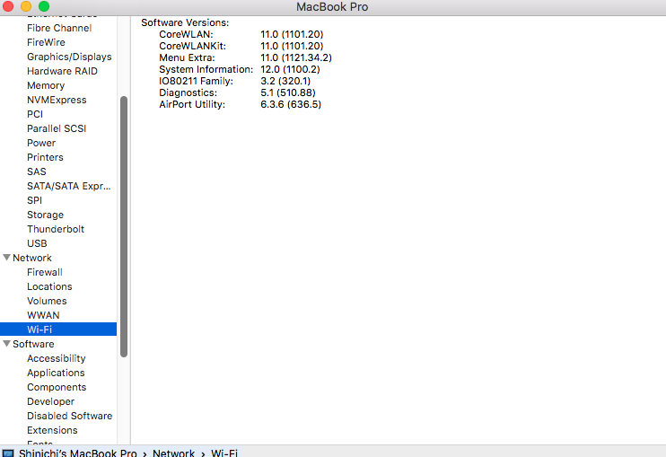

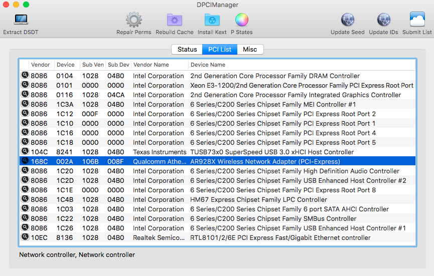

kudo2002 Posted October 6, 2016 Share Posted October 6, 2016 Ok, Thanks for your help but I already replaced with another card here linux dump 09:00.0 Network controller [0280]: Broadcom Corporation BCM4312 802.11b/g LP-PHY [14e4:4315] (rev 01) but i can't get to work, I tried a lot of solutions Bluetooth + Wifi not detected, please look at the following pictures Note: BCM4313 Bluetooth was working outbox with using Kext files Link to comment https://www.insanelymac.com/forum/topic/292542-airport-pcie-half-mini/page/23/#findComment-2294716 Share on other sites More sharing options...
davidm71 Posted October 8, 2016 Share Posted October 8, 2016 Looking to buy a BCM94360CD card and adapter and have searched amazon and ebay. Found the Wifi BT card but there are different versions of the pci-adapter card. Some that have two antenas in the back, some with four antenas, and some that have some sort of a use usb connection and internal antenae wiring. The cost is anywhere from $60 to $8 depending on the adapter card. What do you guys recommend? Thanks Link to comment https://www.insanelymac.com/forum/topic/292542-airport-pcie-half-mini/page/23/#findComment-2295784 Share on other sites More sharing options...
toleda Posted October 9, 2016 Author Share Posted October 9, 2016 Broadcom Corporation BCM4312 802.11b/g LP-PHY [14e4:4315] (rev 01) Not supported. See Post #1 for supported Broadcom device_ids. there are different versions of the pci-adapter card. OSX/BCM94360CD requires 3 external antennas and a usb2 plug. Link to comment https://www.insanelymac.com/forum/topic/292542-airport-pcie-half-mini/page/23/#findComment-2296243 Share on other sites More sharing options...
