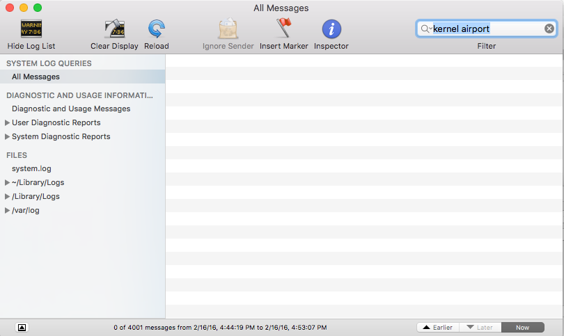

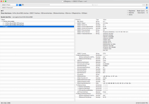

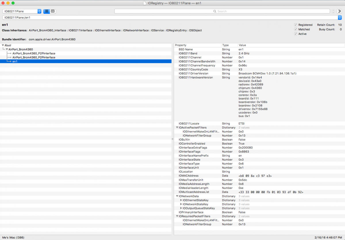

crazyallstar31 Posted February 17, 2016 Share Posted February 17, 2016 @toleda I was able to attach a compressed IORegistry file...I could not find the "kernel: airport" so I attached an all messages file. Let me know if you need anything else. IORegistry.zip All Messages.aslquery.zip Link to comment https://www.insanelymac.com/forum/topic/292542-airport-pcie-half-mini/page/21/#findComment-2216354 Share on other sites More sharing options...
toleda Posted February 18, 2016 Author Share Posted February 18, 2016 able to attach a compressed IORegistry file.. IOReg says the 4360 is working, what is the problem? Link to comment https://www.insanelymac.com/forum/topic/292542-airport-pcie-half-mini/page/21/#findComment-2216377 Share on other sites More sharing options...

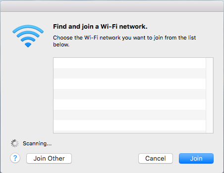

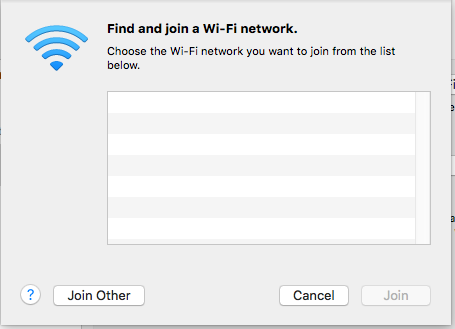

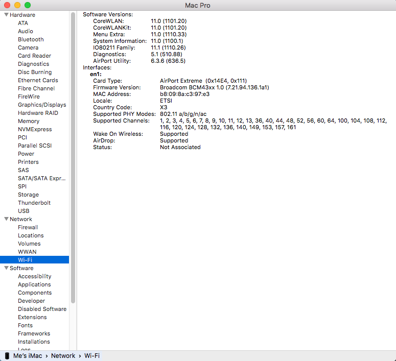

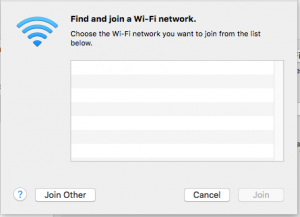

crazyallstar31 Posted February 18, 2016 Share Posted February 18, 2016 I know that's the crazy part. but no matter what I do the wifi symbol in the taskbar just stays greyed out. Also if I go into network preferences, no matter how many times I turn the wifi off and on, it will no show any available networks. Even if I try and manually connect to a network, it will not connect. I have tried a home network using a router, and a hotspot. It just won't show networks or connect. Crazy. Link to comment https://www.insanelymac.com/forum/topic/292542-airport-pcie-half-mini/page/21/#findComment-2216410 Share on other sites More sharing options...

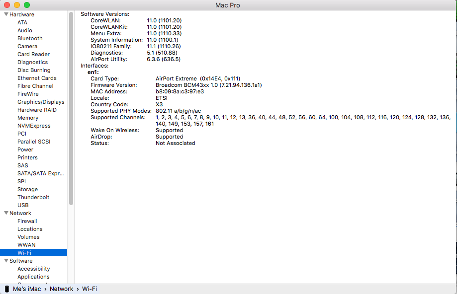

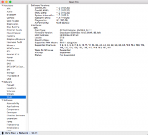

toleda Posted February 18, 2016 Author Share Posted February 18, 2016 It just won't show networks or connect. Antennas??? Join Other Network: Network Name: Security: Join Attach screenshots: System Information/Network-Wi-Fi System Information/Network/Wi-Fi Link to comment https://www.insanelymac.com/forum/topic/292542-airport-pcie-half-mini/page/21/#findComment-2216535 Share on other sites More sharing options...

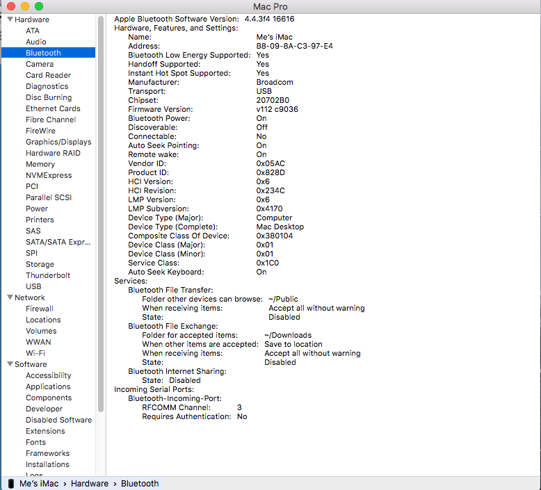

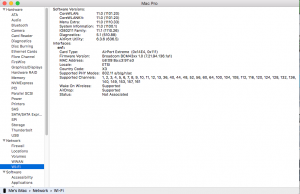

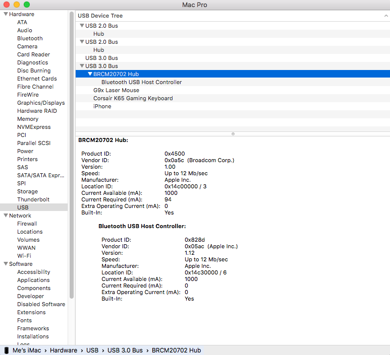

crazyallstar31 Posted February 18, 2016 Share Posted February 18, 2016 Yessir, I most certainly have the antennae installed. I have two SSD that connect to my setup. On my Windows 10 SSD, the wifi card and bluetooth work perfect (I installed the latest Mac bootcamp drivers). And on the Mac SSD, the bluetooth works perfect just not the wifi. So weird. Link to comment https://www.insanelymac.com/forum/topic/292542-airport-pcie-half-mini/page/21/#findComment-2216547 Share on other sites More sharing options...
toleda Posted February 19, 2016 Author Share Posted February 19, 2016 bluetooth works perfect just not the wifi. So weird. Is Country Code: X3 correct? See Post #1, Country Code Link to comment https://www.insanelymac.com/forum/topic/292542-airport-pcie-half-mini/page/21/#findComment-2216646 Share on other sites More sharing options...
crazyallstar31 Posted February 19, 2016 Share Posted February 19, 2016 @toleda No I live in Indiana, so I'm assuming we want it to say US. I don't know how to change it or reset it though I'm trying to read the country code message from post #1...but it's hard to follow, I'm just not understanding how/what to change Link to comment https://www.insanelymac.com/forum/topic/292542-airport-pcie-half-mini/page/21/#findComment-2216648 Share on other sites More sharing options...

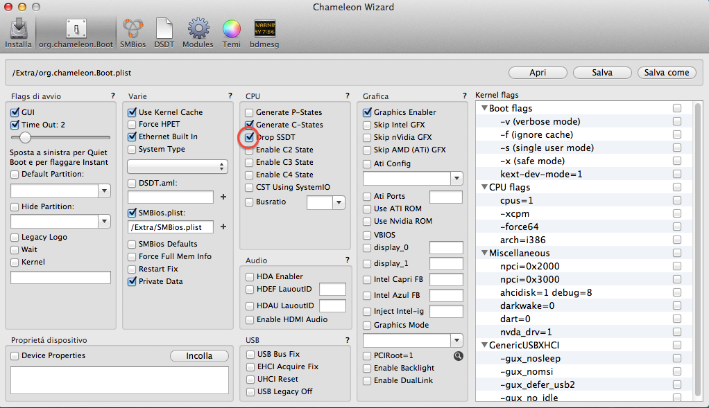

Bunga Posted February 19, 2016 Share Posted February 19, 2016 My mistake, Post #501. maybe i'm wrong but i forgot to enable Drop SSDT in my org.chameleonBoot.plist so i decide to enable it and retry with your first SSDT on post #499. Result: My system don't boot anymore i have to put it back the old configuration.....now at least everything work except this nightmare with BCM943602CS Here is some photo and tell me if i must prove with your second SSDT and enable "Drop SSDT" on my org.chameleonBoot.plist.Sorry for late reply,i'm busy with work. Link to comment https://www.insanelymac.com/forum/topic/292542-airport-pcie-half-mini/page/21/#findComment-2216683 Share on other sites More sharing options...

toleda Posted February 26, 2016 Author Share Posted February 26, 2016 I would add the kext, enter the hex to find and the hex to replace. I check boxed the box for infoplist. What country code? What is the hex value? Installing the US/FCC patch ensures US/FCC shows. Do not select Info.plist. Link to comment https://www.insanelymac.com/forum/topic/292542-airport-pcie-half-mini/page/21/#findComment-2218639 Share on other sites More sharing options...
crazyallstar31 Posted February 29, 2016 Share Posted February 29, 2016 The locale is set to ETSI, country code is X3. I want the locale to show FCC and country code to say US. I don't know how to find the hex value. I was loading the AirPortBrcm4360.kext file in clover configurator and replacing the hex values with the examples from post #1. I do not know how to find the hex values on my hack. Could you walk me through finding the actual hex values on my hack? Link to comment https://www.insanelymac.com/forum/topic/292542-airport-pcie-half-mini/page/21/#findComment-2219382 Share on other sites More sharing options...

toleda Posted February 29, 2016 Author Share Posted February 29, 2016 The locale is set to ETSI, country code is X3. Not valid, see Post #1, CC: Post #229 Airport - PCIe Half Mini Link to comment https://www.insanelymac.com/forum/topic/292542-airport-pcie-half-mini/page/21/#findComment-2219547 Share on other sites More sharing options...
