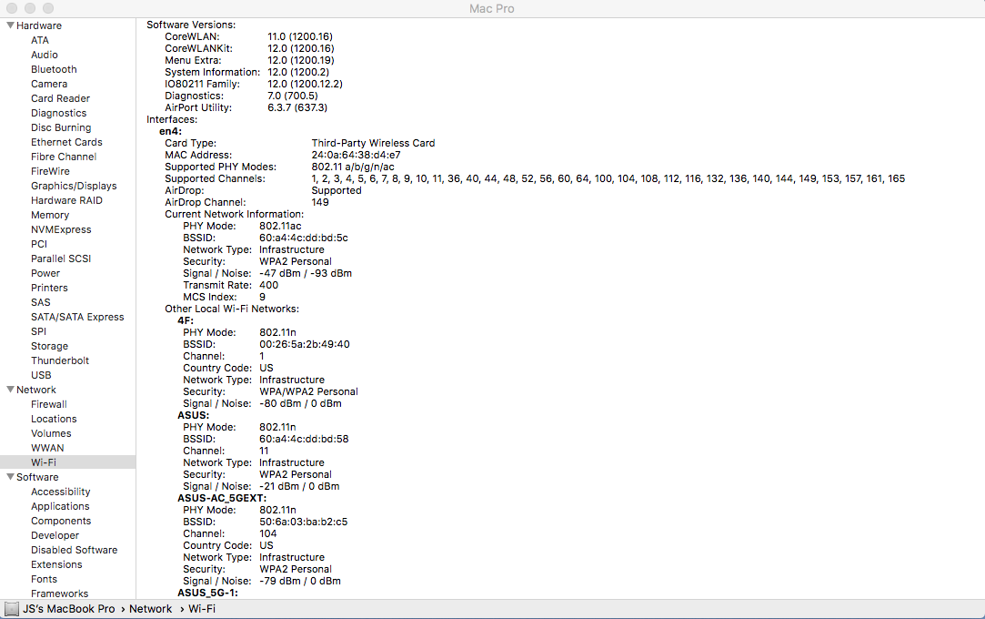

Do you remember my 80mhz bug with BCM43602Z? i found a solution on the russian forums...
Im using this 5ghz patch:
AirPortBrcm4360: 4183FCFF742C48 to 66C7062361EB2B
It changes country code to #a...
With FCC/US i have that 80mhz/40mhz bug...
But now i have 80mhz perfect working...
Cheers :-)

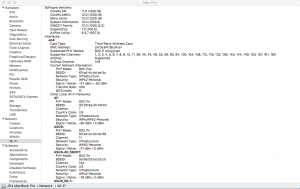

Hi, everybody! First thanks to all community and the gurus for making all this possible.
My BCM94352Z works well in my Cintiq Companion 2 (Yosemite 10.10.5, all security updates applied) ---> GUIDE
5Ghz channels appear in System Profile, Airdrop, Handoff... almost everything works.
ISSUES:
I can't reach speeds above 145Mbps as it does in Windows.
Locale is shown as Unknow (card is FCC-US and I changed country code to ES using Clover patch, it should show ETSI, right? If I try using FCC-US, I lose Airdrop between iOS and OSX but speed still under 145Mbps)
What I have right now:
- Fake PCIID
- Fake PCIID_Broadcom_Wifi
- 10.10-BCM94352-5GHz-ES <-- Custom Country Code Clover patch (changed 55 53 (US) 46 52 (FR) for 45 53 (ES)

I believe I tried this patch in addition to CC before but I'll give it. (UPDATE: tried with same result)
If I remove my custom CC patch, locale come back to FCC and country to US losing Airdrop (iOS-OSX) and Handoff.
FYI I did a fresh install and repeat every step. Airplay now works but I'm still only connection at 145Mbps.
Yes, ETSI is not a country, it's what my iMac shows in locale and I thought my hack should show the same but I might be wrong.
My country is Spain, I've used the 10.10-BCM94352-5GHz-FR patch.
I've changed 46 52 (FR) for 45 53 (ES). Channels 12 and 13 are shown in SP
