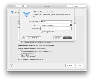

digital_person Posted January 1, 2018 Author Share Posted January 1, 2018 I had same issue, that I could only access my local network. I solved that by disabling IPv6 networksetup -setv6off Wi-Fi I've also set IP address, gateway and DNS manually I have same issue on El Capitan : have ssid of network but not have internet... 'networksetup -setv6off Wi-Fi' does not works for me. (Perhaps a locale setup to put ? : I'm French) Thanks for your work Digital_Person ! I got this bug too. Few weeks ago, after I replaced my old HDD and reinstalled El Capitan from scratch, I wasn't able to connect to the internet only my local network worked. I found solution to this problem: Go to System Preferences -> Network -> Wi-Fi -> Advanced Manually add your Wi-Fi network Name and Password Apply changes This helped me. Link to comment https://www.insanelymac.com/forum/topic/310394-legacy-broadcom-43xx-fix-for-el-capitan/#findComment-2559667 Share on other sites More sharing options...
