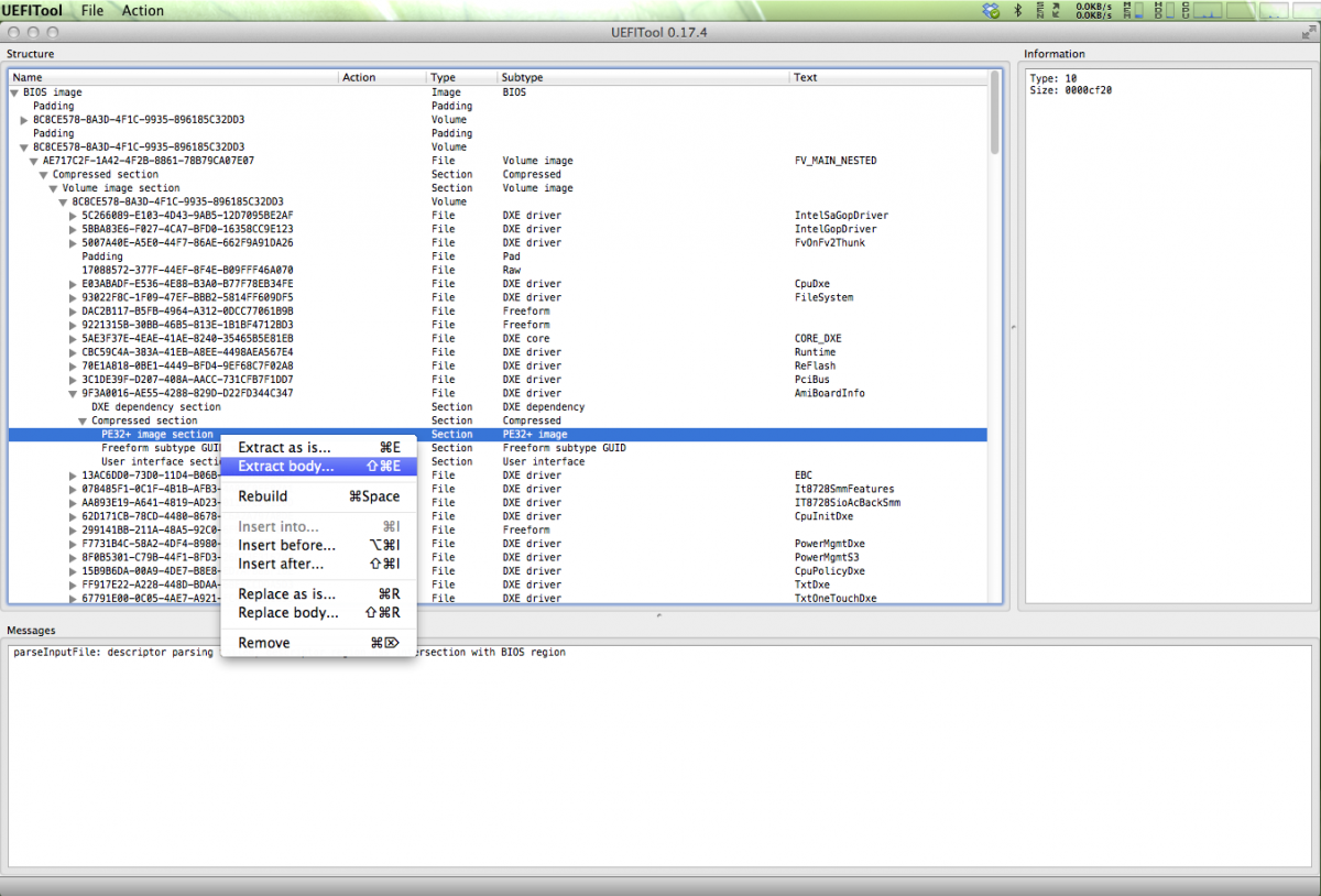

Annex follows AmiBoardInfo.ffs extracted correctly.
https://www.dropbox.com/s/rkn7fq0mqxhfptw/AmiBoardInfo.ffs

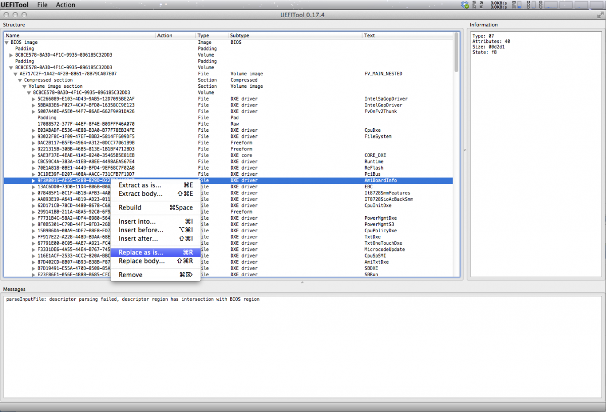

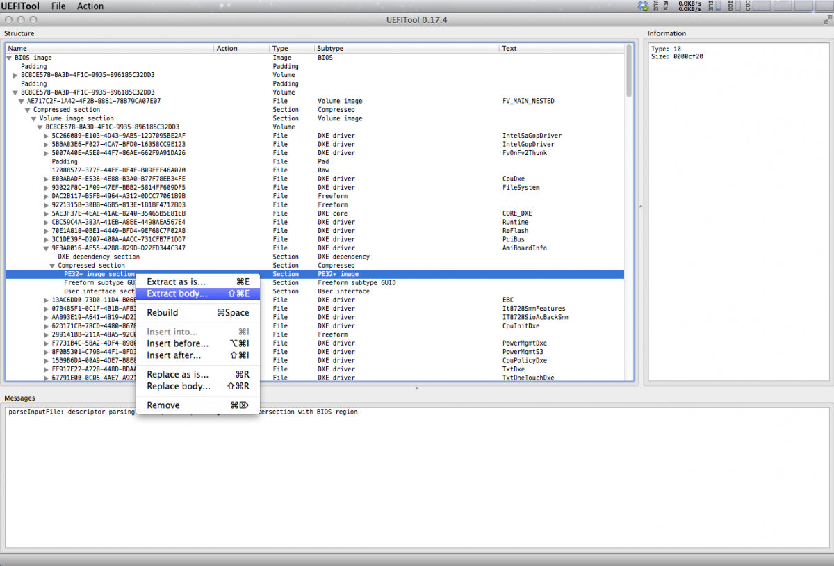

Not good, you do extract body of Compressed section.
You must do extract body of PE32+ image section.

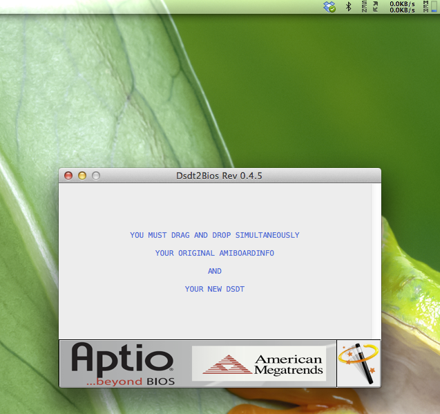

Add possibility to extract DSDT just by dragging AmiBoardInfo.
https://www.dropbox.com/s/r5evxwsgqx2gipk/Dsdt2Bios-r0.4.6.zip

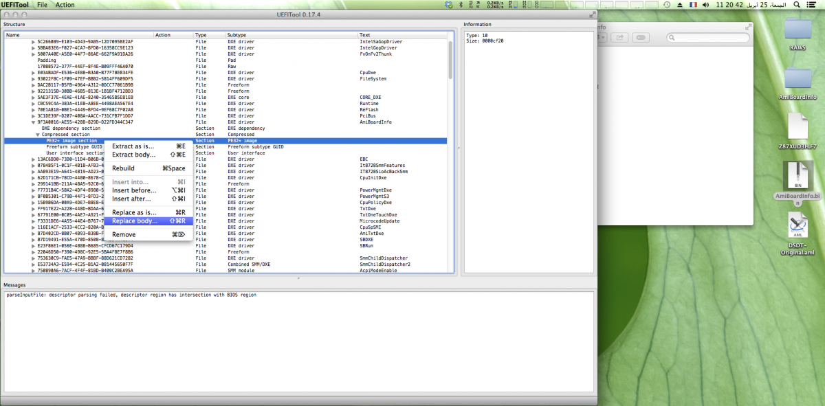

As FredWst said  ^_^! You need to extract it exactly like this :D , IF YOU DON'T NEED TO WASTE YOUR TIME :yes: .
Follow this picture: post-334538-0-62587100-1398271786_thumb.png
Ok here's yours patched AmiBoardInfo.ffs, you need to replace it exactly like this picture attachicon.gifReplace as is...png to your bios :yes:  :D .

Here's the Steps to follow:
1- Download the Bios from GIGABYTE.
2- Open it with UEFITool.
3- Inside of AmiBoardInfo there's "PE32+ image section" as same as the picture Step 1, that you need to extract it as "Extract Body", save it in a folder on your Desktop.

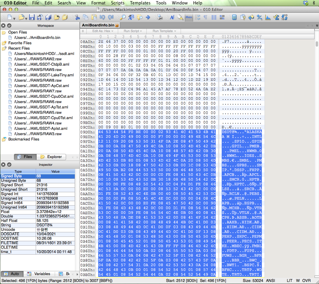

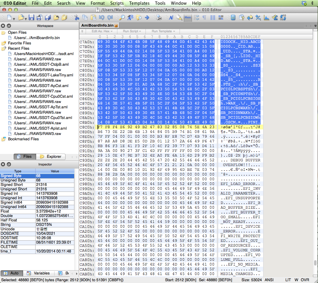

4- Now download 010 editor Mac version and open your extracted AmiBoardInfo.bin with it=>010Editor.
5- Locate the "DSDT" word in this file and select the same section in the two pictures "start and finish", copy it and paste it as Hex, the you need to save it as DSDT.aml file.
post-334538-0-10997300-1398423376_thumb.png  post-334538-0-95381700-1398423406_thumb.png

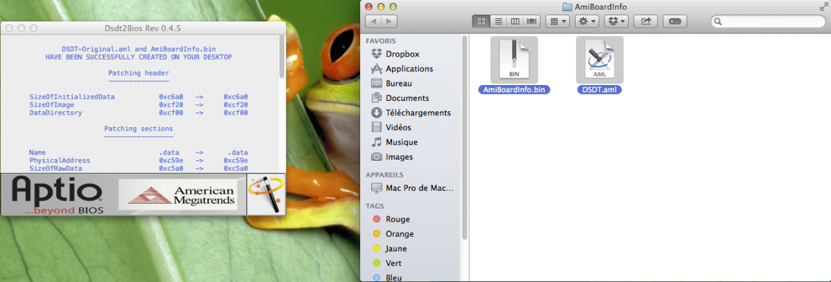

7- Now download the latest edition of FredWst tool "Dsdt2Bios.app", open it and Drag your Patched DSDT.aml and AmiBoardInfo.bin to this app.
post-334538-0-85960500-1398423440_thumb.png  post-334538-0-81166800-1398423460_thumb.png
8- A new AmiBoardInfo.bin and DSDT-Original.aml will appear in your Desktop, this what we need, just re-open your Bios with UEFITool and inside the AmiBoardInfo re-select the PE32+ Image Section, select it and now you need to click on replace body as the picture, and you are done.

Hi Israel Fernandes!

With last version of Dsdt2Bios, drag and drop AmiBoardInfo.bin, it will extract dsdt for you.
