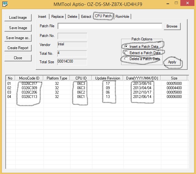

For who want to update CPU Microcode and don't know how, here's the process:
Step one:         From bios screen remember the number of your CPU ID which is: 000XXXXXX.
Step two:          From Windows go to Intel downloads and type in the search bar=> microcode, then download the latest one  it's 2014xxxx, unzip the file.
Step three:        Download the attached file named microdecode, unzip it.
Step four:          Now go to C:\ path and create a folder named microcode.
Step five:           From the Intel unzipped folder, copy microcode.dat and paste it on the folder created earlier.
Step six:            From the unzipped microdecode folder, copy microdecode and microdecode.c then paste them in folder created earlier.
Step seven:       Open CMD.exe and at command prompt type: cd C:\microcode , then type: microdecode.exe microdecode.dat , and you will see many 000XXXXX..............bin files, copy the one that has the same CPU ID number of your processor and paste it on CPU folder that you have to create on desktop.
Last one:            Open MMTOOL, select your bios file, click on CPU PATCH tab, you will have this screen:
- Extract all the CPU ID's seen in this screen in CPU folder, delete them from MMTOOL CPU PATCH tab, and now the first one that you need to insert, is the 000XXXX........BIN microcode that you have copied earlier from the microcode folder, then you will have to insert the oders.
Save your bios file, and now, you have a latest CPU microcode in your bios file which is allready for flash.

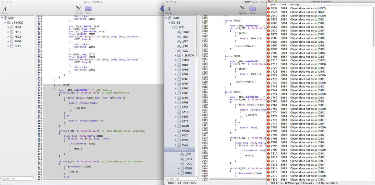

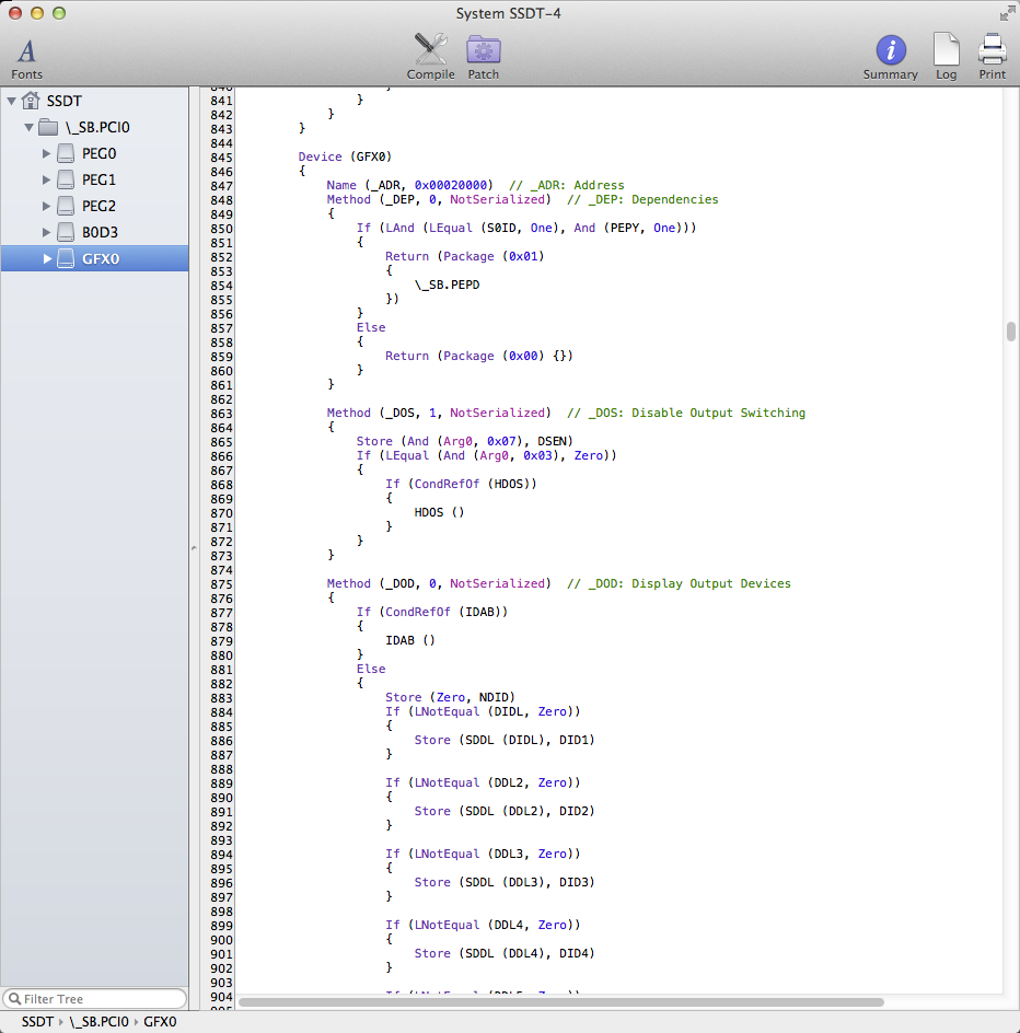

copy the GFX0 device to your DSDT and rename it to IGPU and look whats happen.
Ok! Just for understanding, i will copy the GFX0 from my SSDT-4 and paste it in my DSDT, where and why to rename it to IGPU, i think they will be confusion between SSDT-4 and DSDT? :worried_anim: .
No name, but subtype is freeform.
For my GA-Z77-DS3H is just after PowerManagement -> name 299141BB-211A-48A5-92C0-6F9A0A3A006E
Fred
Thank's Fred! I find it, but i have SSDT that is bigger than this one taken from Bios file, it's generated by PikerAlpha ssdtPRGen. Now, i'm confused  :wacko:
just for test.
rename the inserted GFX0 to iGPU.
just for test.
Ok Captain, i will try it right now!

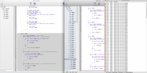

But if you can see also this attached DSDT it's last one that i have maked today!
DSDT.zip
There's 201 errors with GFX0 even with IGPU!
