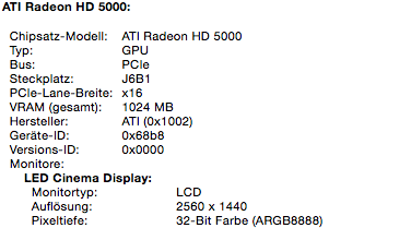

their two with the radeon 5770 ... i have the same card (original mac edition), but i have a other question.
can you see the right number in System Information? i see in system profiler only this:
but my card it is 5770 ... 100%
