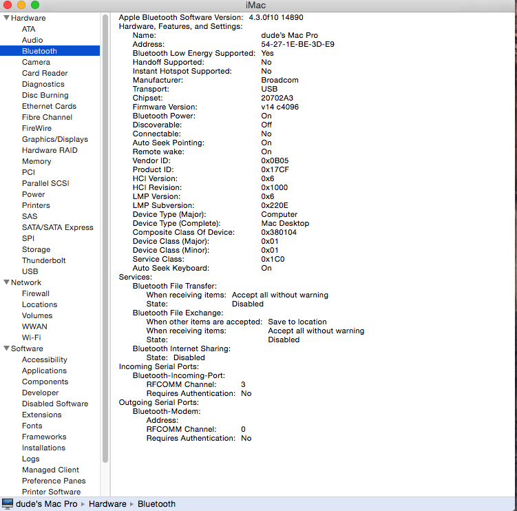

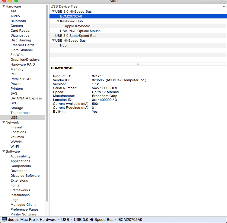

Hi friends, i have a weird view on my Asus Z97I-PLUS, i have ozmzosis in place, edited DSDT into EFi/Oz/Acpi/Load with all errors fixed and with some cosmetic patches so i can see right pci devices.
In my case a have a BCM4532 wifi mini pic but i can't add right DSDT injection to use this card, but i can use bluetooth as you can see in image named bluetooth
As you ca see in USB you notice  bcm controller under USB, it's only cosmetics, but how can fix this?
It's like that you can do it but maybe it need modifying EEPROM for region code:
Step 1: you need to boot with native DSDT not patched one.
Step 2: You need to open IORegistryExplorer to view where your BCM is placed.
Step 3: You need to note that place in paper.
Step 4: Open your patched DSDT and inject your BCM card in the place where you have seen before in IORegistryExplorer it should be Under: PCI0/RP0X/PXSX. The RP0X is the place you have seen in IORegistryExplorer and the 0X can be 05 or 06 or 07, then you need to add your BCM4532 card Under Device PXSX.
But for your BCM4532 to work "maybe" you steel need a right patch and maybe correct region code for it to work!
Hi Friend finaly i got it :D i had to delete the whole DSM definition under _SB.PCI.RP04.PXSX , so the patch has been correctly installed under sp/pci/rp04/pxsx into first sb folder on DSDT, now i have to figure howto fix cosmetic issue for BT under USB
