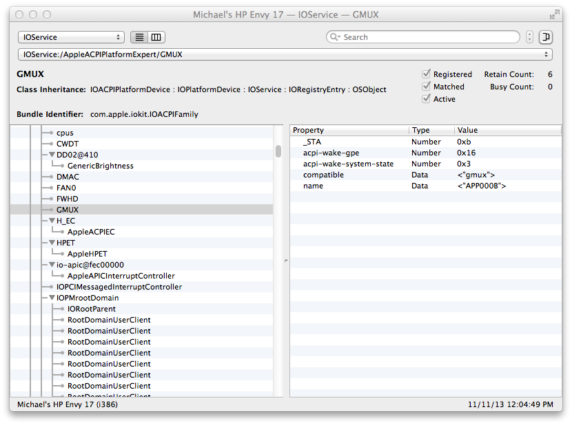

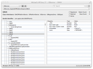

I tried using the DSDT entry to create the GMUX device.  I placed it in _SB.PCI0.LPCB and when I compiled it, I got an error message telling me that there is no entry called GP06.  In Mac, GP06 is located near the beginning in a group called Operation Region GPIO.  My HP Envy has an operation region by the same name (GPIO) but it does not have the GP06 entry.  It has many others instead.  Any idea which GPIO entry in my DSDT is the equivalent of Mac's GP06? (I currently have GIO3 listed but that is not a correct entry.)  I do not get the graphics switching option in my system preferences.  Also, I have the Intel HD4000 and the AMD Radeon 7850M.
DSDT.aml.zip
Also, here is what shows up in my IOReg:
attachicon.gifDSDT.aml.zip
So I added GP06 under GPIO:
DSDT_Fixed.zip
Meanwhile, I fixed the Warnings and Remarks.
But don't think it may get the discrete card work...
It's interesting that real Mac's ioreg has more options under GMUX:

It appears to be correct that, at least for my computer, adding the GMUX device did nothing to enable graphics switching.  I am not convinced, however, that an app similar to that developed by ATI for Windows cannot be made to allow software switching of GPUs in OS X.  Of course, it is doubtful that Apple will develop such an app since real Macs have the GMUX device.  Still, I had nothing better to do this morning than to test out this proposed method of getting GPU-switching to work.

If there is still no effect that means PC laptop doesn't have the GMUX device like Macs. Then you might want to disable nvidia card through DSDT to save battery life.
No such options are available using GMUX and it does not do anything different using HDMI. Appreciate the thought but I don't think this will go anywhere especially since real Haswell-based Mac ioregs do not include that device anyway. Again, i've only seen it displayed in HD 3000 Macs.
Even if that method worked. I don't think it would have worked for you anyway since the method was based around those who can't get around Optimus, which is an issue you don't have. I recall you having an ATI/AMD card and only Nvidia chips use Optimus.
Still, I feel the same way. Even though it didn't work, I applaud shiecldk for suggesting something different that no one else has brought up yet. I try not to immediately dismiss suggestions from others since that can make or break progress. No one person will ever know everything and those who pretend to are simply arrogant and have no business in a place like this. It is a place of learning, not of snobbery and I hope it forever stays that way. After all, if all ideas are shot down before they are given a chance, how will we ever really progress in anything? So, for me it was a test worth experimenting with.
