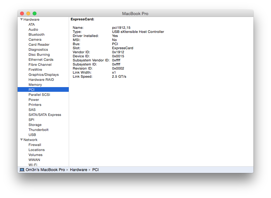

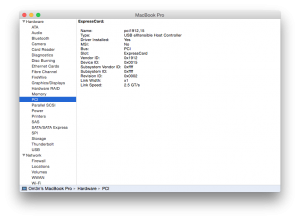

SCANNERS Posted February 9, 2015 Share Posted February 9, 2015 Hi, people just want to share with you I'd success installing this card, and I would like to make a question for you: GMYLE® ExpressCard 34mm to USB 3.0 Adapter (Dual Port) at Macbook Pro 17 mid2010 with OS X Yosemite 10.10 (I didn't update yet for last ver. because I made a clean install) First I installed this pkg: CalDigit_USB3_Driver_10_10_X_1.4.4.pkg But it doesn't function: System report says ExpressCard driver is not installed next I installed only this kext: CalDigitUSBxHCI.kext ver.1.3.8 using Kext Drop.app ver.1.1 I didn't installed this kext that usually install together CalDigitFastIO.kext ver.2.6.1 Do you think I need to install it? I'm not an expert and fear to mess it all. I attached my system report screenshot: iTunes sync tested and OK with 3 iDevices AT REGULAR MACBOOK PORTS, NOT AT CARD 2 PORTS THAT EVEN CAN'T CHARGE THE IPAD. File transferred from USB3 external hard drive with success and apparently fast than USB2 port Thanks in advance. 1 Link to comment https://www.insanelymac.com/forum/topic/286860-genericusbxhci-usb-30-driver-for-os-x-with-source/page/30/#findComment-2110036 Share on other sites More sharing options...
