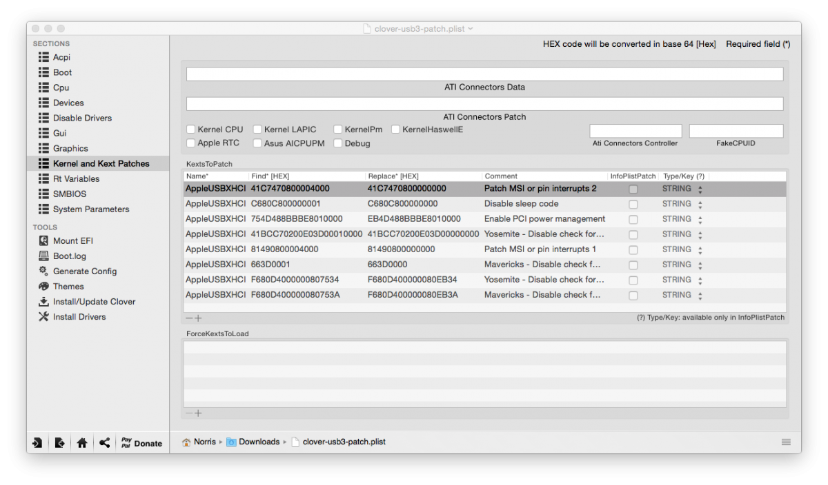

Goldgraeber Posted April 17, 2015 Share Posted April 17, 2015 Hi, sorry for my ignorance: I had genericusb running on a genuine mac pro. Now, since I installed 10.10.3 today it does no longer work. I tried to put that apple usb kext into /System/Library/Extensions but got an incorrect installation message. Well, is there a separate patch tool to apply the changes to the file - it seems that clover does not do that. Also, I sort of suspect that he patches llnked here deal with functionality inside the code but not with version mismatches. Link to comment https://www.insanelymac.com/forum/topic/286860-genericusbxhci-usb-30-driver-for-os-x-with-source/page/32/#findComment-2128860 Share on other sites More sharing options...
pere Posted April 18, 2015 Share Posted April 18, 2015 Is this what you need?. Link to comment https://www.insanelymac.com/forum/topic/286860-genericusbxhci-usb-30-driver-for-os-x-with-source/page/32/#findComment-2128968 Share on other sites More sharing options...

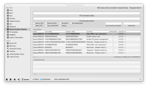

Goldgraeber Posted April 18, 2015 Share Posted April 18, 2015 Hi, thanks pere, the tool looks great for the job. I have a problem using it: I see the + sign adding empty lines after some patches that were already present, but I can neither type nor paste into these fields Link to comment https://www.insanelymac.com/forum/topic/286860-genericusbxhci-usb-30-driver-for-os-x-with-source/page/32/#findComment-2128985 Share on other sites More sharing options...
pere Posted April 18, 2015 Share Posted April 18, 2015 Please, lets keep on topic in this thread, come to the the Toshiba thread, i will explain the app usage there. Thanks. Link to comment https://www.insanelymac.com/forum/topic/286860-genericusbxhci-usb-30-driver-for-os-x-with-source/page/32/#findComment-2128993 Share on other sites More sharing options...

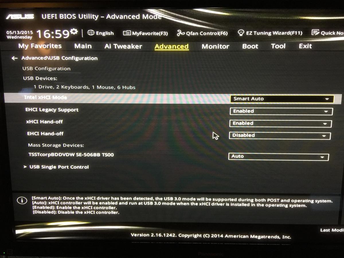

r.schroeder Posted May 20, 2015 Share Posted May 20, 2015 Hi, I am using the latest build of Clover with 10.9.5 on an Asus X99 Deluxe board. I've installed GenericUSBXHCI.kext 1.2.7 because I was told it was necessary for Fusion to load my Windows virtual machine. Without it, Windows would never finish booting - something about a very high number of interrupts, I believe. However, with that kext installed, my USB audio interface (a Scarlett 2i2 which uses Coreaudio) loses audio output. iTunes or any audio application will still be 'playing,' but the audio will simply cut out. To fix it I have to unplug the audio interface and plug it back in again, at which point the issue will occur again, seemingly random. I've looked through the Console output but there's nothing that would point to the issue. If I remove the kext, I have full USB3.0 speeds, but then of course I can't launch my virtual machine. Any help? I have some USB options in the BIOS, but I'm not sure if any of them would be helpful. Link to comment https://www.insanelymac.com/forum/topic/286860-genericusbxhci-usb-30-driver-for-os-x-with-source/page/32/#findComment-2137283 Share on other sites More sharing options...
