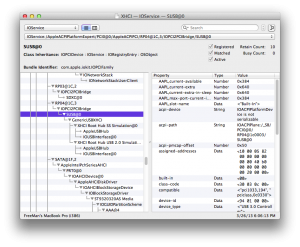

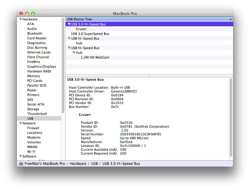

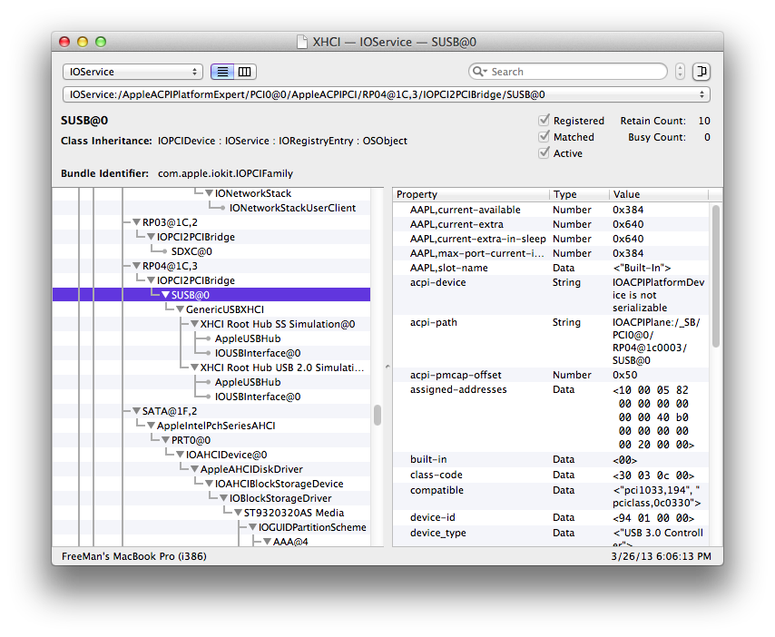

fe2babu Posted March 27, 2013 Share Posted March 27, 2013 It can work for my Acer 3830TG (VID 1033, DEV 0194, rev 04) with ver 1.1.4 kext However, sleep/wake issue occur(After wake up, Black screen). As requested: the xhcdump caps and running output without kernel flags xhcdump1.1.4.rtf Link to comment https://www.insanelymac.com/forum/topic/286860-genericusbxhci-usb-30-driver-for-os-x-with-source/page/3/#findComment-1901333 Share on other sites More sharing options...

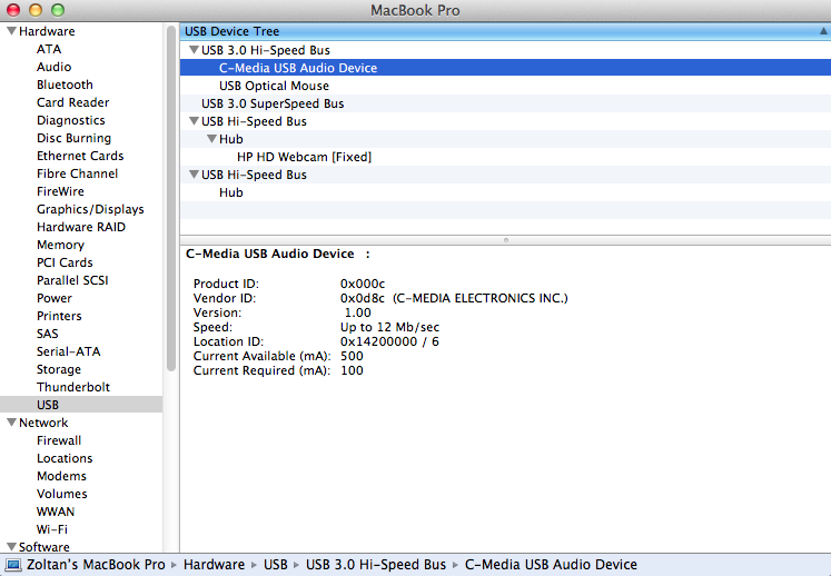

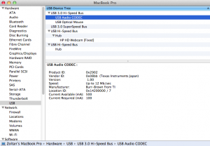

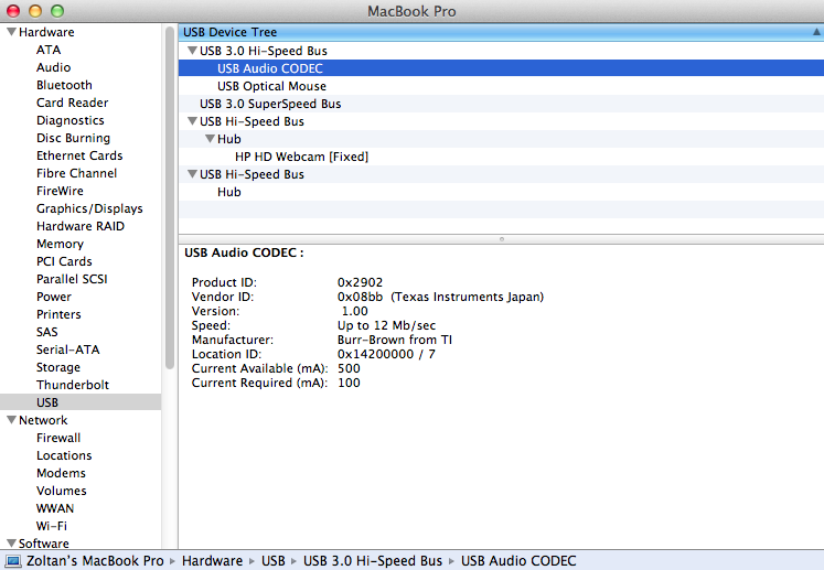

leslieking Posted April 4, 2013 Share Posted April 4, 2013 I have two USB sound adapters (Behringer UCA 202 and C-Media). Both sound adapters are recognized, but neither work when plugged into USB3 ports (no sound output). I'm using GenericUSBXHCI v1.1.4 and OS X 10.8.3. The sound adapters work in USB2 ports. Link to comment https://www.insanelymac.com/forum/topic/286860-genericusbxhci-usb-30-driver-for-os-x-with-source/page/3/#findComment-1903649 Share on other sites More sharing options...
